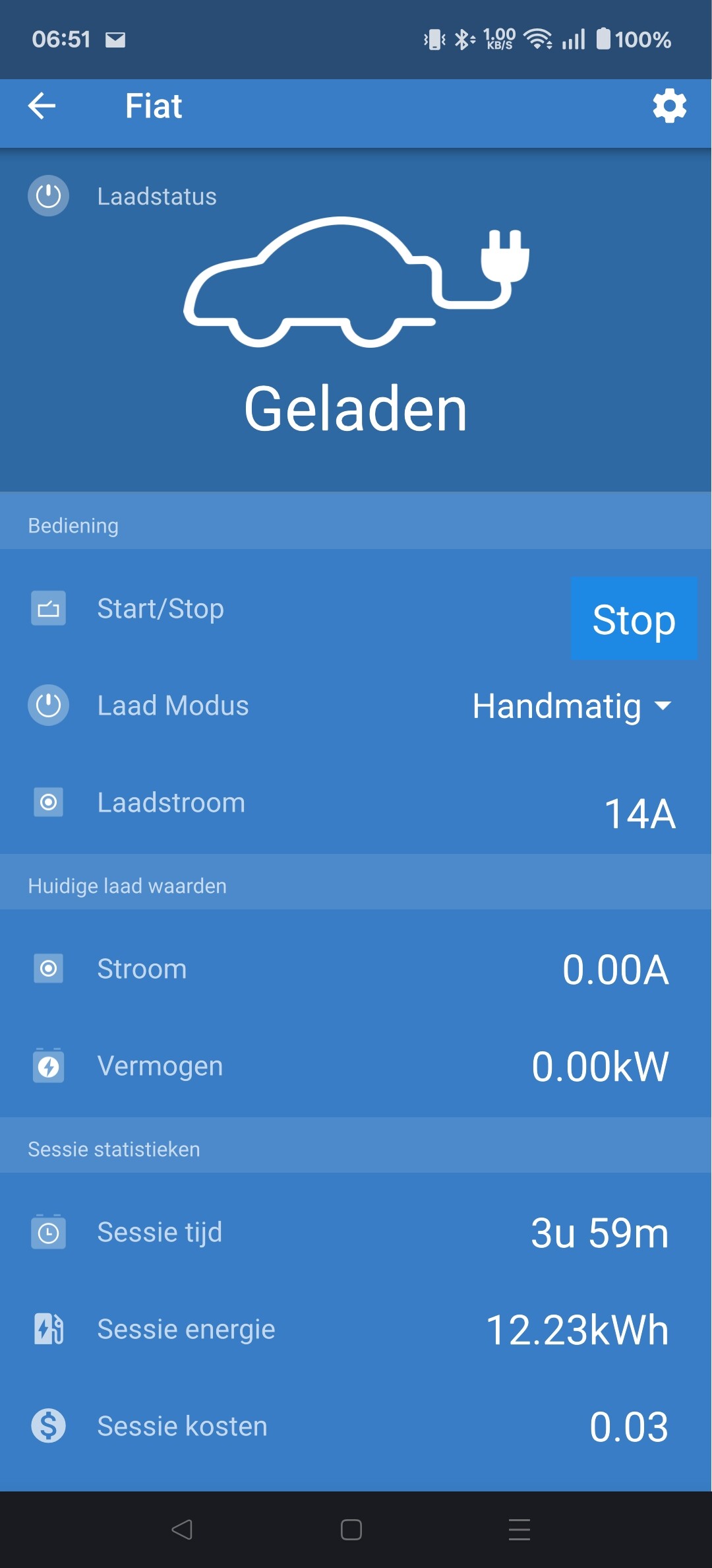

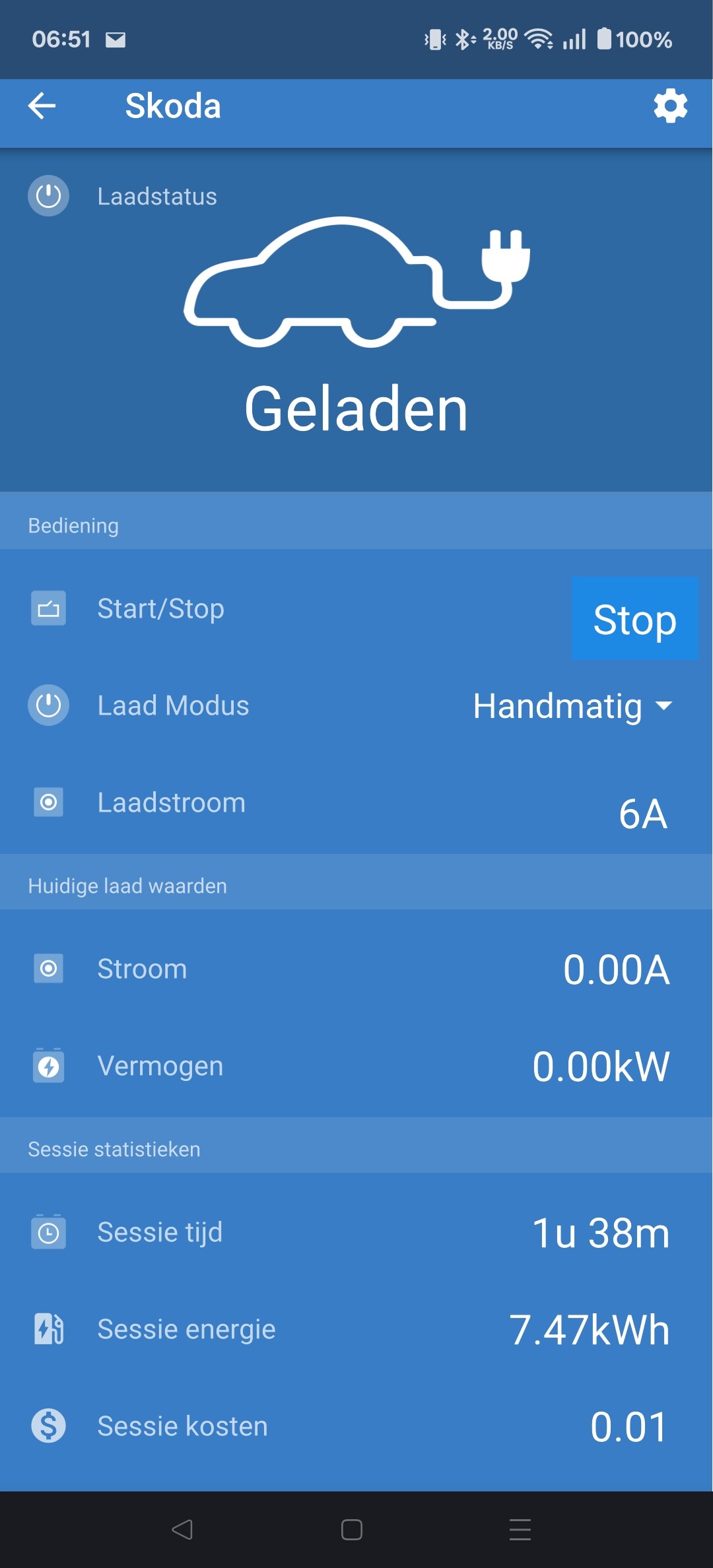

I have the same problem.
Do you have fix it?
VRM show a different energy use.
