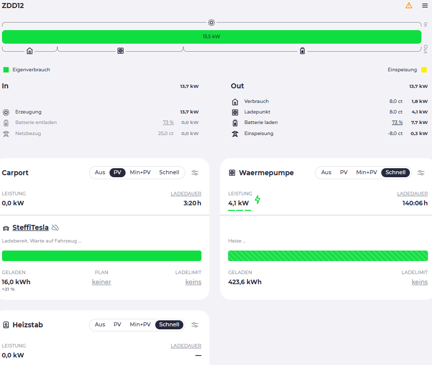

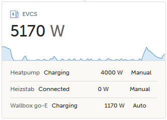

Venus OS will not support sofisticated control of several EV Charging Stations.
You probably want to use something like EVCC.io - you can control everything you want with it and it can be fully integrated into the victron world using an external plugin: GitHub - SamuelBrucksch/dbus-evcc: Integrate EVCC connected charger into Victron Ecosystem

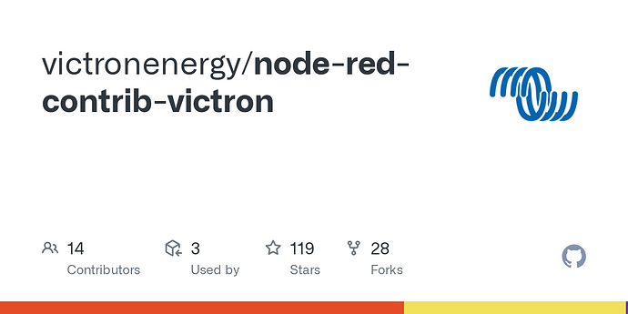

I just found that there is a solution using nodered in large firmware:
Here you can control the charge current using simple flows checking the grid meter current (for protecting grid main fuse) or “binary in” for §14a signal.
