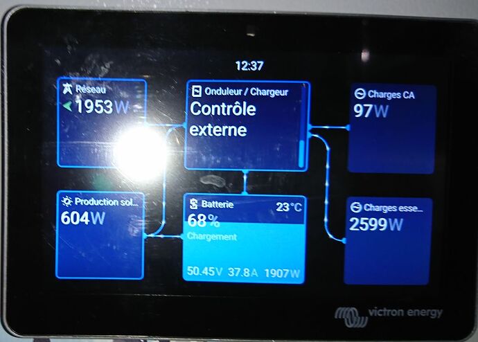

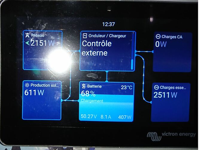

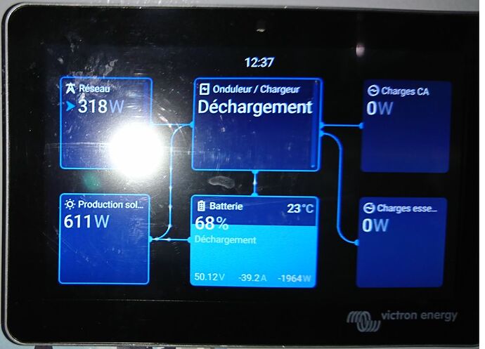

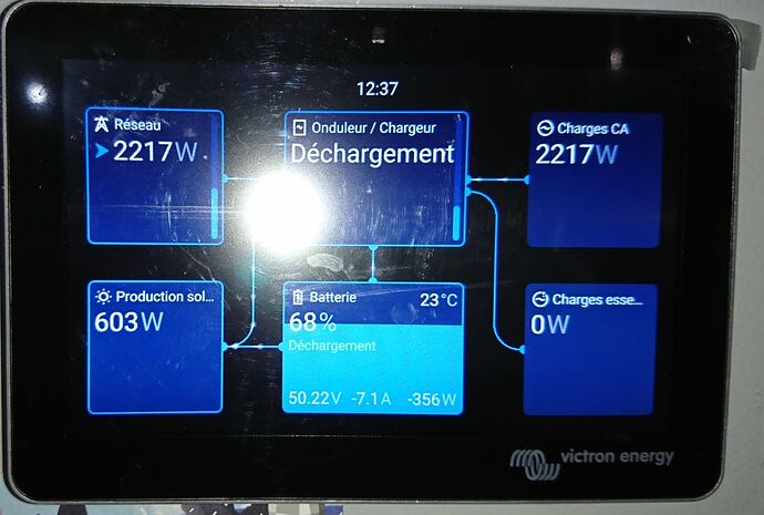

A 2,000W consumption was detected on ACIN, then on the AC loads, and then on the essential loads, even though nothing unusual was running (just two fridges).
When I switch off the fuse supplying the Multiplus’s ACIN input, everything works normally.
In the Cerbo’s system menu, I am offered the option to revert to version 3.70; the problem is the same. I don’t know what the previous version was, but I don’t remember accepting an update.
