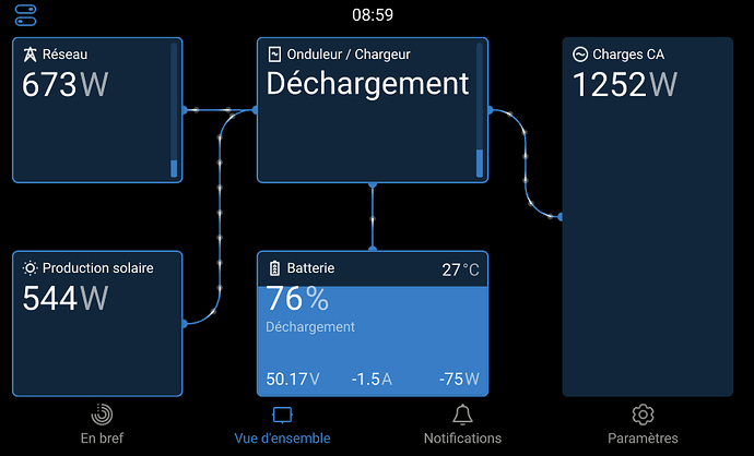

Example of low utilisation of the SOC :
I found out my error.
I was playing with the MPII modbus register for automation weeks before the real installation. I made mistakes on register 2701 and 2702 set at 1 instead of 100. Don’t know why
