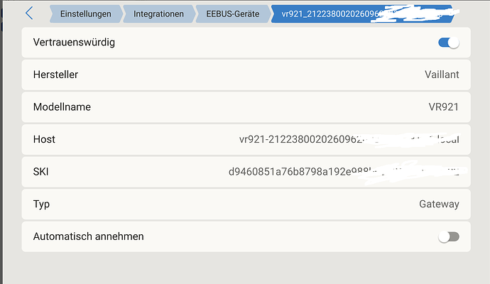

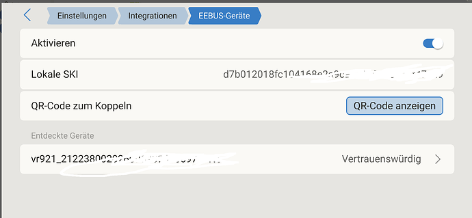

I’m currently testing the new EEBUS integration with a Vaillant air-to-water heat pump. The devices are communicating with each other via EEBUS.

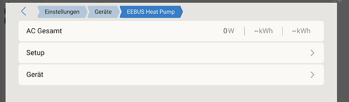

Unfortunately, I can’t see any data in the V2 Remote Console yet:

In terms of the data available, we do support energy counters, but I believe in your case the heat pump is not reporting that data.
At the moment it seems like your heat pump is only reporting power consumption, but not the energy consumed counter.
When your heat pump is running, have you seen power readings above 0W?
Let me know if you still believe that something is wrong and we can dig deeper into your installation.

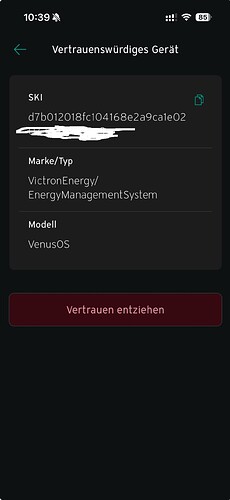

Hi Nils,
I’m getting the LWP to heat some water now. It’s currently drawing 2 kW. I can’t see anything in the EEBUS Heat Pump device, the Remote Console, or DBUS.
It seems to me that both devices recognise each other as trusted, but no data is coming from Vaillant.
Christian
Ok, let’s investigate further then. I’ve sent you a private message.
I’ll post back the result on the thread once the issue has been identified.

Regarding the original topic.
The issue has been identified, some older Vaillant heat pumps do not report their power consumption in the expected way.
We will add support for those older models in a future release.
However, be aware that those older models won’t support all the features (e.g power limiting).
I’ll update the thread once it is available.
Hi Nils, I tested this on a Cerbo GX running Venus OS 3.85 with a Vaillant aroTHERM split (VWL 125/5 AS outdoor unit, VWL 127/5 IS indoor unit), a multiMATIC VRC 700 controller and a VR 920 gateway running firmware 357.40.40.
I can confirm that the GX receives live compressor power over EEBUS. During a normal heating cycle, heatpump/99/Compressor/Ac/Power went from 35 W to 73 W, then to 1,845 W. I confirmed on the Vaillant side that the compressor was running. The GX reported 1,845 W in six consecutive readings over 42 seconds.
The Vaillant device page in Remote Console shows 0 W under AC Totals. In the GX diagnostics, /Ac/Power shows --. The EEBUS use case listed for this device is /HeatPumpAppliance_3/Compressor_1/MA_MPC. In VRM Advanced, the custom widget device selector does not list this heat pump, and I couldn’t find a measured compressor power parameter under System.
Is there a supported way to display /Compressor/Ac/Power on the existing Vaillant device page and graph it in VRM Advanced? If this needs a change, a separate Compressor power (W) reading would be ideal. That label would make clear exactly what the gateway measures. I’m happy to test it on this setup.

No, but the fix will make the reported compressor power as if it was the overall heat pump power.
At this point the compressor power is not planned to be displayed.
It is for an upcoming feature to make use of the compressor flexibility with Opportunity Loads.
