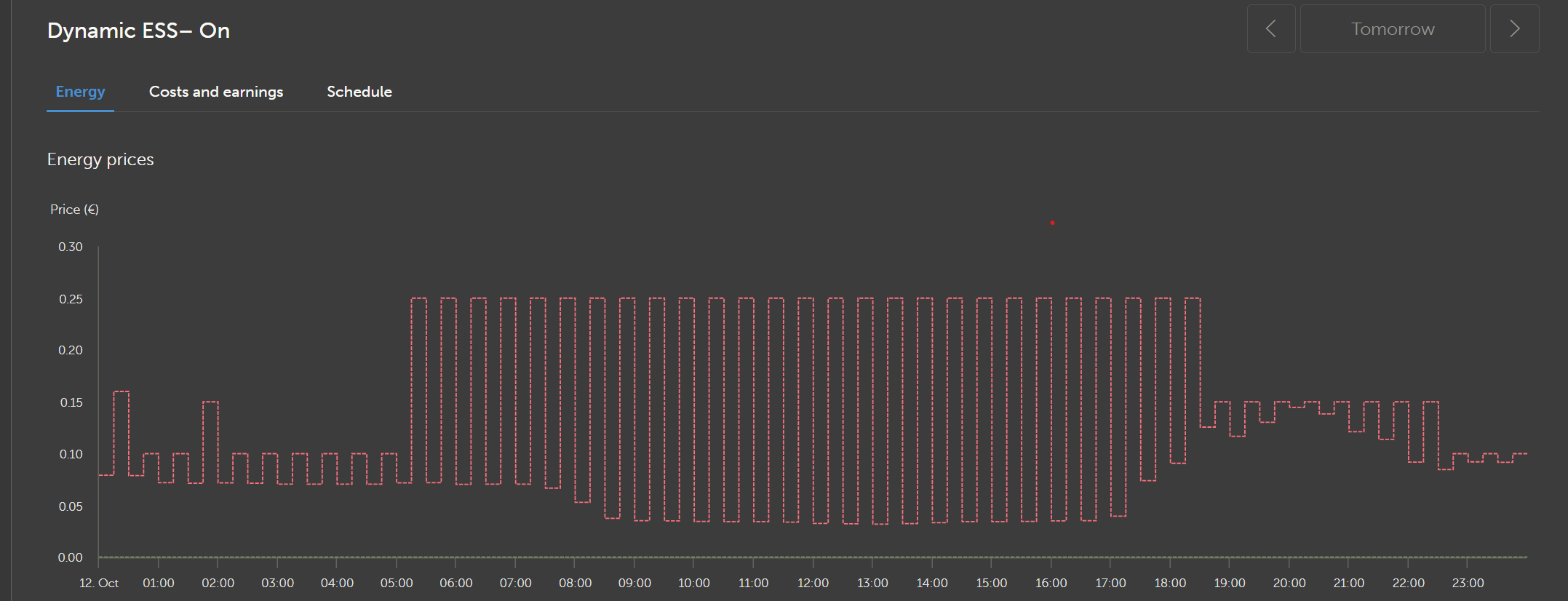

I’ve noticed that the dynamic pricing feature isn’t working consistently. In some 15-minute intervals it works correctly, but in others it doesn’t seem to apply the correct prices or respond as expected.
Has anyone else experienced this issue? Is there something I might need to check in the configuration, or could this be a known bug?

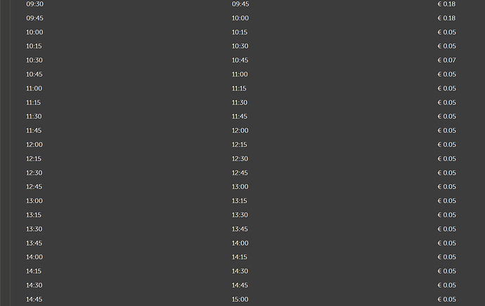

Check image bellow for tomorrow prices(price should be always near zero from 10:00 to 15:30, Portugal/Spain dynamic prices):
If i try to put fixed prices for all the 15 minutes intervals, the problem remains.
Is it possible to clear vrm dess server cache? it seems like it is mixing last week prices with this week ones
