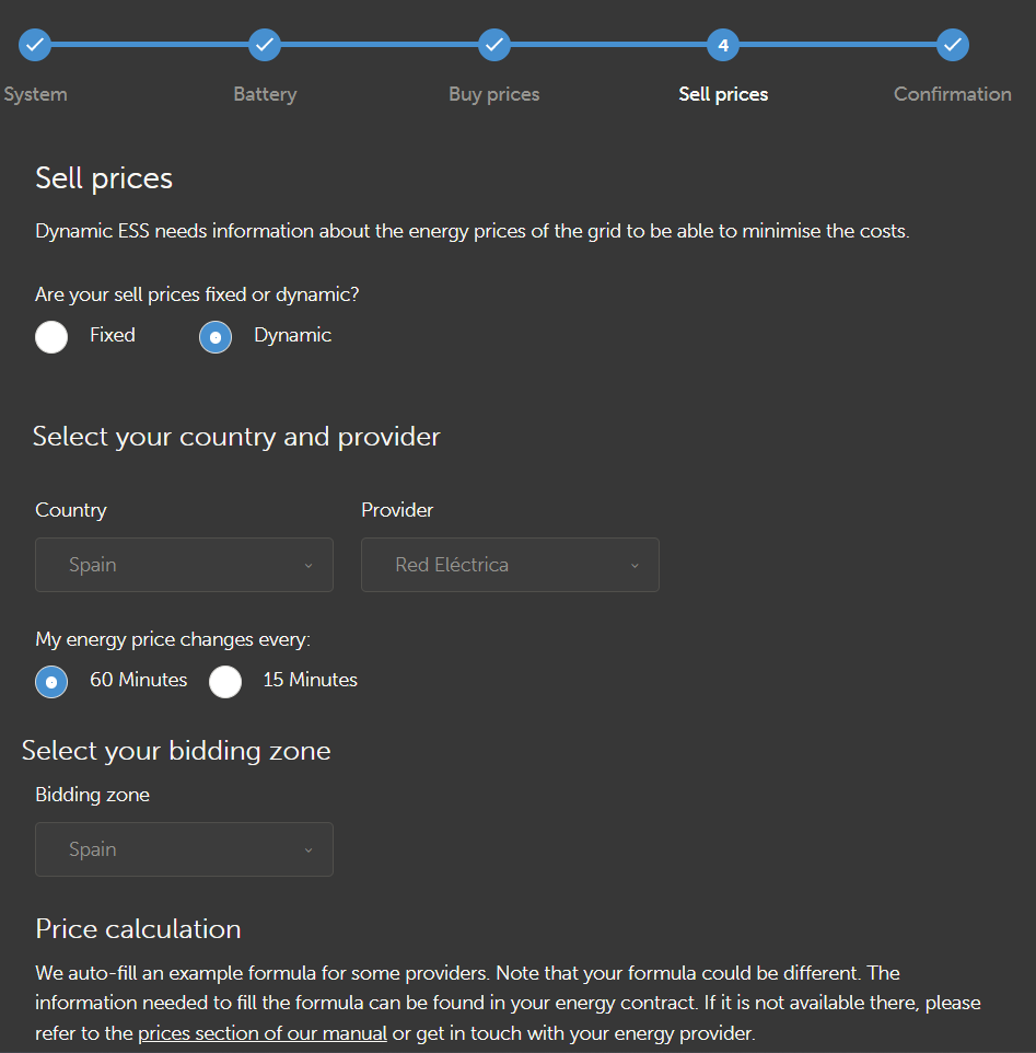

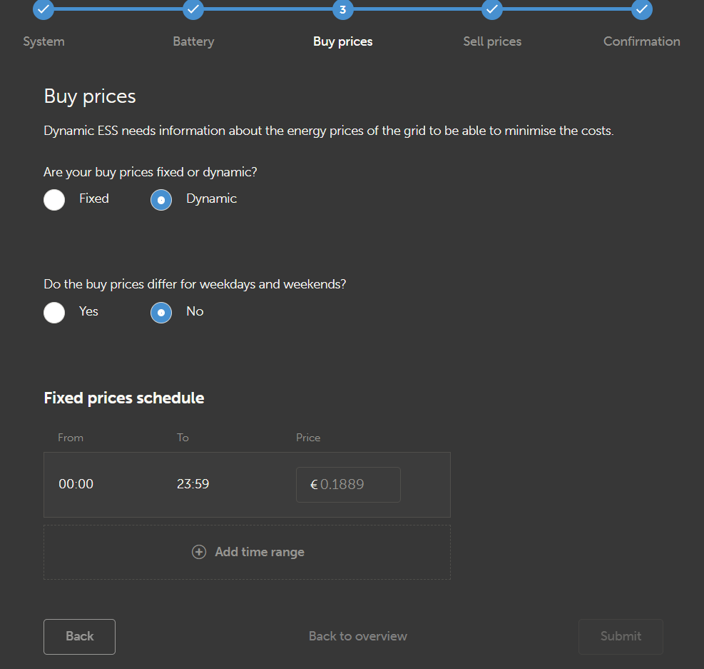

When I try to switch to dynamic buy prices on DESS from fixed prices, nothing happens:
but in the sell section, it works ok (asks me for the Country)
What can I do?, I haved tried on v3.64 and 3.7-26 firmware versions

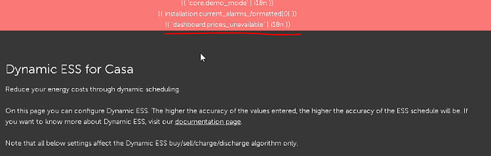

If I refresh the web page, a red message appears at the top that quickly disappears. If I record a video, I can see the message: dashboard.prices _unavailable:
This messages does not appear when I hit refresh on the sell prices section.
Can someone from Victron help me please?
There is something wrong with DESS and Spain prices Video
