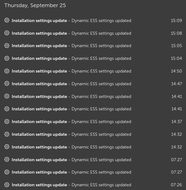

The log file shows
Any idea what I am doing wrong here?
