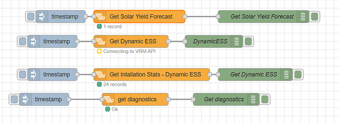

My situation did not change much (I am on Venus 3.70~54), at least I can see the “Dynamic ESS” form
which I can fill with values but I am not able to “submit“
I’ve also tried “VRM API”
some of the nodes are ok, but “Get Dynamic ESS configuration“ stacks on “Conneting to VRM API“
msg: {“url”:“https://vrmapi.victronenergy.com/v2/installations/XXXX/dynamic-ess-settings",“method”:“get”,"status”:500}
What is wrong with my configuration?
