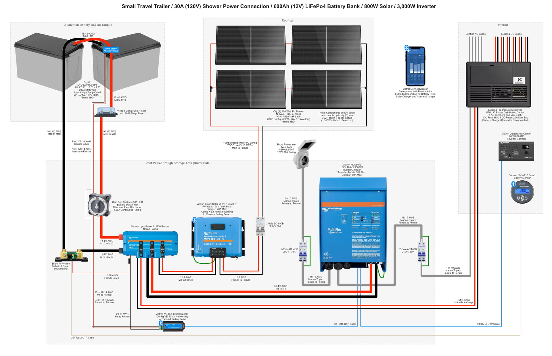

Attached is a preliminary attempt at a complete system design, which will hopefully answer any questions about my intended application.

Looking at your drawing, if you purchased a Cerbo GX and Touch 50 you would get the advantages of that device and you would not need the Smart Dongle, the Digital Multi Control and you could swap the BMV712 for a cheaper SmartShunt. The savings from not having those would go someway towards offsetting the cost of the Cerbo GX.
