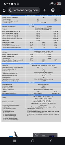

I’m looking at the multiplus II or the multiplus II GX but can’t really see what the advantage of the GX would be as neither seems to work on victron connect without adapter anyway?

Yeah you’d need to get the bluetooth adaptor to be able to see it on the victron connect.
Or get a cerbo and connect via rj45.

So what is the advantage of the GX version? Just that it gives some data on a screen?
No the GX version has an integrated gx device. So you can hard wire directly to other units. But if you want to connect via bluetooth i think you need the dongle still.
But maybe the GX would work for your set up?
Thanks.
I think the GX would work with the ve.drect usb cable for one mppt and a ve.direct cable for the other.
I guess I’m just not sure if the hard wiring is useful enough to warrant the extra money.
