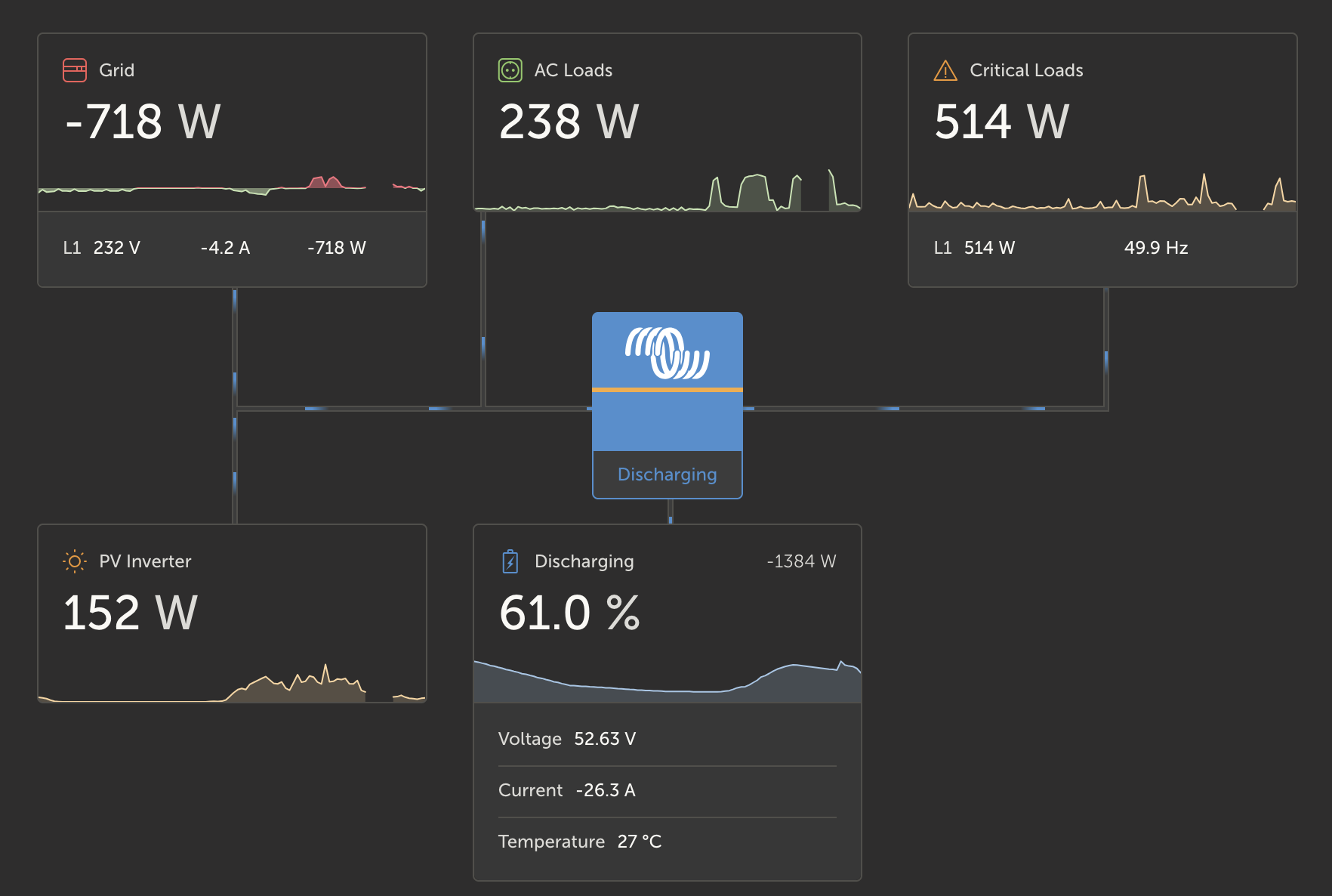

I have a victron Multiplus 48/5000 which charges fine at max capacity but when it comes to discharging will not go above 1500w. I have played with ALL the settings and tried out 3 different BMS (all JK) wich makes me pretty confident that it has something to do with my invertor settings, but I can’t figure out what it is. The CCL and DCL are set by the BMS but ignored by the invertor. When I change the max CCL from 200 to 100amps the output drops from 28amps to 14 amps.
Who can help me out with this?

Why are you exporting 718Watt with only 152Watt from solar? That looks like a grid setpoint issue.

This was during the early evening, but the problem is that my DESS/ESS/0-meter does not discharge more than 1500W under any condition.
