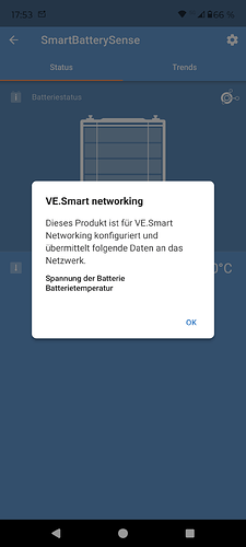

I have a VE.Smart Network consisting of Smart Battery Sense, Smart Solar Mppt, and Orion XS.
All devices are displayed correctly via Victron Connect Local, and the VE.Smart Networking icon also appears.

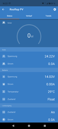

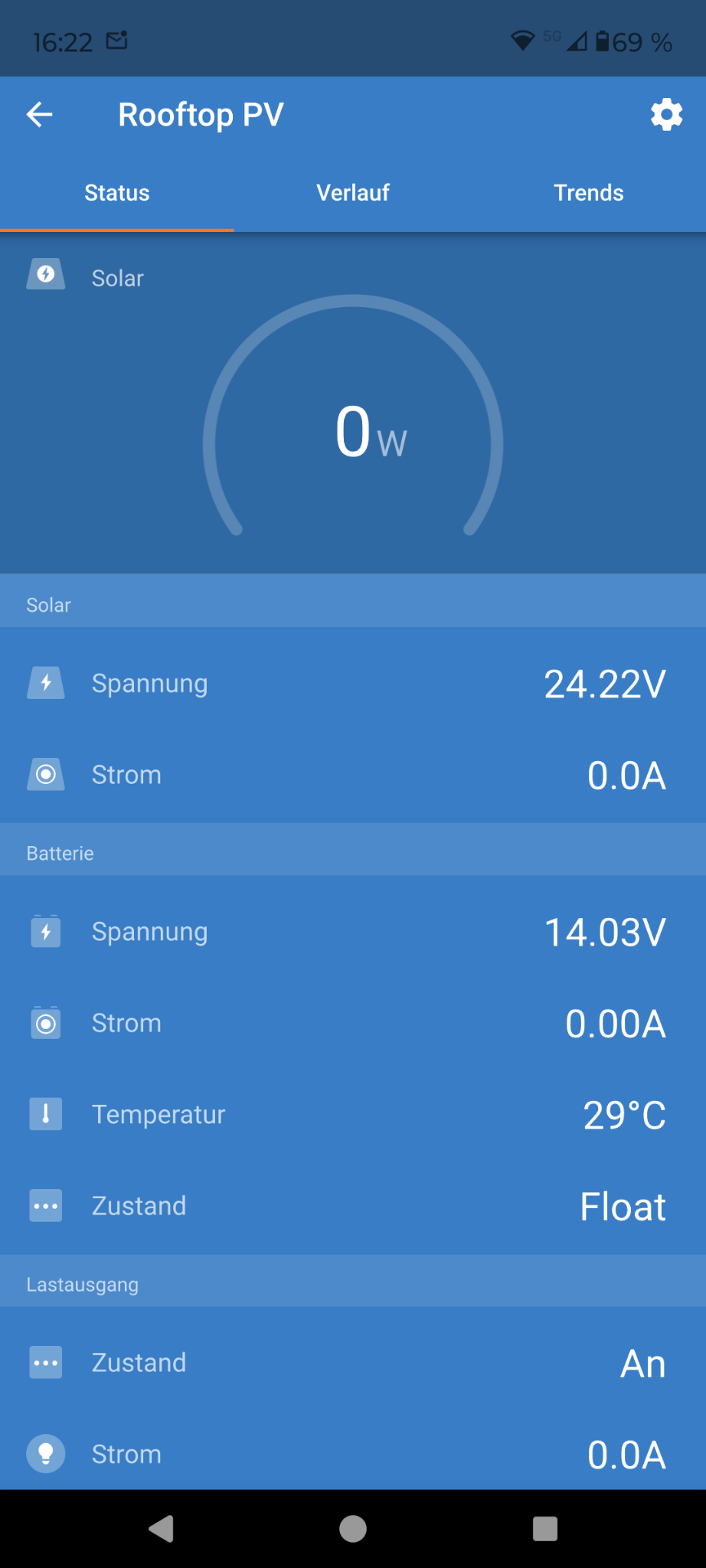

When I go via Victron Connect VRM via GX device, there is no VE Smart Networking icon for the Smart Solar MPPT.

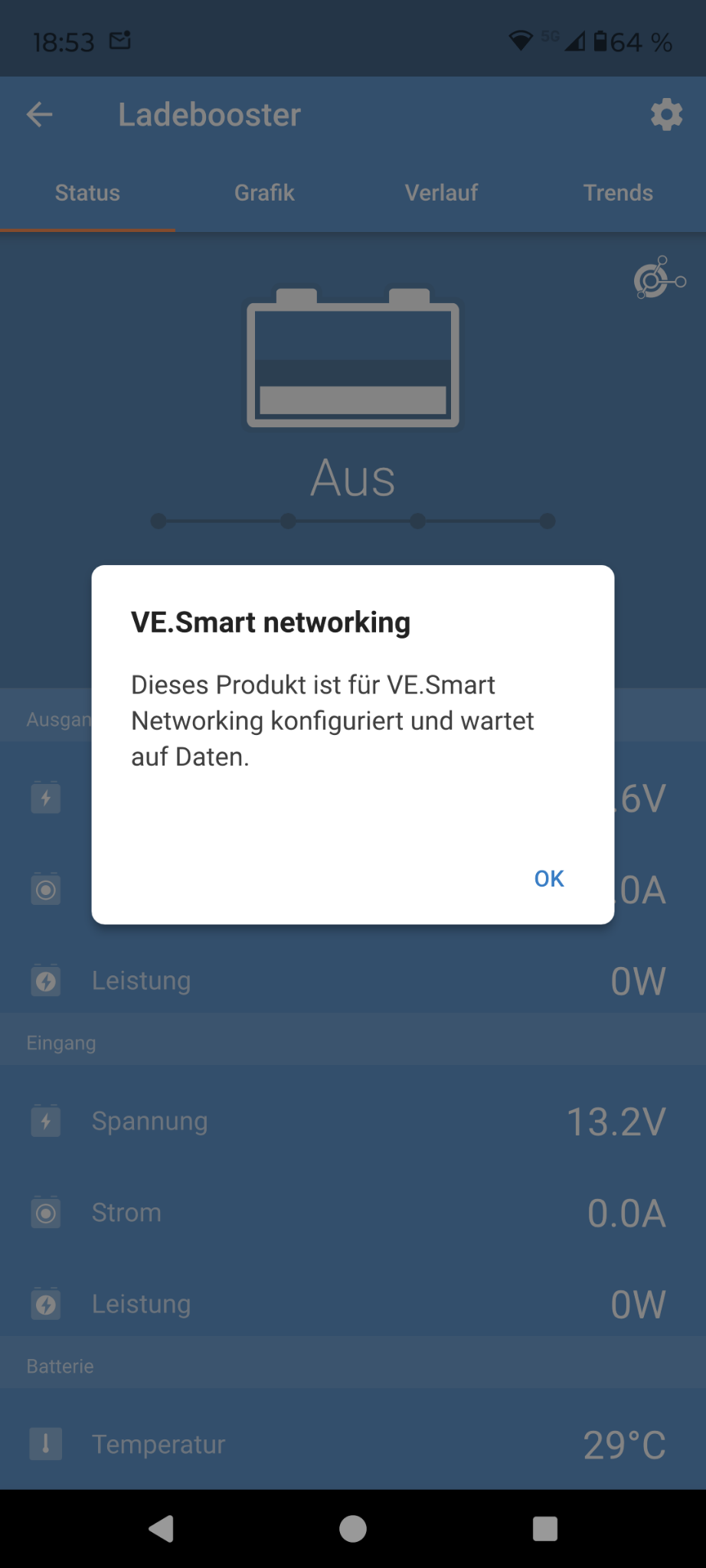

For the Orion XS, the VE.Smart Networking icon is displayed, but it does not show that data is being received.
