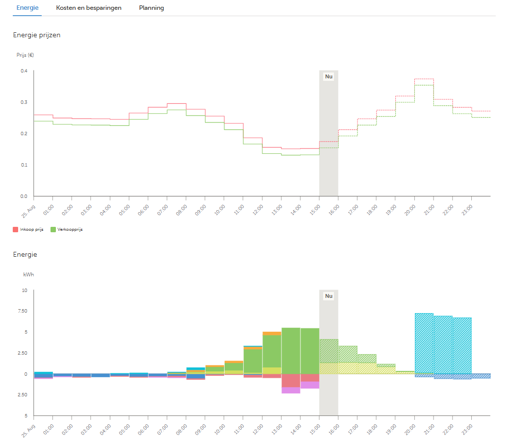

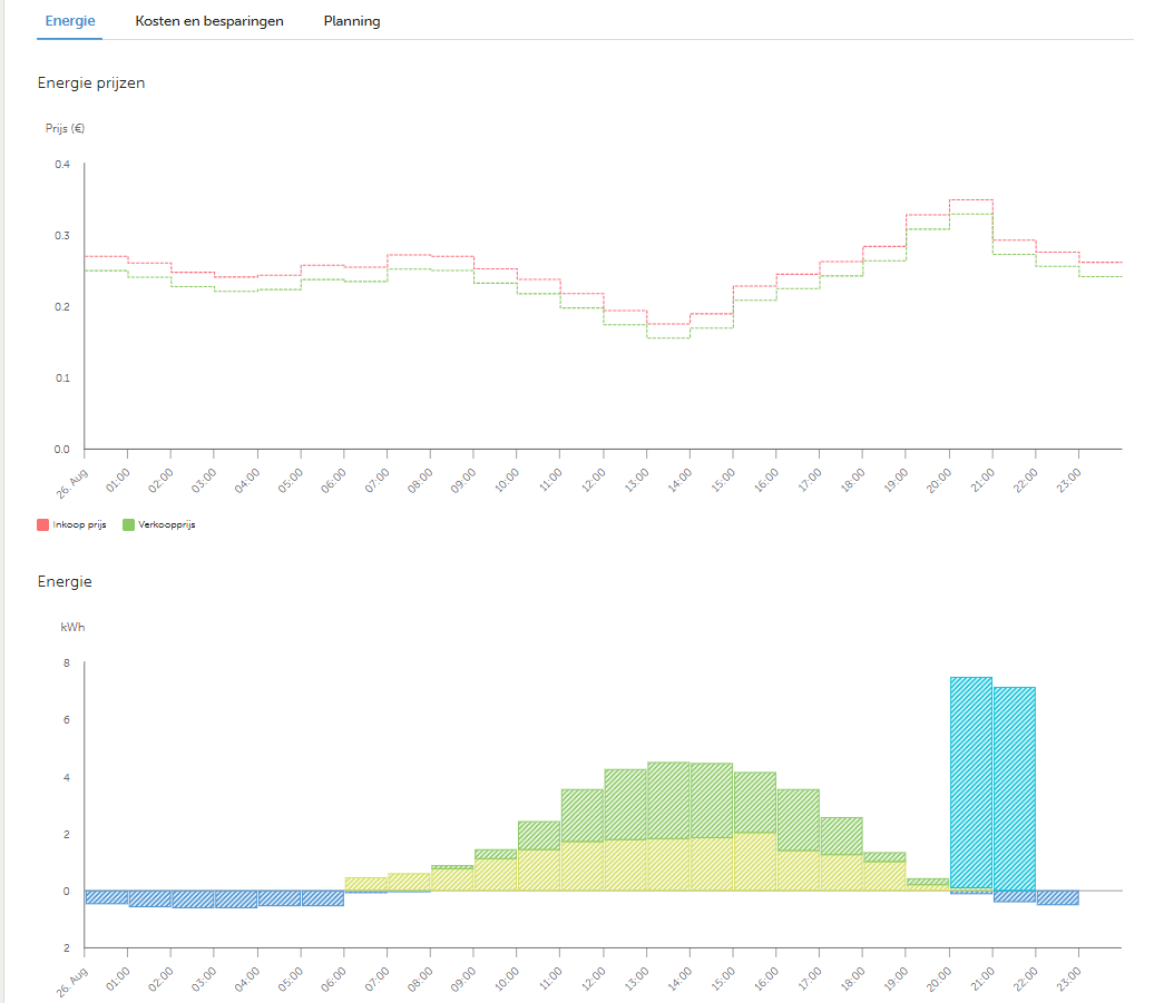

As can be seen in the images below.
The system starts the return of the stored solar energy just after the peak.
So the system actually starts an hour too late.
The peak is often around 8 p.m. Then the system starts the return at 9 p.m.
And I find that very strange. I won’t get poor from it… But it’s not a tip top earning model either.
This has been more the rule than the exception since the beginning of April (I switched to a different energy contract). Sometimes it goes well. But usually the system is just an hour too late.

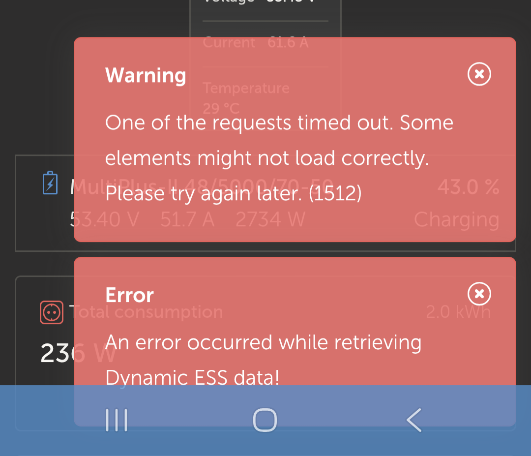

The vrm currently has major issues also displaying dess data today and last days unfortunately. Maybe this also interferes with the scheduling.

Well, I noticed that too.
Various information wasn’t loading correctly.
And the website was very slow.
But the problem this post is about… Unfortunately, it’s been around for a while.

Just today, DESS is doing some crazy things. I think it’s not getting any data anymore either just like de VRM portal.
Okay, a few months ago, I tried resetting the data. I don’t think it helped then.
But maybe I can try again. I’ll wait until the VRM is working properly again. The VRM is completely dead right now.
I just manually took over DESS. Whatever, that’s not working properly today. But that’s definitely related to the VRM issues…

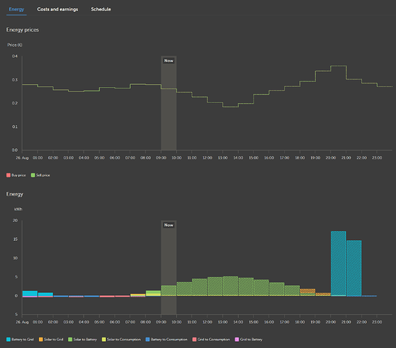

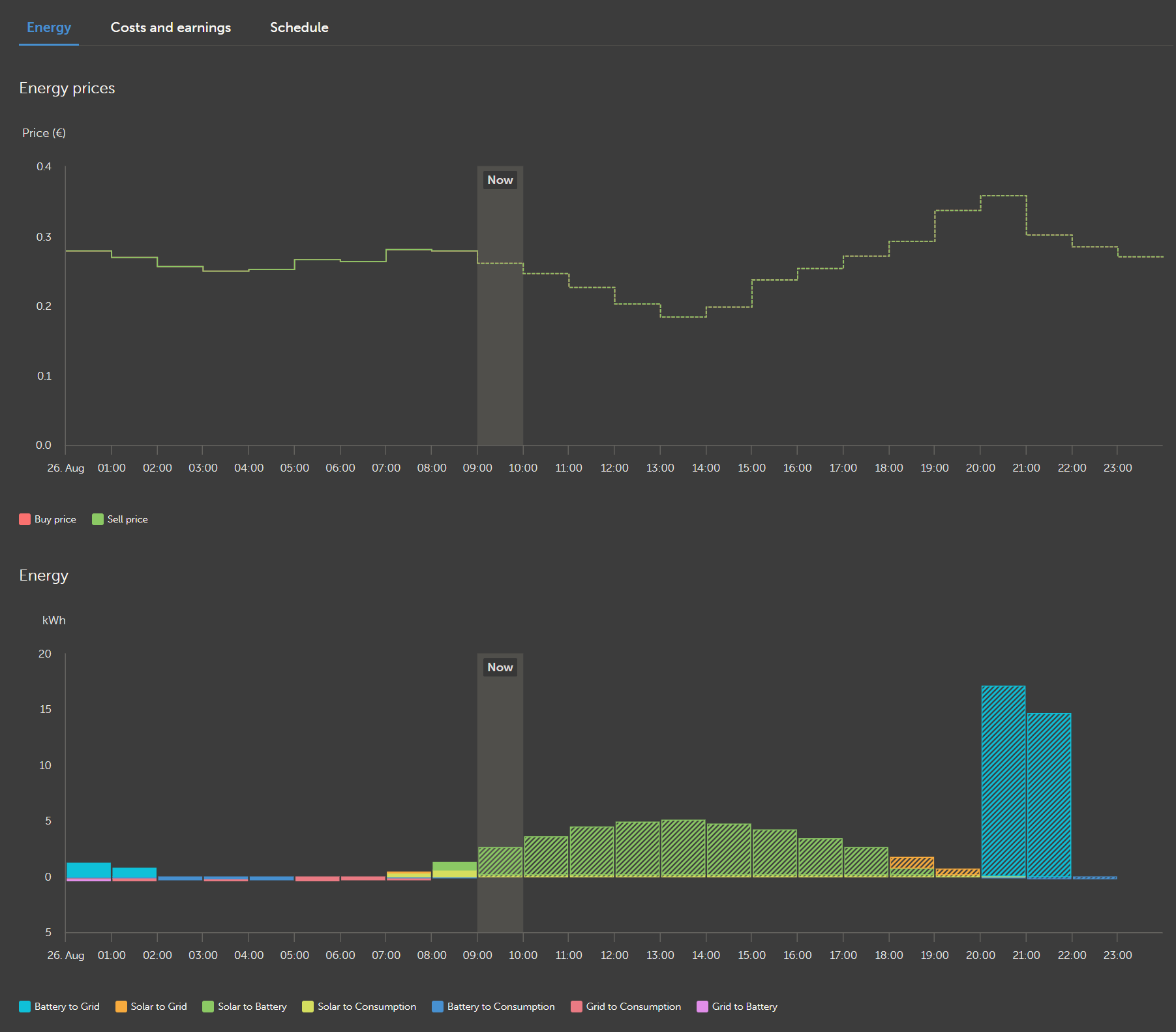

The way I see it, green mode DESS only discharges in hours with no expected PV generation. And this makes sense to me.
Rationale: it only sells the excess and you cannot figure out the excess before the solar charging of the day is done.
I admit that solar charging ending at maybe 20:05 and only selling back at 21:00 feels stupid, but logically it makes sense. The switch to 15min prices will make this behave better.

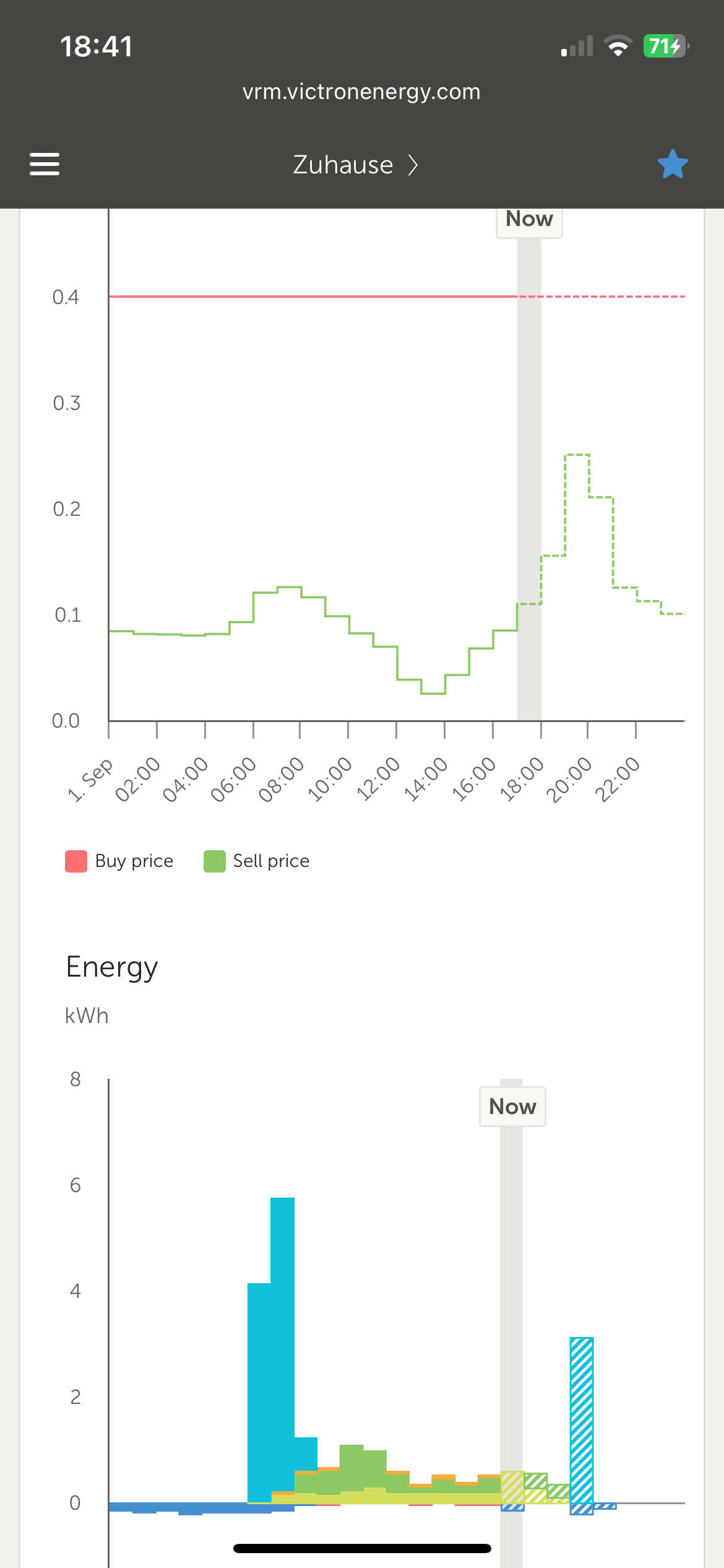

Looks to me that the 1 hour difference issue is back.
If I look at the 2 days of forecase for selling to the grid, it starts exactly 1 hour after you would expect it starts to sell.
In the 2nd image more obvious than the first, it sells at 20-22h, whereas based on the price it should sell from 19-21h. (the price from 19-20=30.74ct, but it sells from 21-22 at 29.21ct)
I am having the same. However at least it starts at the peak price and adds an hour, before it seemed to start an hour after peak (at least at my site).

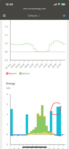

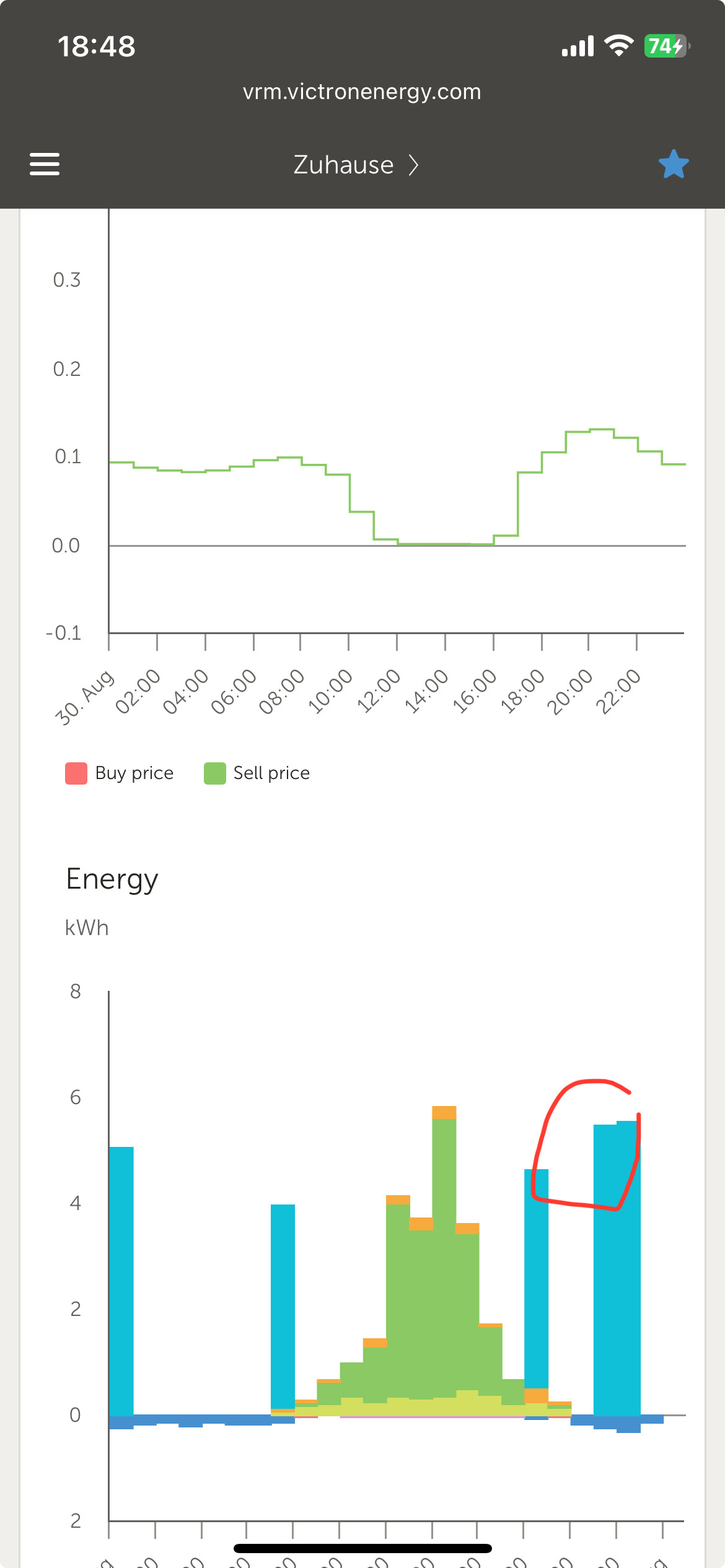

Same 1 hour shift here.
portal: c0619ab4b370
  • Sell price: p
  • Buy price: constant 0,40 EUR/kWh
  • Local time and region: Germany
Pls see screenshot from today (01.09.2025)
even more strange are “gaps” while exporting on high sell price. See screenshot from 30.08.2025
