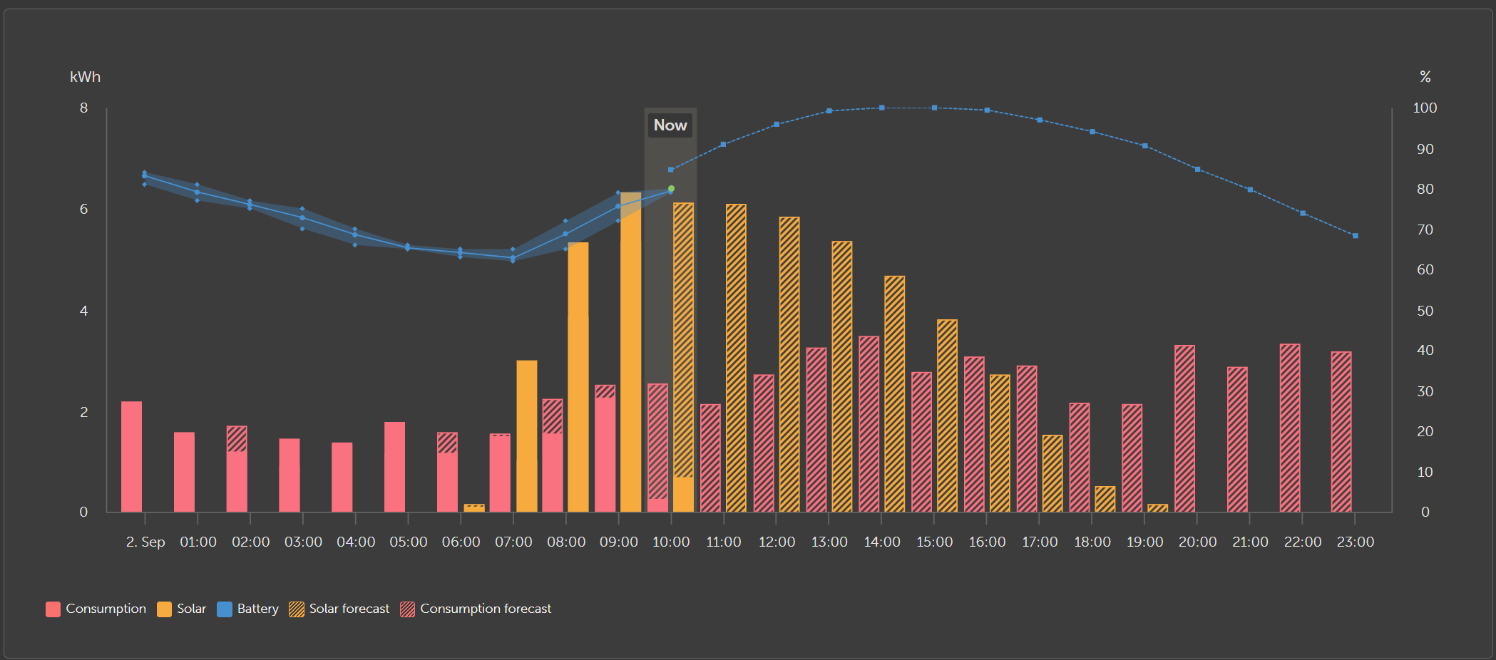

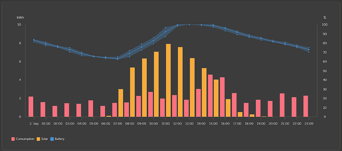

Hi all - we have DESS configured in Green Mode, under a simple peak / off-peak tariff scheme. We noticed DESS usually tries to target 100% SOC by mid-day, which we believe is the correct behavior.
However, VRM sometimes schedules “too much” self-consumption into the off-peak hours, such that 100% SOC is not reached the the following day. Please see some charts below and notice the “tomorrow” chart not reaching 100% SOC.
Is this expected behavior?

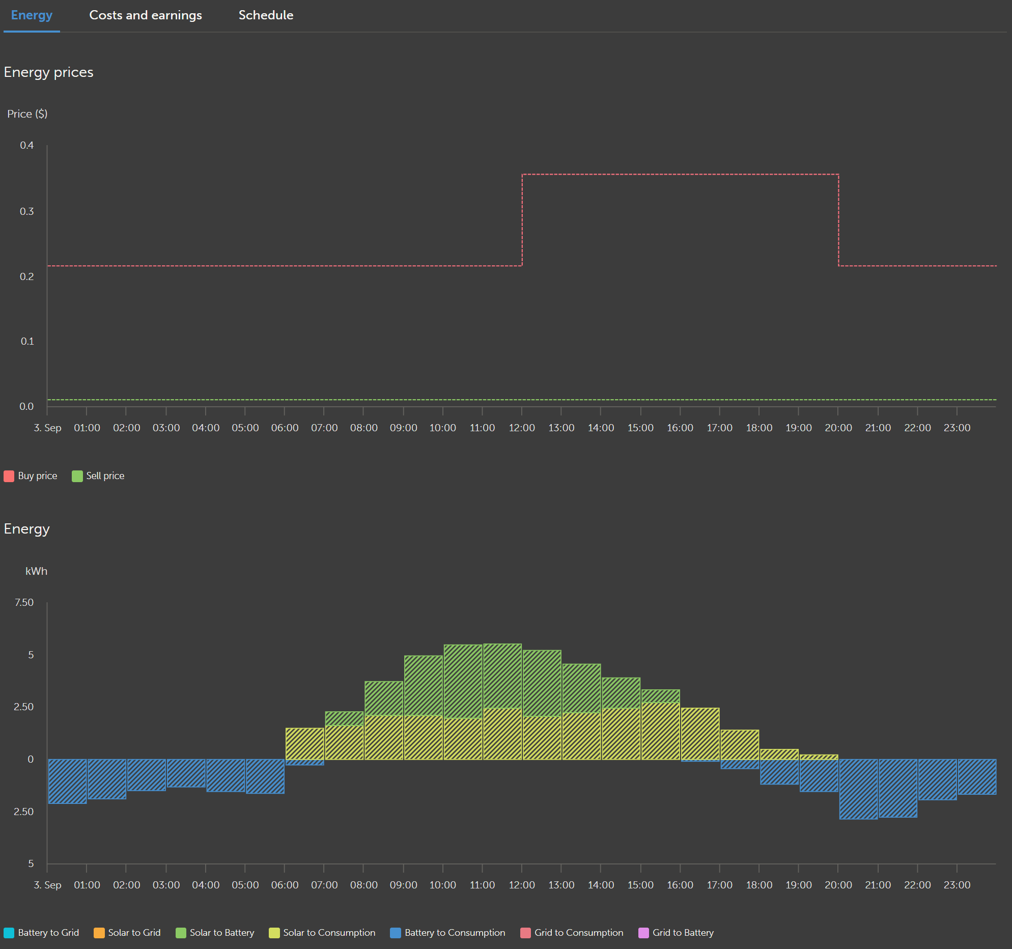

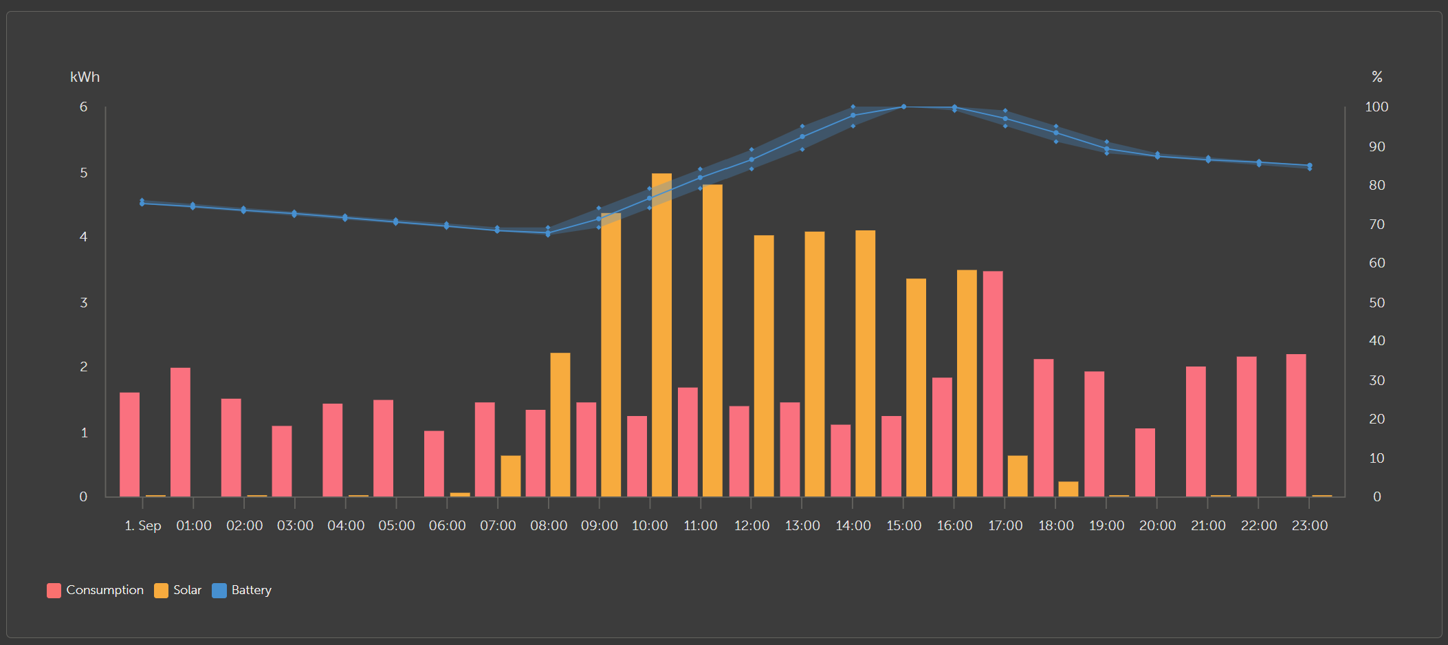

Yesterday (100% SOC reached):

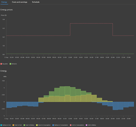

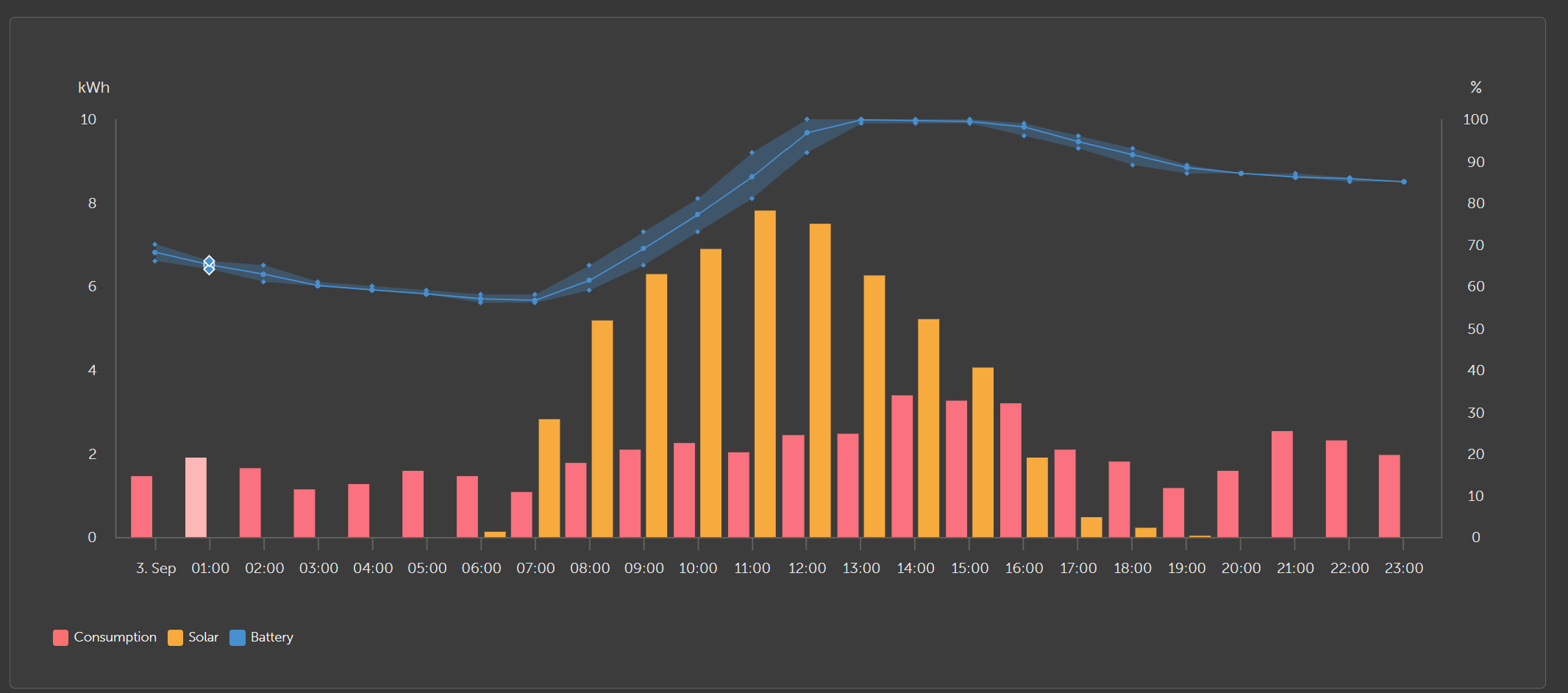

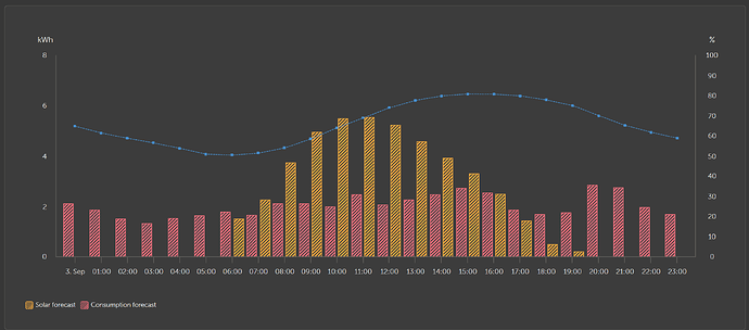

Today (100% SOC planned)

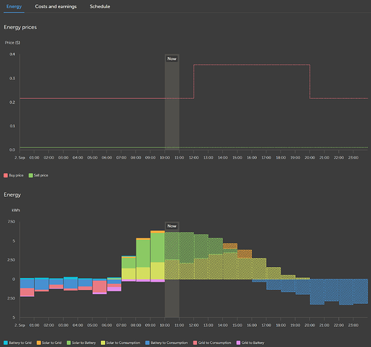

Tomorrow (81% SOC planned)
Well, if there isn’t enough solar to reach 100% (and buying from grid is not worth it / not required) what else should it do? Enforcing a 100% SoC tomorrow would then require some battery idling during the night, which causes guaranteed grid-pull. And then, there is a “risk” that there is more solar or less consumption than expected, and you unnecessarily bought from grid during night.
Basically, with your prices the reasoning is quite simple:
Your system needs enough SoC to cover 12 to 20 consumption - anything else doesn’t matter as the grid price is the same.
And the schedule for tomorrow expects 70% at 20, so there is no need to save/buy additional energy for the 12 to 20 hours.
Thanks for the reply here @dognose That all makes sense, though I’m a bit confused why that behavior isn’t consistent across all days.
For example, we’ve had sunny weather for the past week or so, and the system has regularly decided to buy from grid starting at 20:00 (rather than self-consuming into the off-peak hours). Our current “min SOC” is set to 40%, and you can see the system remained above 60% SOC overnight the past 2 days. Last night, you can see there was intermittent grid-pull, but the night before you can see consistent grid-pull.
Though I guess it is possible the PV forecast could have changed, or the PV/consumption forecasts were slightly off. I am probably misunderstanding something… thanks for taking the time.

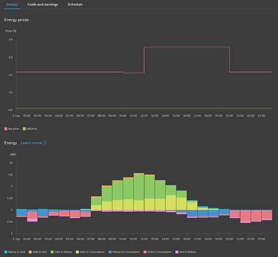

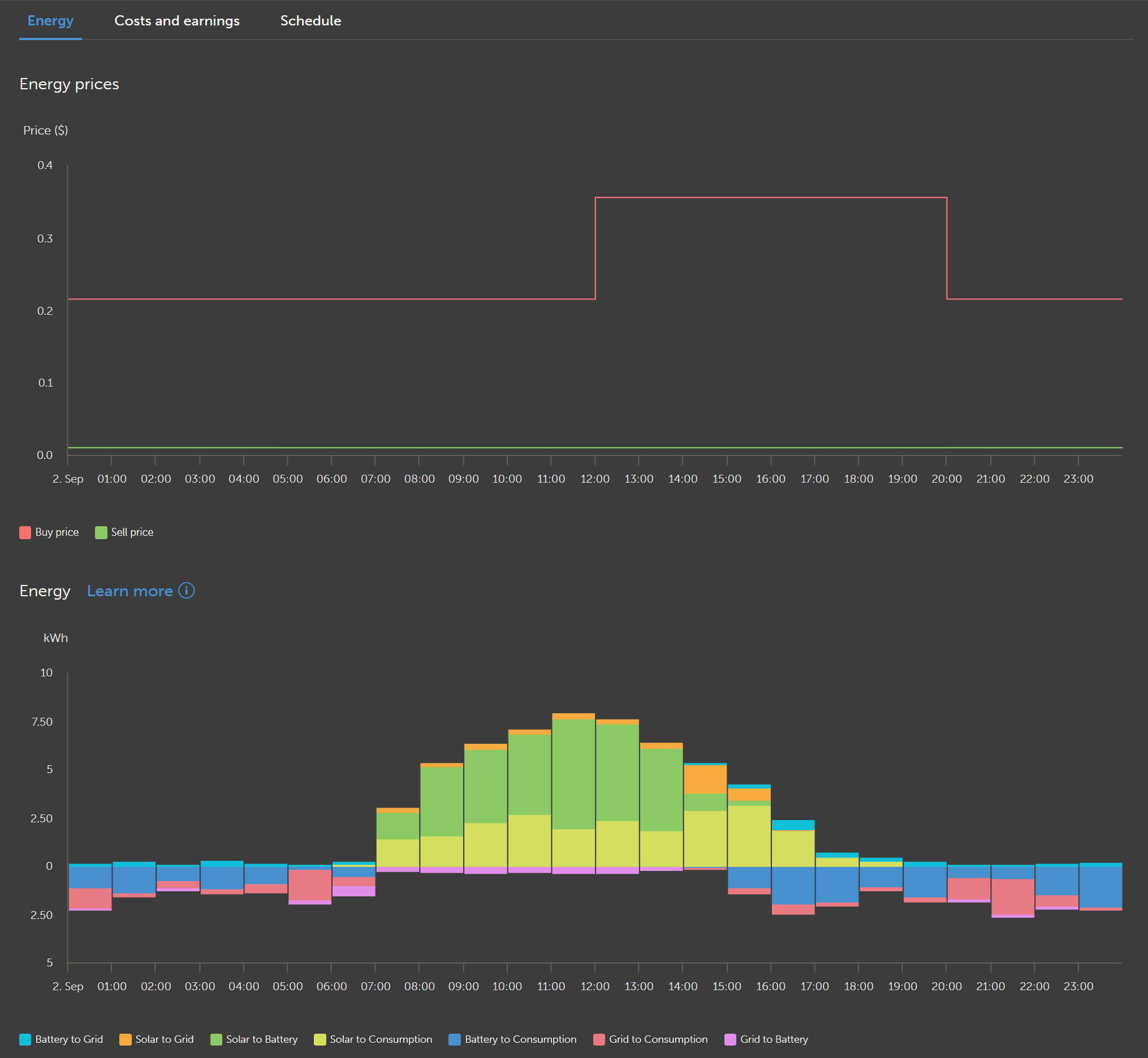

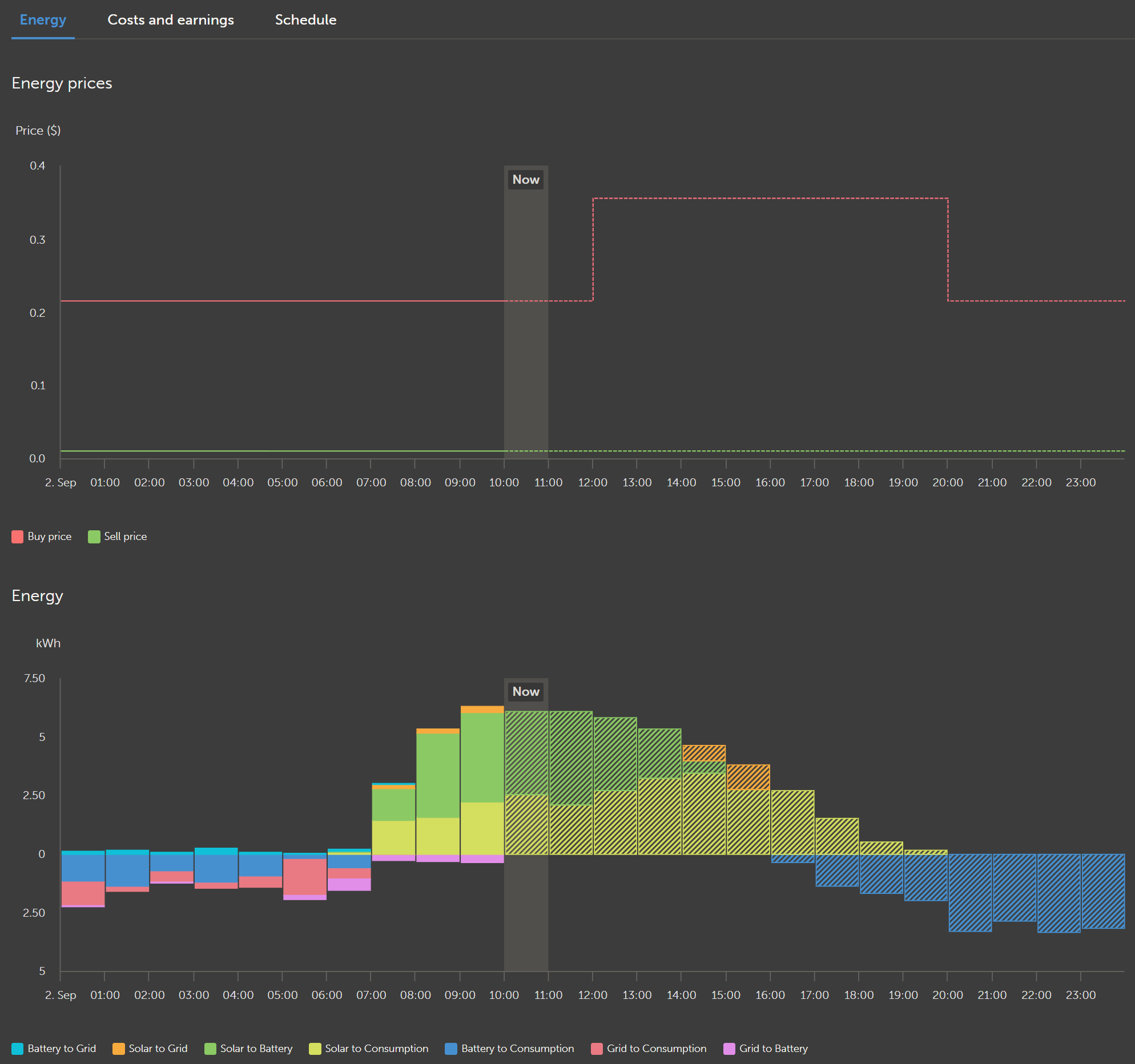

As a quick follow up here (2 days after my post above):
  1. DESS planned to self consume all day, including all off-peak hours (as seen above).
  2. This self consumption would cause the following day’s’ max SOC to reach 80-90% (not 100%)
  3. Once we got to evening off-peak hours, the system started oscillating between idling and self-consumption (changing the plan from self consumption).
  4. These oscillation seemed designed reduce self-consumption during off-peak, so 100% SOC could still be reached both of the following days.
Does this make sense? I like that Green Mode reached 100%, though not sure why the system “changes” the plan once we got into the off-peak hours.
The PV forecast didn’t really change much throughout the day. I also introduced the 0.005 discount before peak hours.

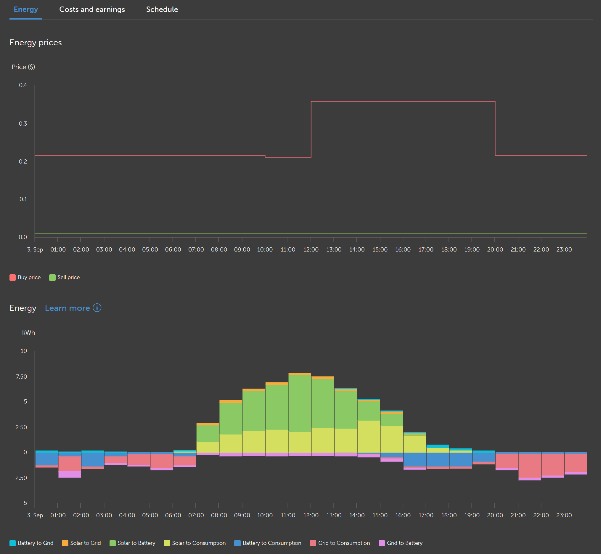

Day before yesterday (same day as original post). No idling was scheduled between 20:00-23:00 when I posted above, but we see the system changed the plan when we got to those hours.

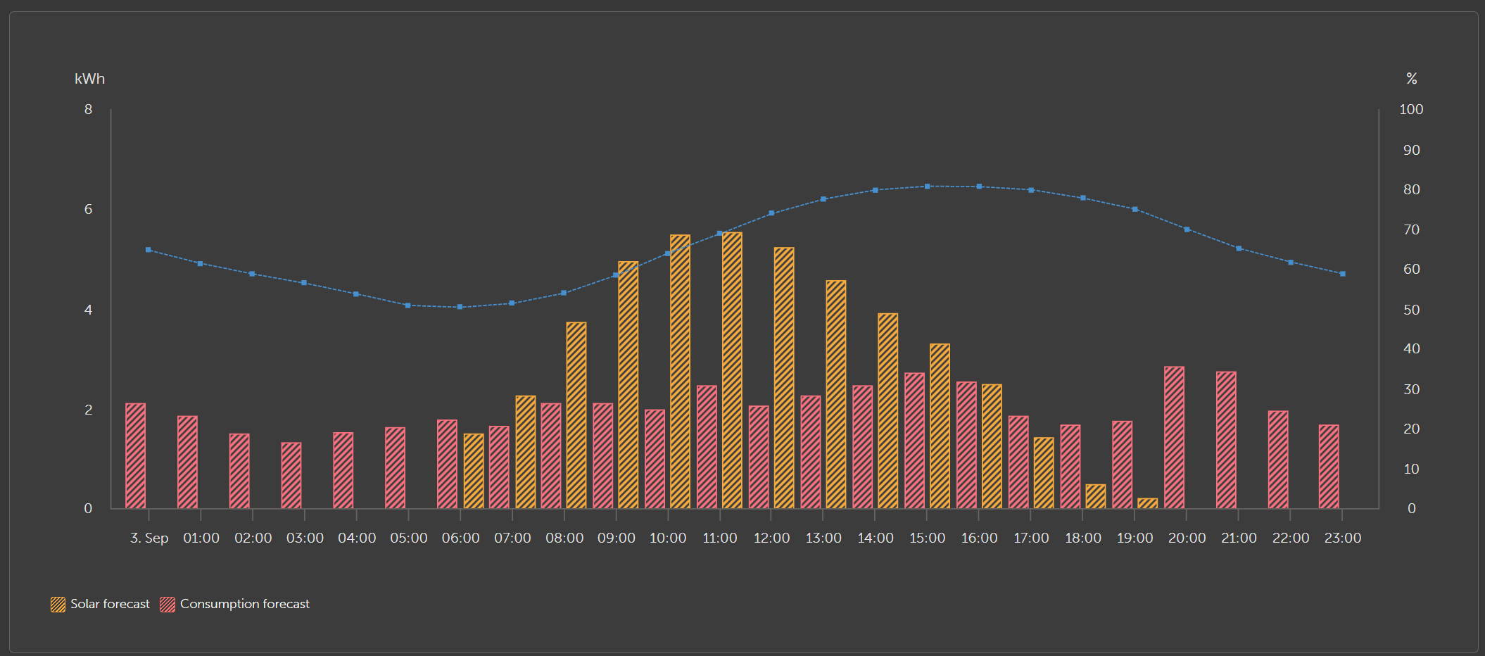

Yesterday The system was planning on fully self consuming all day, but we can see idling sporadically throughout the night. Eventually this resulted in the max planned SOC changing from 80-90%, up to 100%.

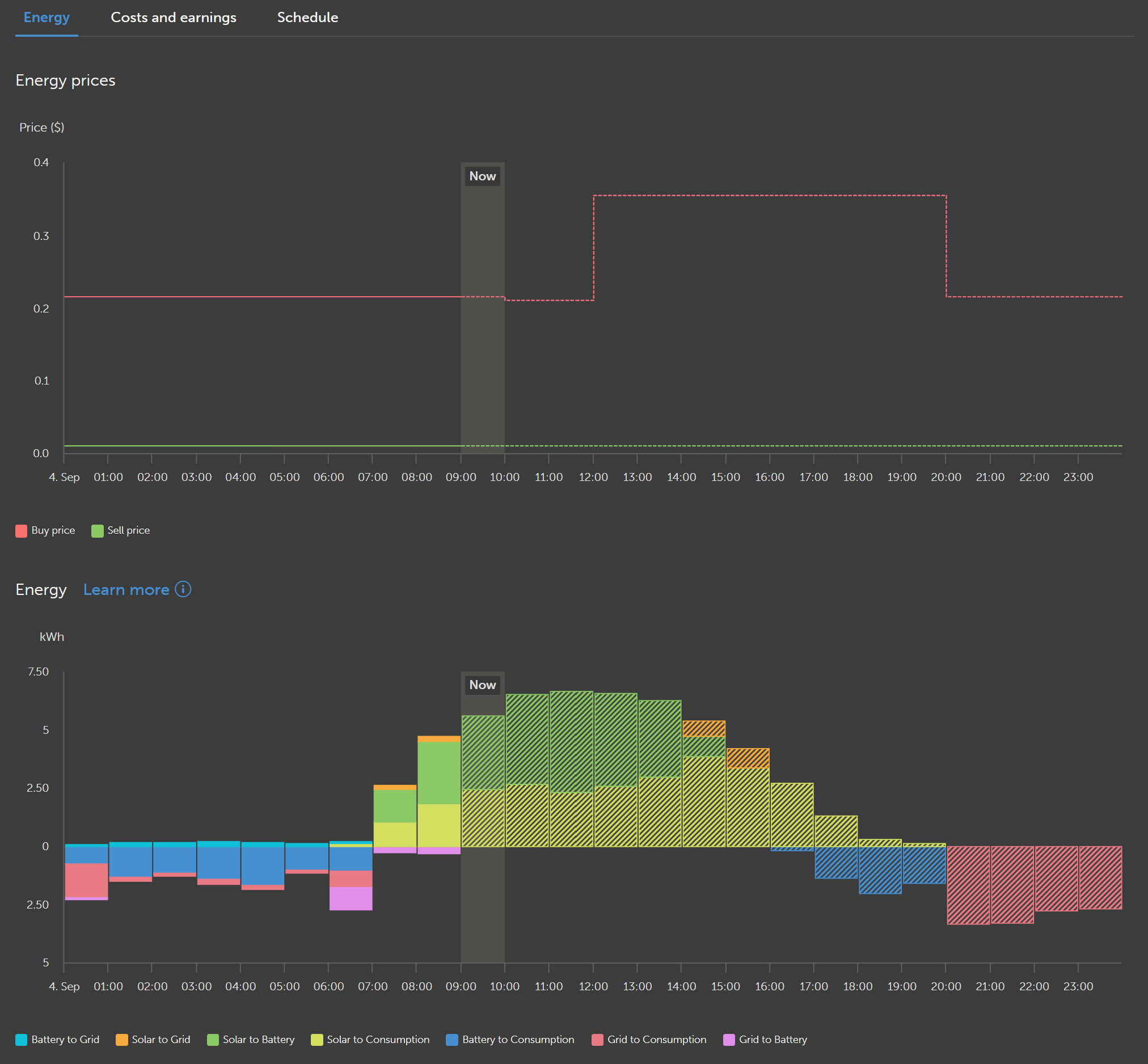

Today Same story as yesterday in the early morning. Tomorrow is a low PV day so the system is planning in idling this evening to save battery, and is planning on briefly self-consuming before sunrise tomorrow (reaching 100% SOC mid-day tomorrow).
