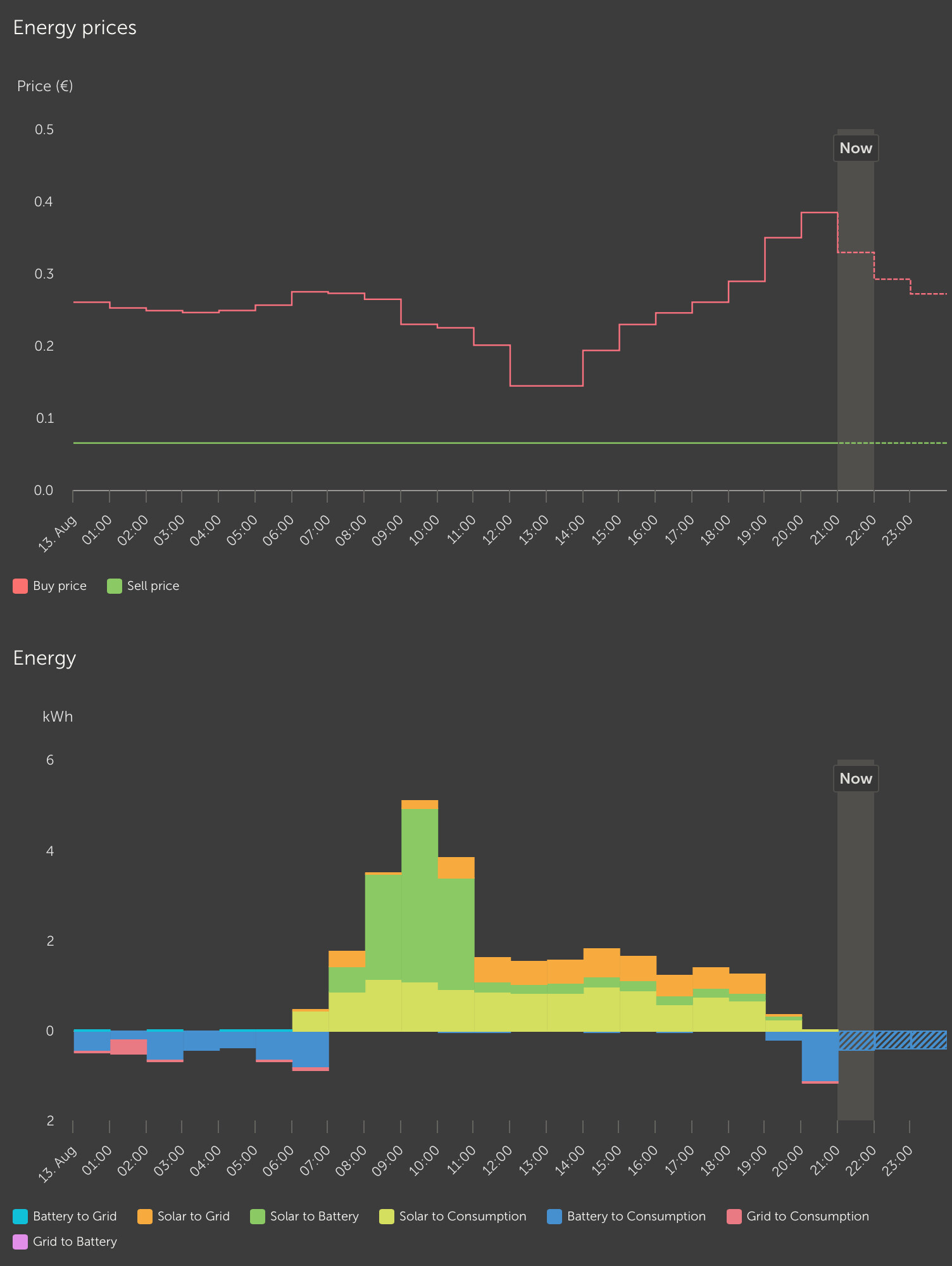

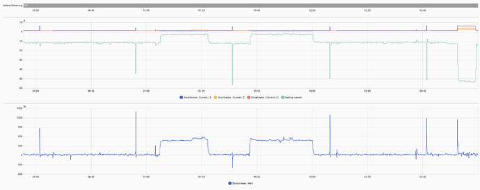

I have observed this strange behavior that my Victron Multi Plus 5000 setup was during the night all of a sudden consuming Power from the grid twice.
Here the screenshot from VRM:
where you can see that between 1 and 2 am there was about 0.32kWh of consumption that is not really explainable - no real peaks or anything.

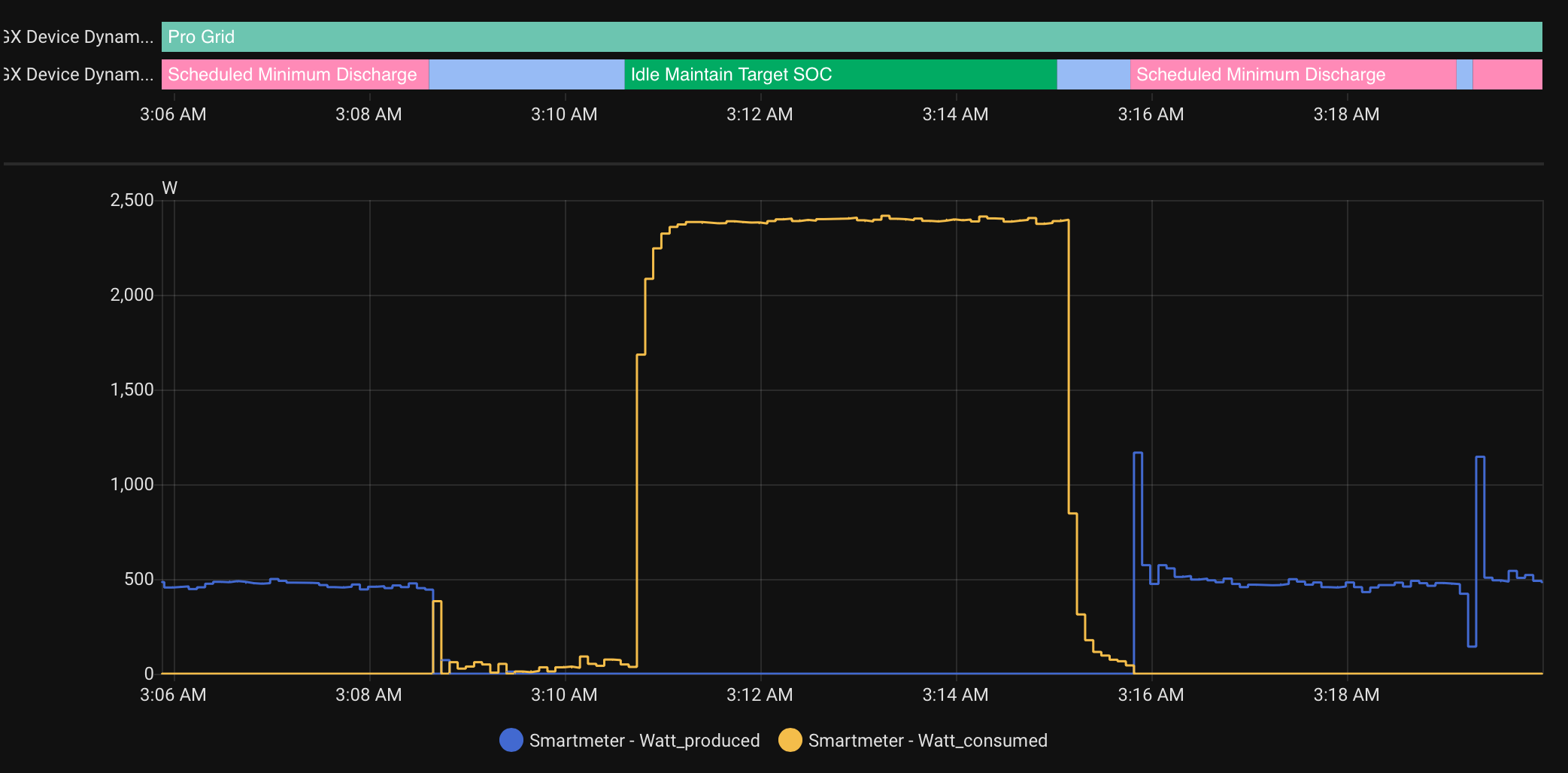

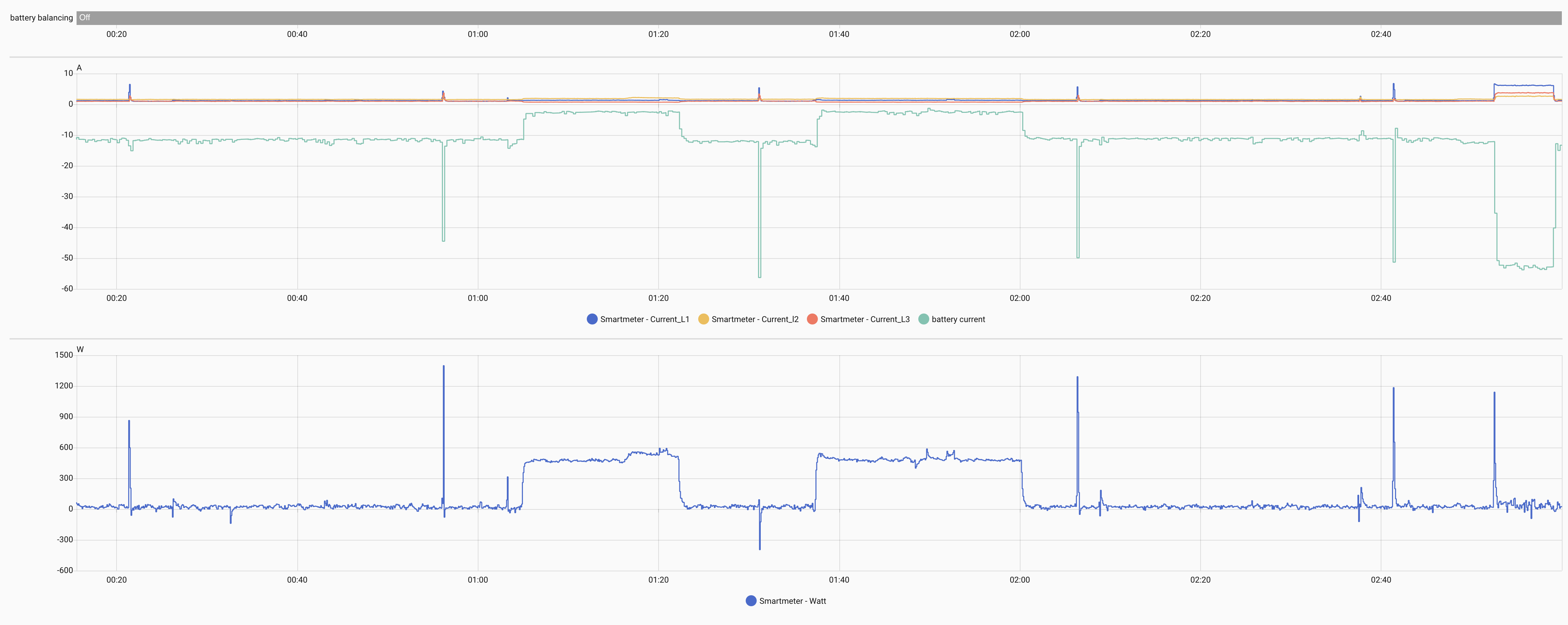

I also looked at home assistant graphs and found this between 0:00 and 3:00:
where you can see that there are to windows of consumption from the grid:
01:04 - 01:22
and
01:37 to 02:01
You also see that while there was this spike the load of the battery was reduced from -11.5A to -2.4A.
Any ideas why this could have happened?

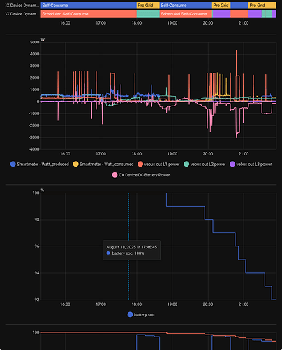

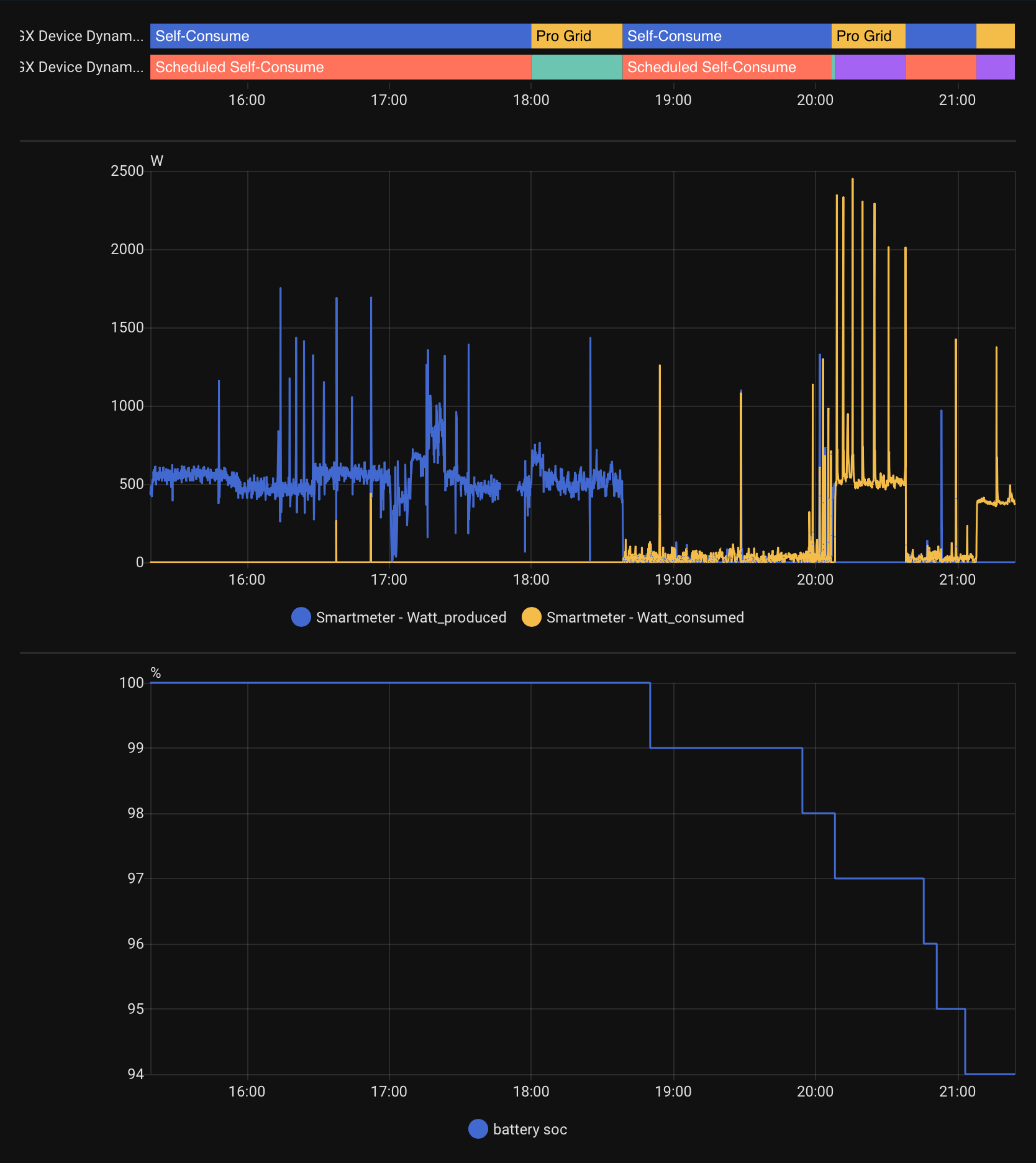

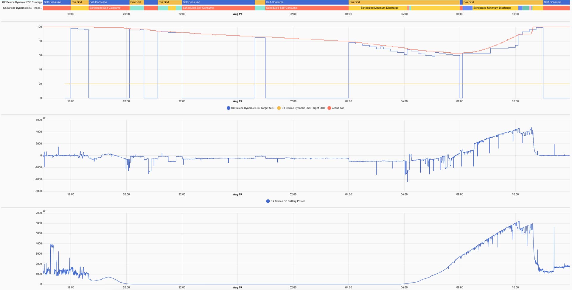

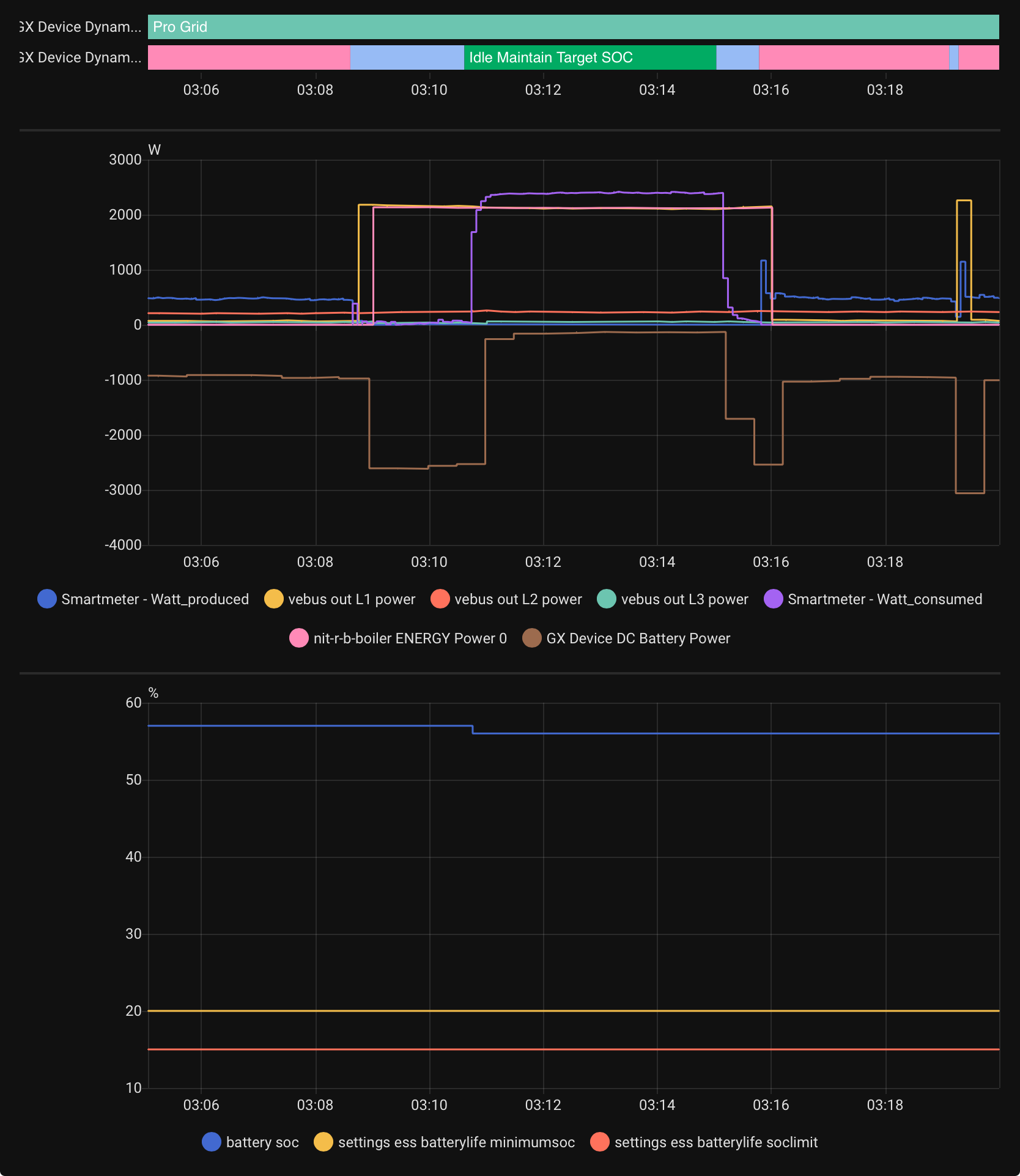

Here what it looks like zoomed in into HomeAssistant:
Blue (without text) is: self consume increased discharge!
My interpretation is that DESS has in its plan a (lower?) SOC target and when it reaches that because of some energy getting used, then it falls back to grid (to maintain Target SOC) even if there is no need…
Here some more details:
The trigger was the boiler heating up water…
But see now also SOC currents for each phase on AC out, power of boiler as well as power drawn from battery
Also visible the SOC limits that are not the ones specific to the DESS schedule.
Why DESS would switch to idle- maintain SOC is the big question!
So here now with DESS target SOC and minimum SOC:
So the target Soc makes huge jumps and it is not obvious why DESS is setting this up as is.

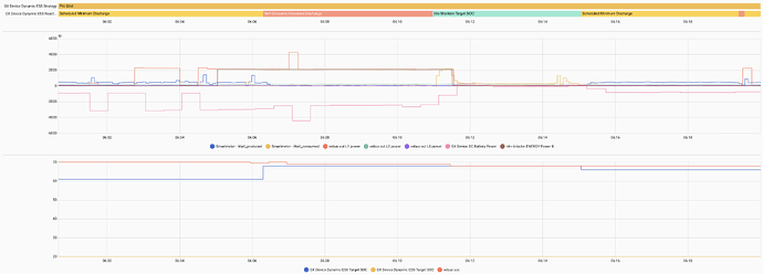

Timeline:
  • 6:00: battery discarging to grid and handling all the energy needs of the house
    • SOC: 70%
    • target SOC: 61%
    • reactive Strategy: “scheduled minimum discarge”
  • 6:02:43: Quooker water heater kicks in for about 30 seconds (making some tea)
  • 6:04:30: Boiler kicks in and runs until 6:11:40 (showering)
  • 6:06:17: DESS switches to:
    • Target SOC: 68%
    • reactive strategy: Self Consume increased discarge
    • SOC is: 69.5
  • 6:10:58: DESS switches to:
    • Target SOC: 68
    • reactive strategy: Idle maintain Target SOC
    • SOC is 69
  • 06:11:04: Power is coming from GRID at 2200W
    • Battery is still discharging at 2391W
  • 06:11:27 SOC Reaches 68%
  • 06:11:39 Battery draining drops to close to 0 Grid consumption drops to 400W (a ramp down)
    • from then on battery is sligthly charging and GRID consumption at arround 400W
  • 06:15:03 DESS changes to:
    • reactive strategy: Schedule minimum discharge
    • Target SOC: 66%
    • SOC: 68%
    • Battery consumption increases
    • Grid consumption 0W
I understand that the DESS is complex.
But this scenario is simple enough and in the end this switch of reactive state and increase in Target SOC needs to get investigated - something is going wrong there!
For what it is worth - why would it decide to increase Target SOC? Maybe Solar Power was just starting to kick in a little - but definitely not at above 200W…

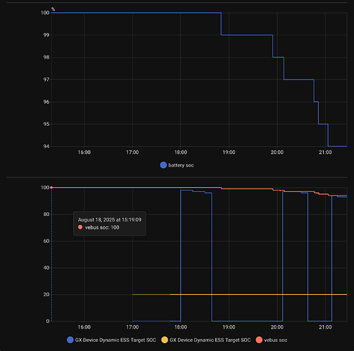

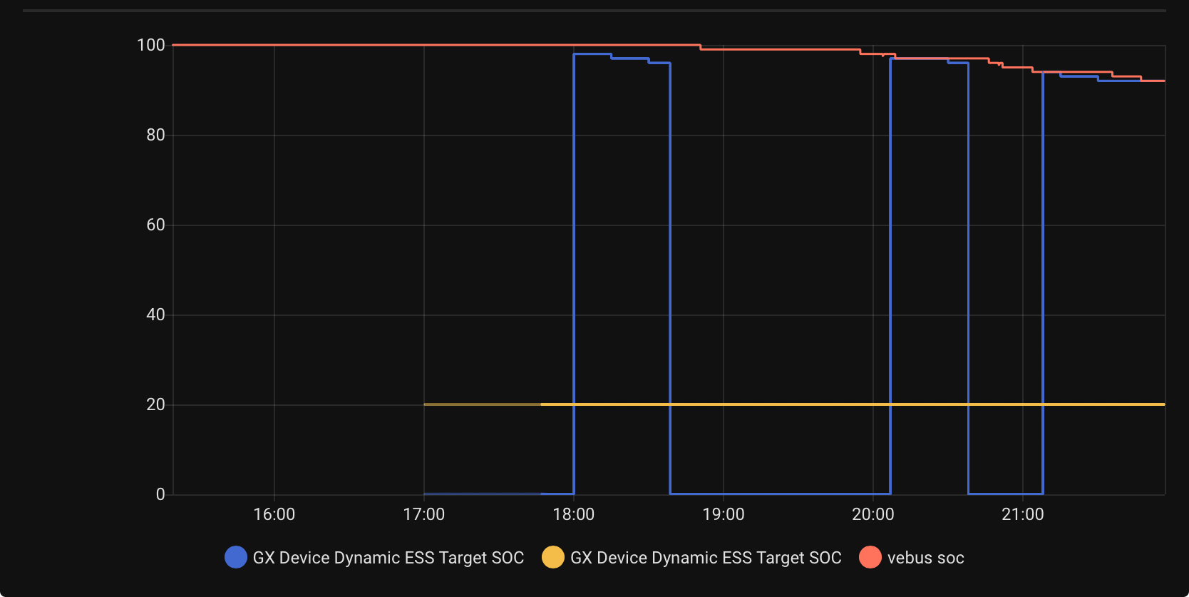

and if you look instead at yesterday evening (earlier post):
There the Target SOC was 0 and all of a sudden changes to a high value close to existing SOC.
And then again it drops to Target SOC of 0.
Something is not right there and victron should have an explanation why this is happening.

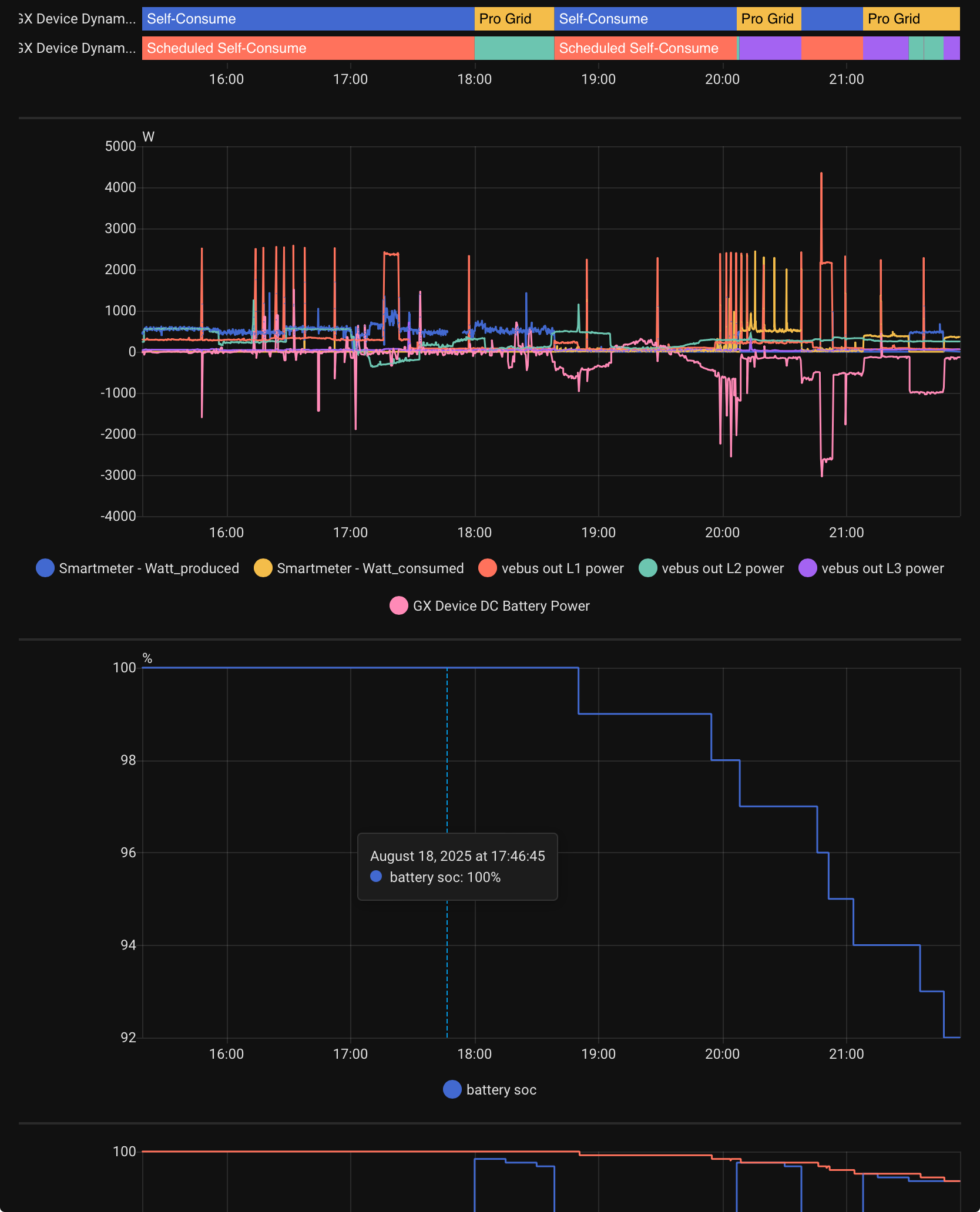

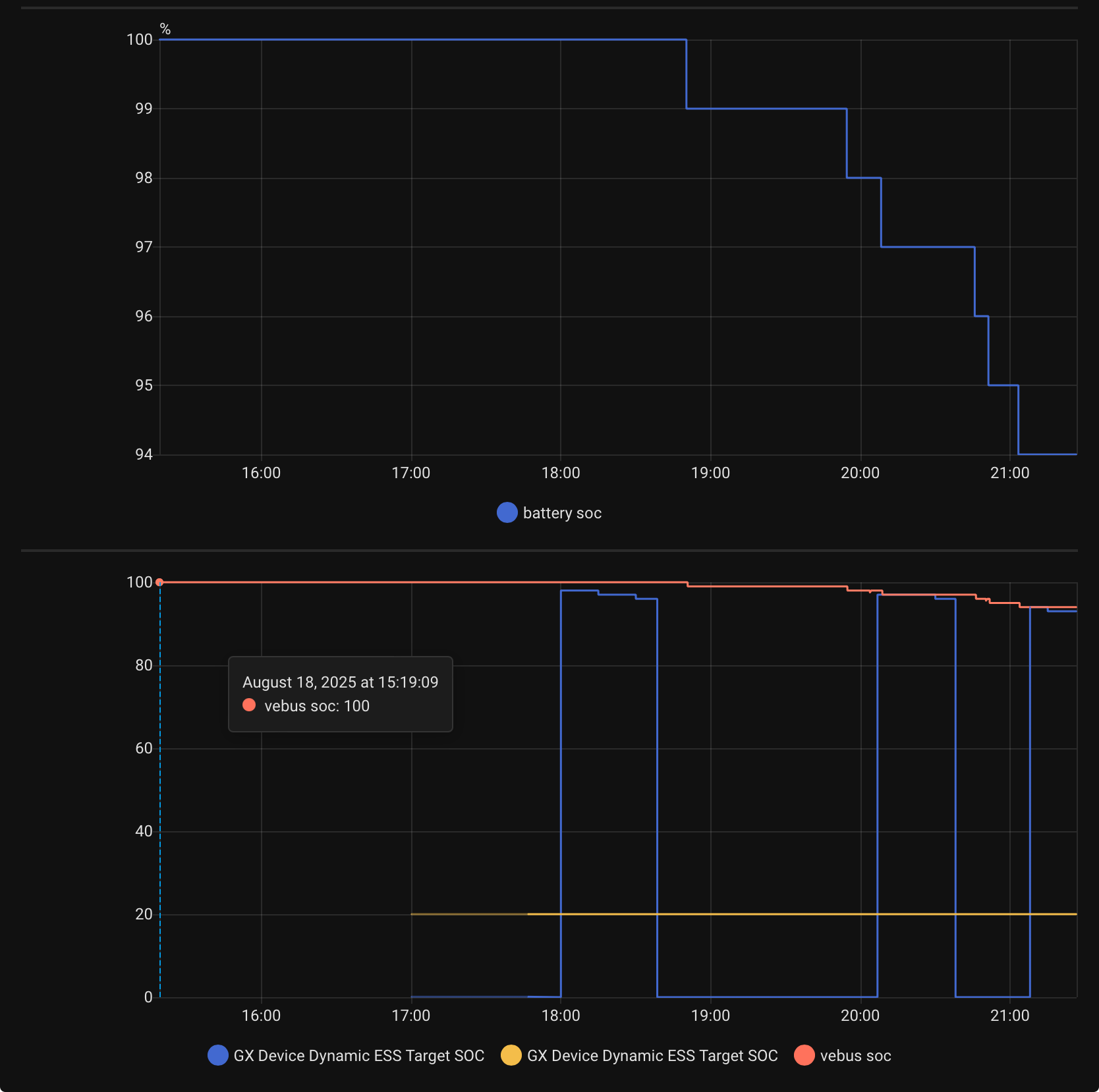

here the behaviour since yesterday evening
also including Batttery Power and (total) Solar Power
those jumps at target SOC ans strategy changes are what is strange.
And why there would not be a target SOC for most of the night, but then starting at 4am?

Hi,
Which version of venus OS you are running?
From your screenshots, I can see, that the gx went into Idle_maintain_target_soc during pro grid. This happens, when your system reaches the calculated target soc too early. (That can have many reasons)
However, the cut there is “too hard”, so in the current betas, this has been fixed. If this situation appears, the reactive strategy would be “Selfconsume_accept_bellow_tsoc” and just continue to drive loads rather than idling - accepting that soc goes bellow target soc and let the scheduler make the best out of it :wink:
So, you can either try the beta, or wait for the next official release.
