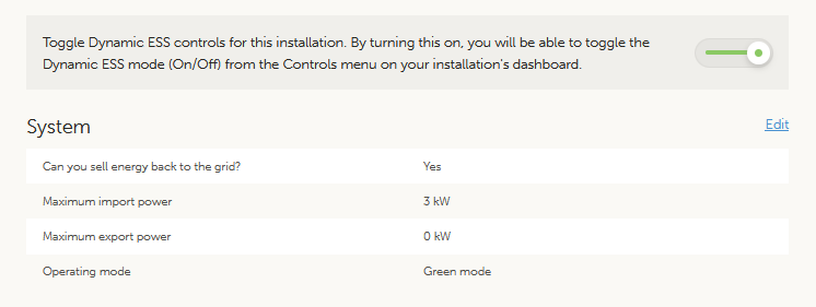

On my installation I have “Can you sell to the grid ?” set to “Yes” in DESS, because otherwise the Sell price isn’t graphed.
The “Maximum Export Power” is set to 0 kW however and obviously I’m running in Green mode.

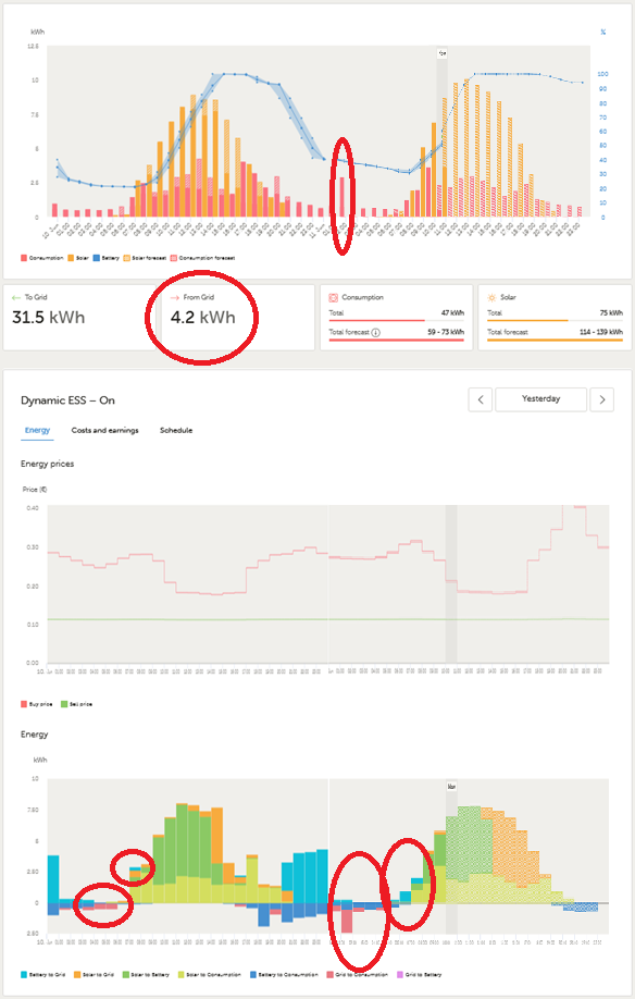

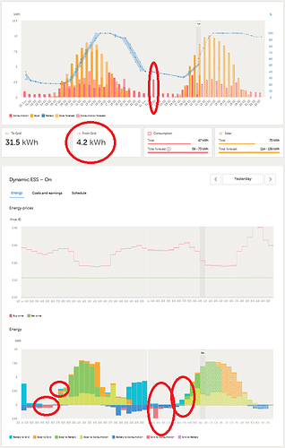

I’ve been using DESS since more than a year, yet very often swiched it off for some hours, since it was doing weird things. Yesterday I upgraded my RPI Venus GX to 3.60 hoping the §14a improvements stop this. I perceived no real change.
What bugs me most, is that it is discharging the battery into the grid to prepare for next day. In principle this is great, yet then it draws from the grid in the early morning hours, e.g. 4.2kWh for yesterday and today - this cost me more than 1€, propagated to the year over 150€, which I could spend much better. My 35kWh battery is dimensioned to take me through the summer without needing the grid, which works perfectly if I turn of DESS and set the grid-setpoint to something like 120W.
I would expect the DESS to keep some reserve in the battery to NOT draw from the grid. If necessary avoid solar charging in the morning hours to preserve charging capacity to avoid feed-in when negative EPEX grid prices (gross < 18ct/kWh from my provider). Weird that it even feeds from battery into the grid in the morning hours, while also charging the battery.

Today my system again exported solar surplus to the grid when my battery was full, even though I explicitly configured that this should never happen.
The “Can you sell to the grid” setting is enabled only so I can see the injection price.
If I turn it off, the injection price isn’t displayed.
Export power is set to 0 and export is disabled on the GX as well.
And yet, the system exported to the grid today.
There’s only an MPPT in this system and no AC coupled PV so I’d expect the system to simply throttle down the MPPT to remain at the grid setpoint.

Seems like DESS is ignoring my 0 kW export power setting and the setting that DC coupled PV surplus should not be injected.
If I set the DESS “Can you sell energy back to the grid?” value to “No”, the system behaves correctly - but then I no longer see the injection price graph.
Requesting it via the VRM API returns a value of 0, so that doesn’t work either.
As a workaround I’ve put this in a Node Red flow, since for some reason DESS tries to allow feed in.
When you set Feedin to enabled in DESS, that (currently) takes precedence over local ESS Settings.
We are internally discussing if it should be that way, or the other way round.
  • On one hand, local settings are “closer”, so should win.
  • On the other side, DESS is not ESS, setting and releasing Feedin-Allowance is a crucial part of the strategy, when it comes down to negative prices - so DESS settings need precedence to make this happen.
If you are not allowed to feedin, then don’t tell DESS you are allowed :wink:
