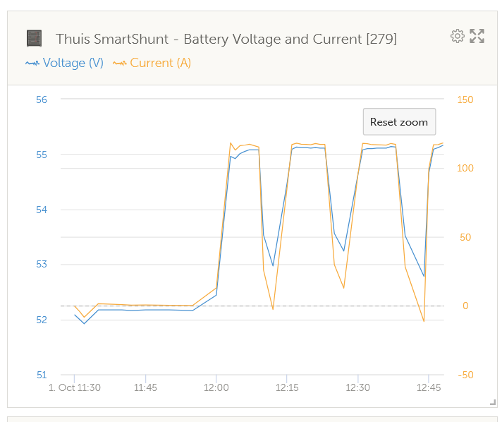

Hi,
I have a 3-phase MultiPlus 2 (5000) system with DESS activated.
When charging, it seems to go through 15 minute cycles, here’s an example from today.
Anyone got a clue as to why this happens? I’m pretty sure it’s not an overheating issue (charging at about 2800W max per phase ), room temperature is fine.

That’s not it, as this has been going on for weeks and these 15 minute intervals are not specific to a certain part of the hour either. My DESS pricing setting is per hour still.

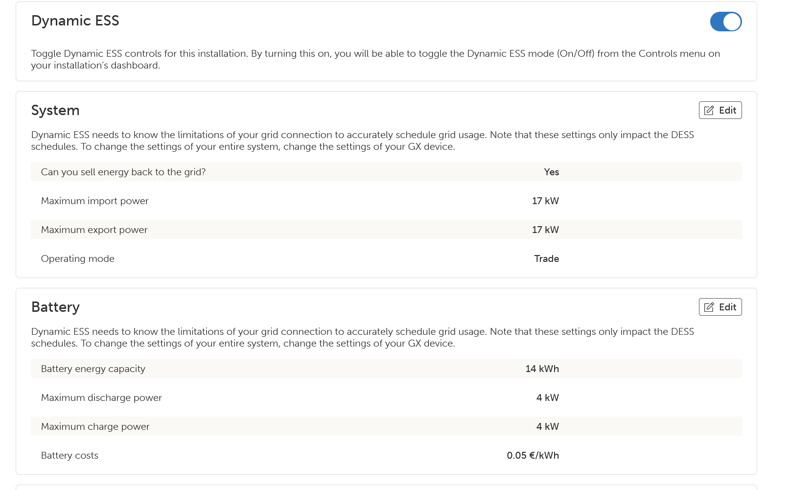

Is this the setting for Dynamic ESS in the VRM under Battery? I have that set to 4kW for both charging and discharging. This setting is somewhat puzzling too, as when discharging for DESS, it discharges with 4kW, but for charging is charges with about 6500W in total, despite that setting, which includes both grid and AC OUT coupled PV.
I’ve read elsewhere that the VRM DESS setting is only used for calculations, but why does it discharge with the 4kW as per setting then?

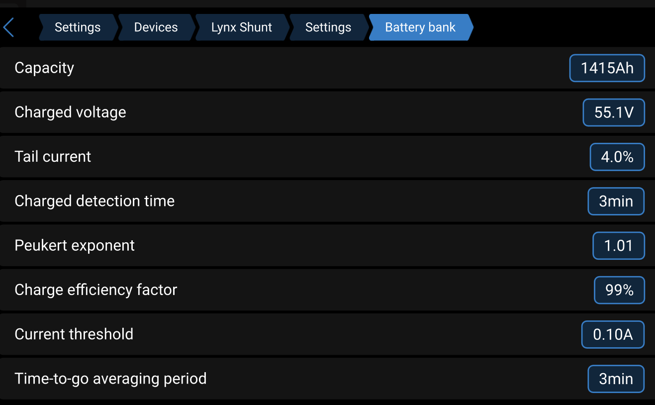

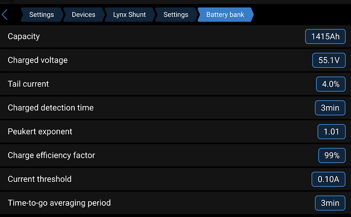

Can you tell a little bit more about your setup? Inverter type, 1 fase or 3, SmartShunt settings, DESS settings, etc.
40A single phase mains, MP II 5000 plus an additional 8kW boost charger (on the MP II’s AC-out) to max out that 40A mains during low price windows (neatly limited by the MP II’s ability to limit AC-in amps). 88kWh batt, BMV 712 batt mon (for accuracy), DESS Trade only (no solar). Tibber NL dynamic 15m pricing. And all house loads running off a separate 3kW inverter, freeing the MP II to act as a dedicated trade system.

not sure what shunt settings you want.

And a screenshot from your DESS settings would be helpful as well.
What comes to mind first is the battery capacity is underrated for your system. As a rule of thumb I use 1:3 DESS trade mode meaning when you have 15 kVA inverter power you need 45 kWh battery capacity.

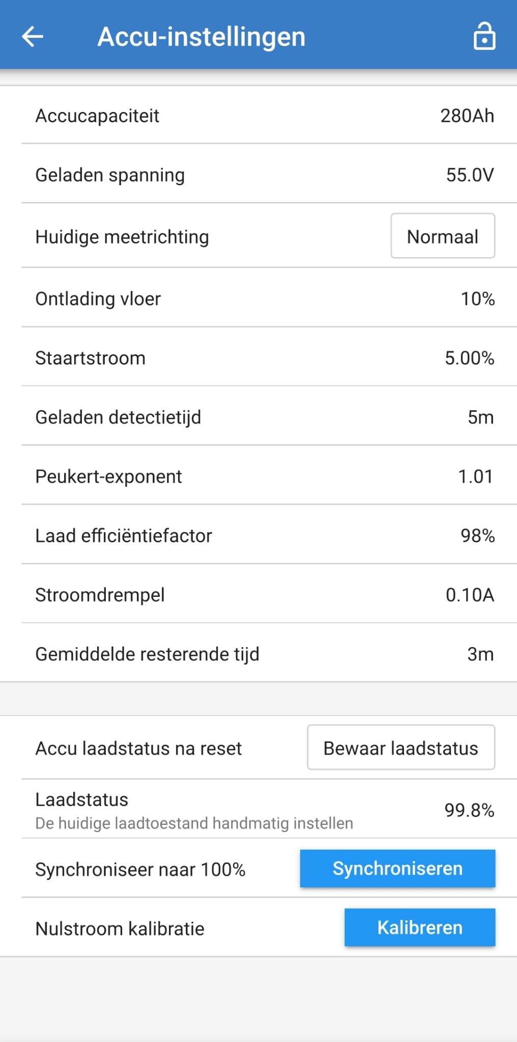

I’m afraid a SmartShunt (not the Lynx) doesn’t have this screen on the Cerbo, but … Victron Connect to the rescue.
Here’s the VRM DESS settings…

isn’t that battery charge/discharge power per system? then you should up that to 12kW (pending max current of your BMS as limiting factor)
