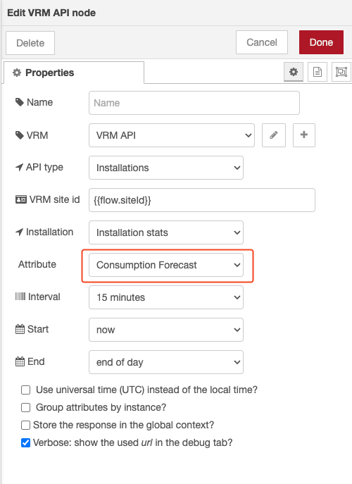

@dfaber how about consumption and PV forecasts - is it possible to retrieve them via VRM API? As far as I can tell the answer is no, but I’m looking forward to being taught the opposite.
consumption yes: vrm_consumption_fc
solar probably: vrm_ffcs and/or solar_yield_forecast (no solar here, don’t know for sure)

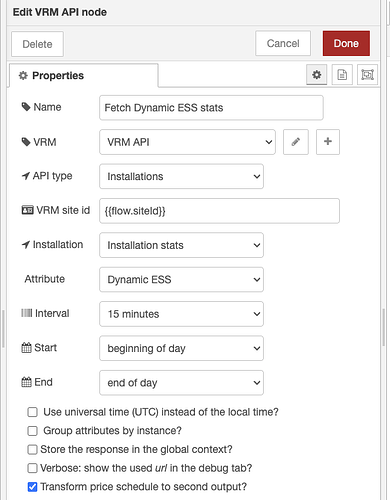

Haven’t made a release of it (yet), but feel free to check the latest changes to victron-vrm-api, which un-deprecates the Dynamic ESS stats:
That last checkbox Transform price schedule to second output? can be used to add a second output to the node, which gives you more info on the scheduling and can be easily used in a flow like:
Also the “Fetch Dynamic ESS schedules” now actually returns parsable schedules (from another VRM endpoint).
So that would look something like:
These are importable examples, so should be pretty easy to work with. E.g. filtering the proposed schedule by adding your own logic in between. See here and here.
Still would like to add some more documentation to the node before tagging the release. Feedback is welcome.
And @HansDampf : Consumption forecast can be queried already, just as PV Inverter Yield Forecast.

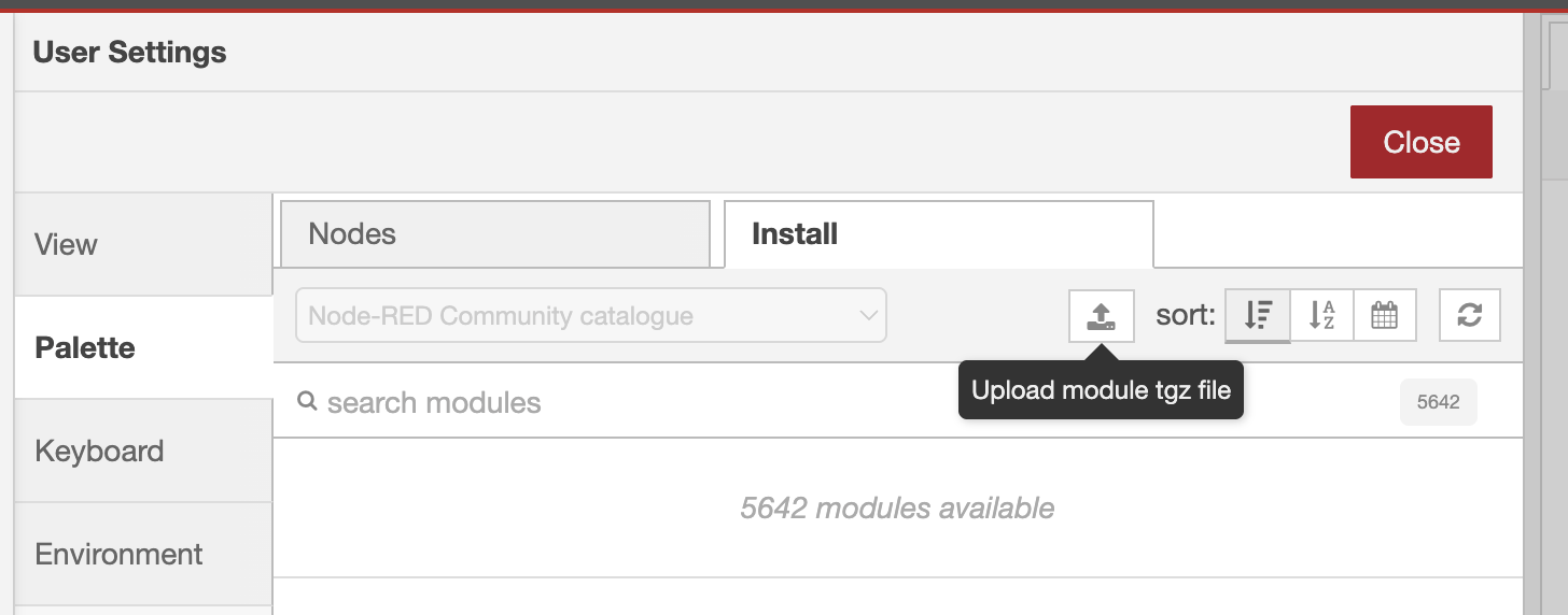

Can you try installing the alpha file from here?
Installing can be done by uploading the victron-vrm-api-alpha-0.3.6-alpha.1.tgz file via the palette manager
You’ll get a new node, that works independent of the other node:
Which can be easily tested. The plan is to get the actual 0.3.7 released this week.
Thanks, that works wonderfully and does seem to return a structure I can feed 1:1 into the /Settings/DynamicEss/Schedule/*
