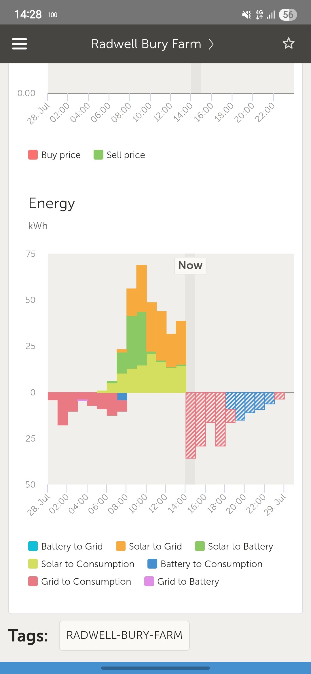

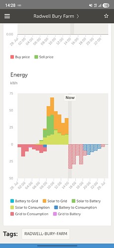

See attach screenshots of a scheduling DESS makes. It’s planning on using grid despite having a full battery and excess solar.
If I compare this to my house system it’s forecasting using solar and batteries.
(attachments)
See attached my configuration.
