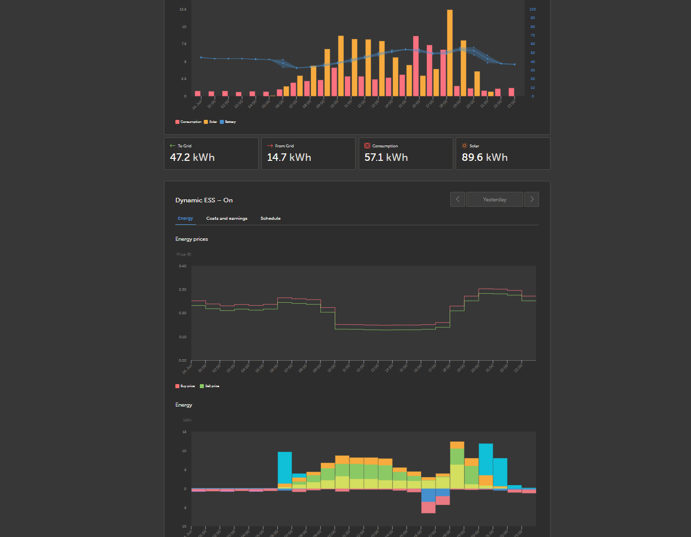

I am using Victron DESS in green mode. I have tried official version v3.60 and am using beta v3.62 now.
I try to understand the behaviour of victron DESS but am not anymore.
I have 3pcs of Victron Multiplus II 5000/48 (threephase) with 110kwh battery capacity.
The batteries are being charged, but not at full rate (11kW) and instead, green energy is flowing back to the grid. At night when the battery is discharging to the grid but it is not discharging at full rate (15kW) and sometimes is buying from the grid while the battery has more than enough capacity left.
I set the SOC to 15% but most days the battery is not discharged to 15% in the morning but most of the time only up to 25-35%.
Between the dynamic buying and selling price I set a difference of only 2 cents.
Pleas check the image of yesterday. The battery had enough energy to last till morning. This morning the battery was only discharged to 36% (instead of 15%) but the inverters still took energy from the grid.
Can anyone advise how to get a maximum charge and discharge of the batteries without buying from the grid
