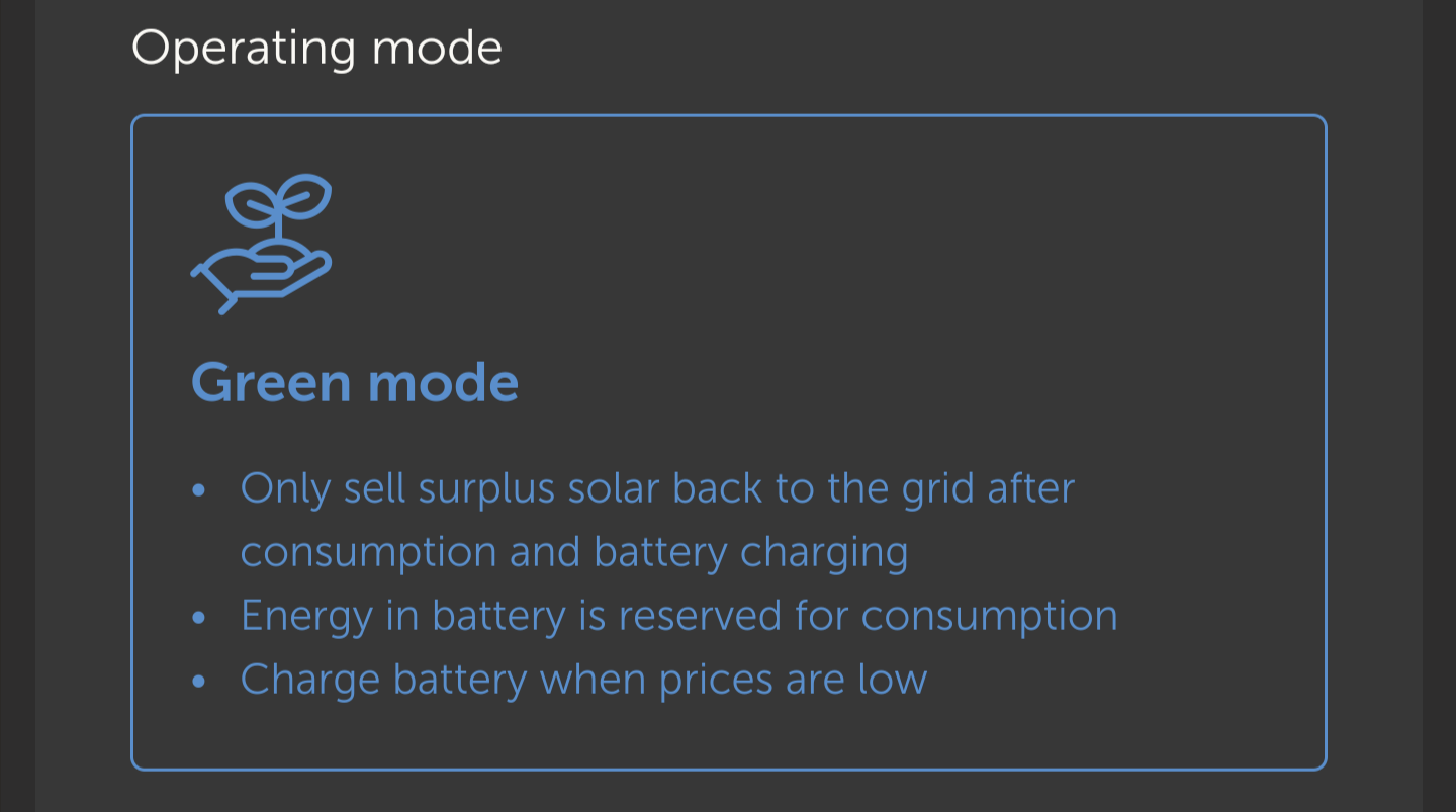

Similar issue here… Green mode.
Switching between charging and discharging and pulling from the grid at one of the most expensive hours of the day… even though there is lots of power stored on the battery.
I’m trying Green mode because Trade mode begins charging a near empty 15 kwh battery on the cheapest hour… which result in a charge period that goes into the expensive hours.
It should calculate how much time (in full hours) that is needed to charge the battery, with respect to all the settings, and find the most cheap hours of the daylight/sun hours and begin charging at the first hour of the hours it fund.
For Trade mode, it needed 4 hours the charge the battery… it started 13:00 (cheapest hour) all through 14, 15 and 16
It should have started at 12:00 to avoid charging in the much more expensive 16 hour
I got tired of that, so trying Green mode… but that’s even worse… it just starts charging as soon as there is PV power no matter the price. Strange behavior considering the last bullet here:

Your System may be in strategy “0 - Follow the target SOC” an thus it sells or buys just to reach SOC.
In my opinion this is a bug!
