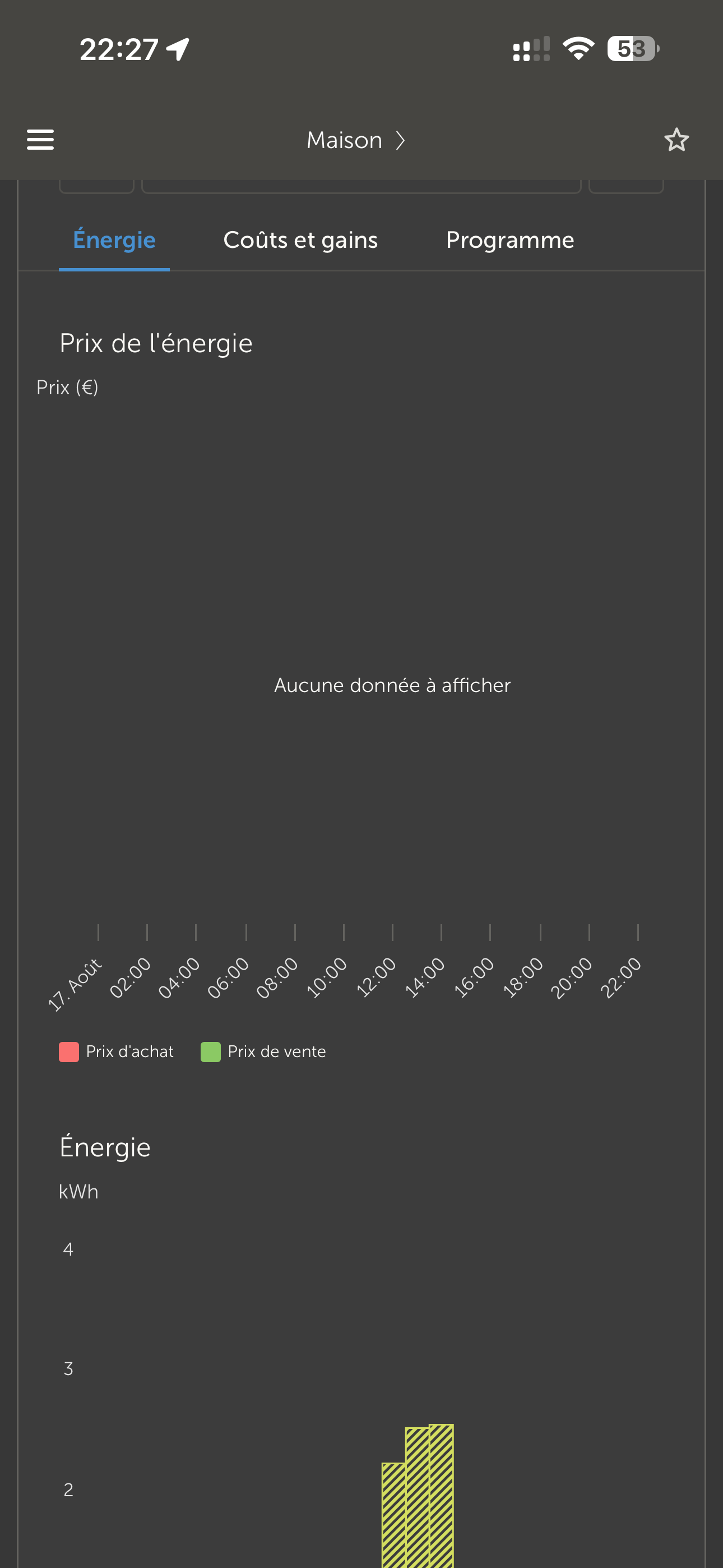

I just had a look to my dess forecast and it suddenly does not display anything from the hour to come and the whole day tomorrow out of the solar production. The price (French tempo) does not display anything on the vrm app, so I guess there is an underlying problem (possibly related to recent global issues on databases ??). I did not change anything on my system for weeks.

11pm was the end of the last scheduled strategy
My system just switched to dess strategy « unknown » and dess reactive strategy « NO_WINDOW » under node red

Everything went back to normal, by just waiting.
