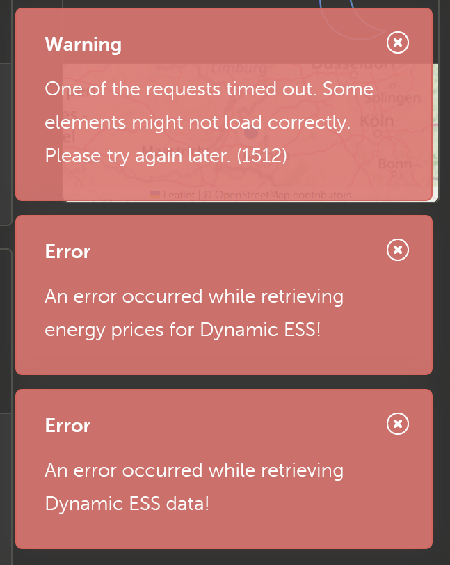

Database has issues and DESS decides just not to sell during peak hours!
Ok, DESS did it’s job the whole day. until the remote database went complete, poef.
Why should DESS be depended on a remote database when it already has all the dynamic pricing and the graphs showing it would sell.
And then just stops! if it has the data (or maybe could have the data?) and also already was showing the next day (yes before it went poef ) it should keep working.
True. I hate it when it decide to skip selling in the evening and keep the power for the next morning because it is 1 cent more benificial.
This power needs to be kept at 98-99% and peak shaving (witch only works above minimum charge) just cost 2 kWh extra to keep working during that night.
This is resulting in more cost than profit!
If the sell price is actual higher the next morning, it would be intended behavior. ( currently the Dutch 20:00 price was way higher than the tomorrow morning price )
My current issue is that because of the database, my system which was already showing all the data including the next day completely stopped selling at 20:00 when the highest day price went active. And halfway true the hour it decided to start selling.
Have the same issue.
Inverters stopped at the dynamic peek price (trade mode), now turned off DESS.
And now I get following errors and messages:
Hi all, we’ve temporarily disabled DESS scheduling. This is the first feature on the list to re-enable.
Nevertheless, once the schedule is generated and sent to the GX device, it should indeed just carry out that schedule, regardless of the database connection. Will forward this case to the team.
