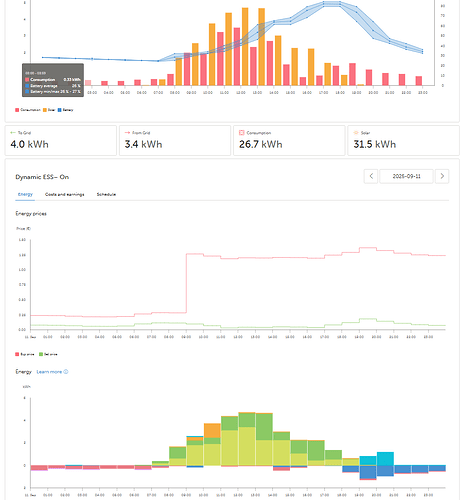

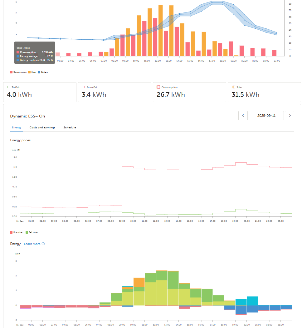

I noticed that DESS (in trade mode) sells from the battery in the evening and buys at a higher price in the morning. Since the price differences are small, I wanted to be sure and tried to change the formula for the purchase price +1EUR. This increased the purchase price tenfold and the price differences are clear. But the DESS algorithm behaves the same. It loses money.
Example in prntscr:
11.9.2025, 9h … I increased the purchase price +1EUR
11.9.2025 19-21h … DESS sells from battery to grid (for 0.14-0.18EUR)
12.9.2025 0-6h … DESS buys from grid to consumption (for 1.18-1.20EUR)
Same problem appears when I using fixed prices. DESS also did not respect the purchase price.

But from your screenshot, there are about 27% SoC left, so there should be enough to drive loads I assume?
In that hour, you had 330 Wh Consumption and lost ~1% Soc. Not knowing your battery size, but that seems like battery is used, despite the energy graph does not show that?
Do you eventually have ESS set into “Battery Health” Mode? This will raise the minsoc daily by 5%, when It couldn’t reach 100% during the day. That may continuously “lock down” the 5% DESS calculated to work with during the morning hours?

My battery is 14kWh. So 7% of the battery is about 1kWh. That is not enough for 0-6a.m.
On the contrary, it can be seen that DESS sold about 2kWh on the evening of 11.9., which it then bought from the network 12.9.2025 between 0-6a.m. And it had planned it in advance.

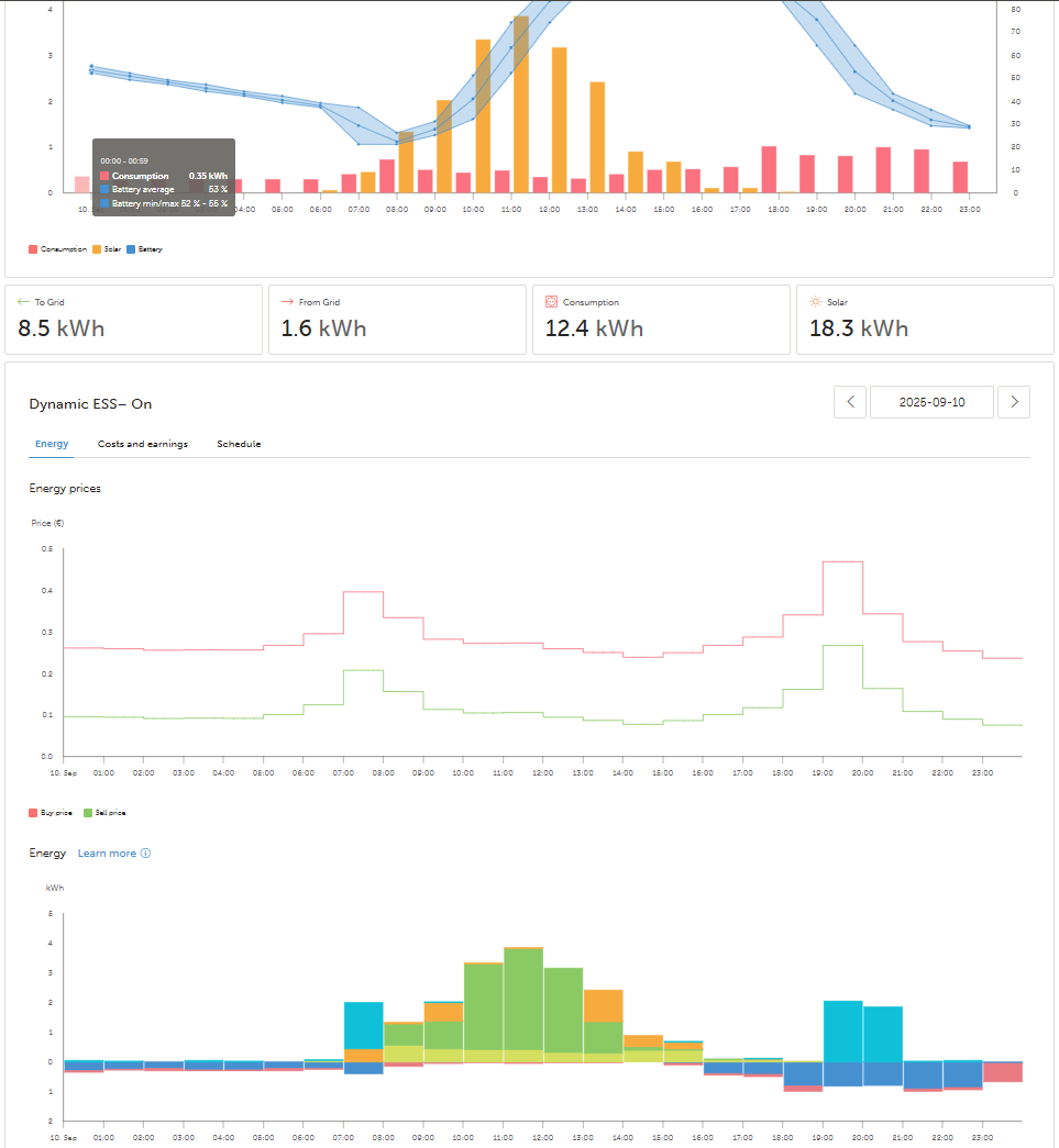

The same thing happened on the night of 10-11.9.2025. I am attaching a prntscr from 10.9.2025, when in the evening DESS sold 4kWh and between 23-24p.m. bought 0,6kWh + on 11.9.2025 between 0-8a.m. bought 2kWh.
This has happened several times and that is why I increased the purchase price by 1EUR (11-9-2025 at 9a.m.) and tested if it will do it again. DESS doesn’t care - it doesn’t take that formula into account. You already know more from the first message of this ticket.

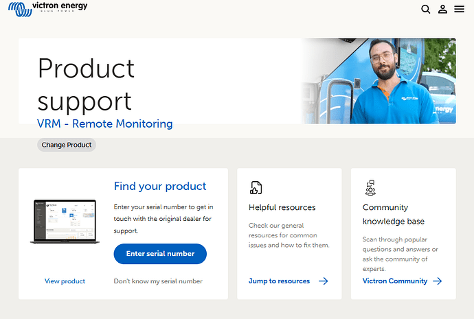

To get official support, please visit the support page linked in the community guidelines of this community forum:
https://community.victronenergy.com/t/community-guidelines
Dear Dognose,
The Support page you are referring me to only leads back to Community - to you.
Guy moderator edit: Just to clarify, dognose is not a Victron Staff member (at time of writing), I have updated his honorific to more accurately represent him as a Victron Expert. Sorry for the confusion.

Victron uses a dealer / distributor model, so your dealer is the conduit through which that feedback gets to Victron.

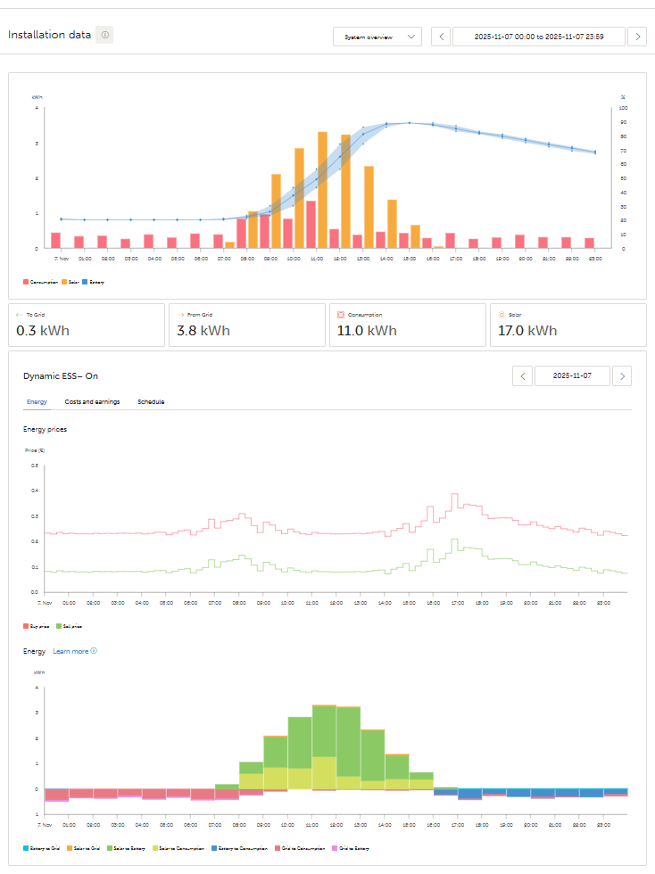

DESS is still losing money.
A month has passed and DESS is still making the same mistakes.
ScreenShots:
6.11.2025 at 16-18h. DESS sells from the battery
and from 6.11.2025 23h to 7.11.2025 8h DESS buys energy more expensively.
