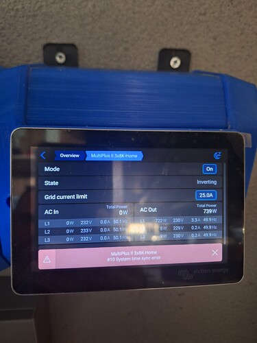

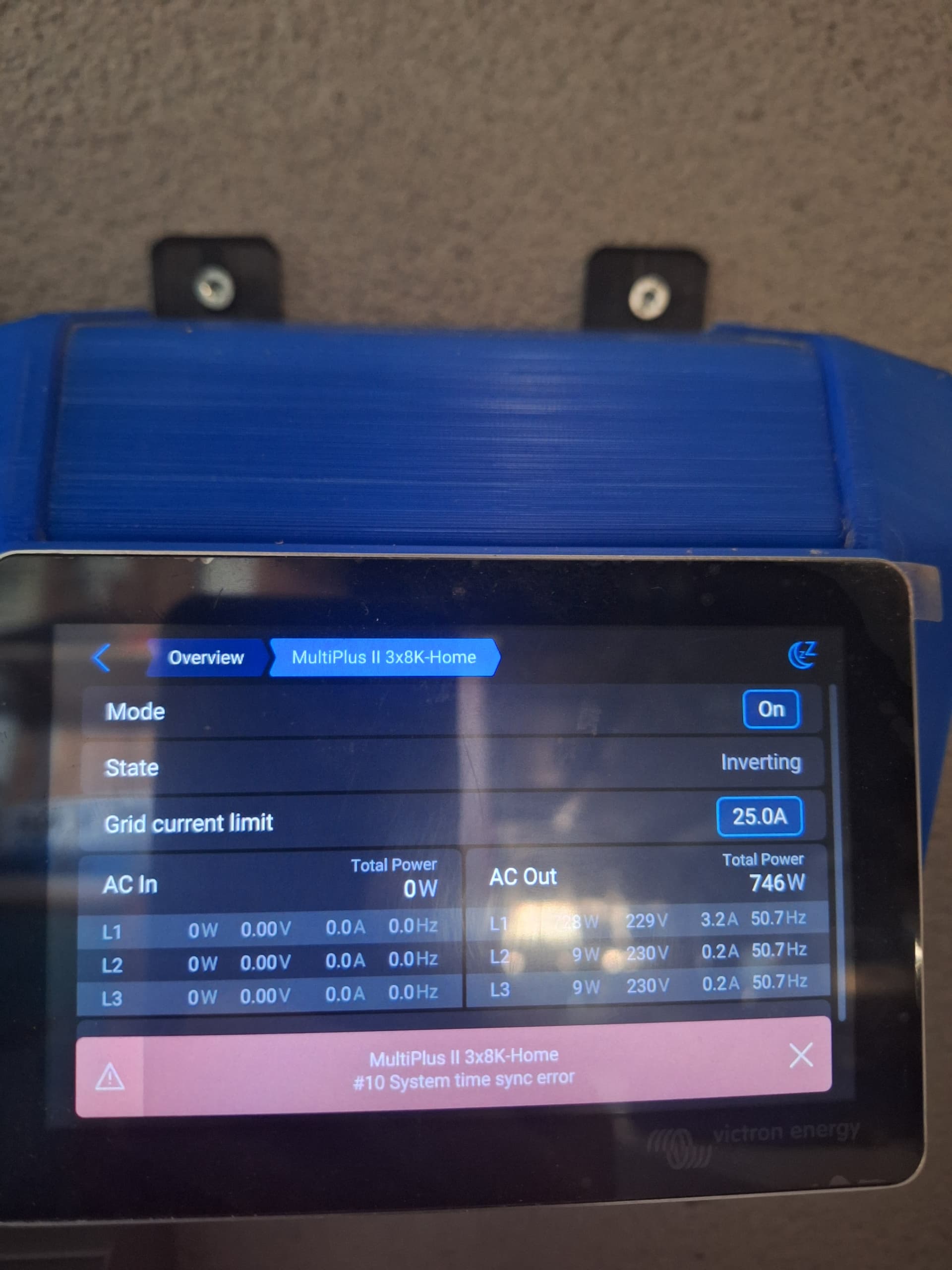

When i disconnect the grid .. they go to ups mode … BUT only for about 30sec.
Than they reboot and i get on cerbo - system time sync error - and off they go again … and than on and than off again .. you get the picture …
If grid is back.. they work again like it “should be”
Gridcode is : belgium ( but i tested germany and the no grid code option doesnt work neither)
So what could be the problem now?:thinking::grimacing:
Ps: i still do not trust the inverters 100% after yesterday .. but they " work"

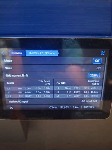

Edit : the off is even triggered in the cerbo :thinking:
How is that even possible ?( i dod not select off ) .. but when i get it back to on, in about 30sec. Its off again … ( sidenote, node red is off)
Personally I think the error message - system time sync - has a lot to do with it..
The time is indeed not correct. But I can’t set it correctly either, only time zone, but it doesn’t work (cerbo has internet)
#10 Error means that there is a communication error between the components.
Check the VE bus cables between the participants and swap the order of the multis …
