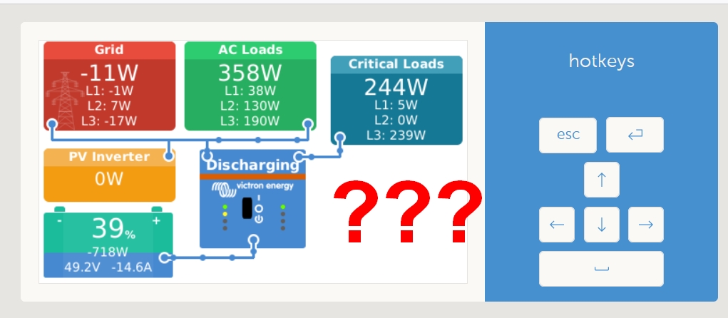

I’m planning to connect four Victron SmartSolar MPPT 100/20 inverters to my three-phase ESS system with 1x Multiplus II GX + 2x Multiplus II inverters via VE.direct via an active USB hub, in addition to the existing grid-connected inverters.
My question is, what will the display in the Remote Console look like?
Will there be a separate tile for each MPPT? So, four additional tiles?

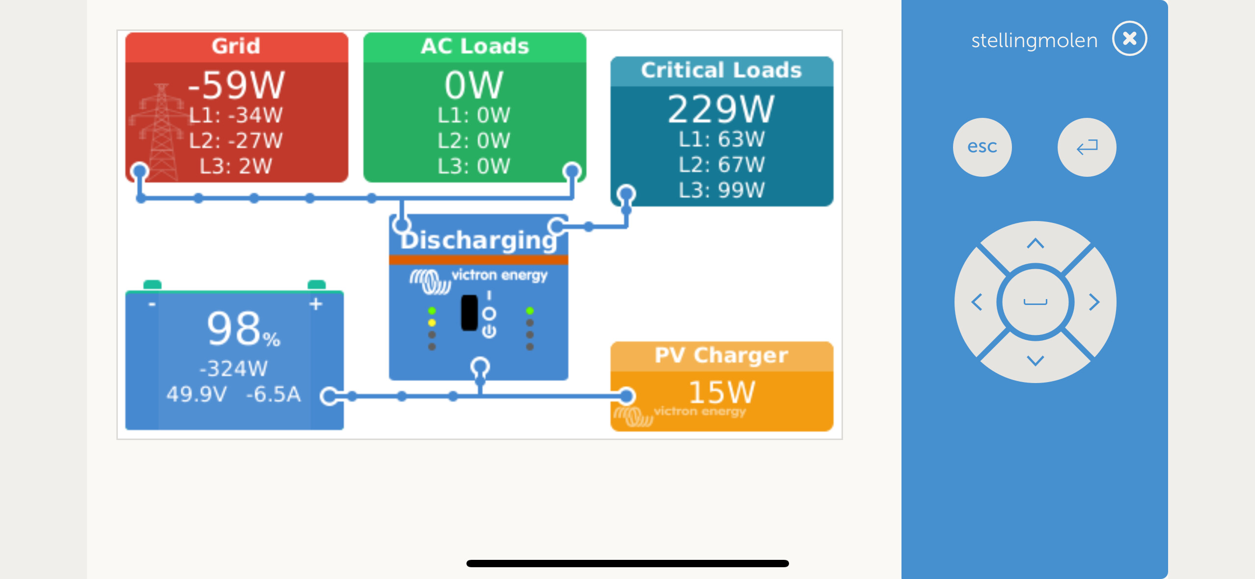

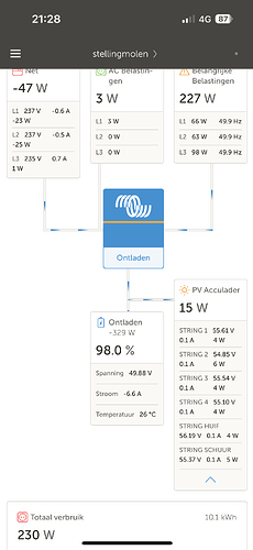

Hi just one tile for all mppts in remote console, in vrm you can see them in the details view
