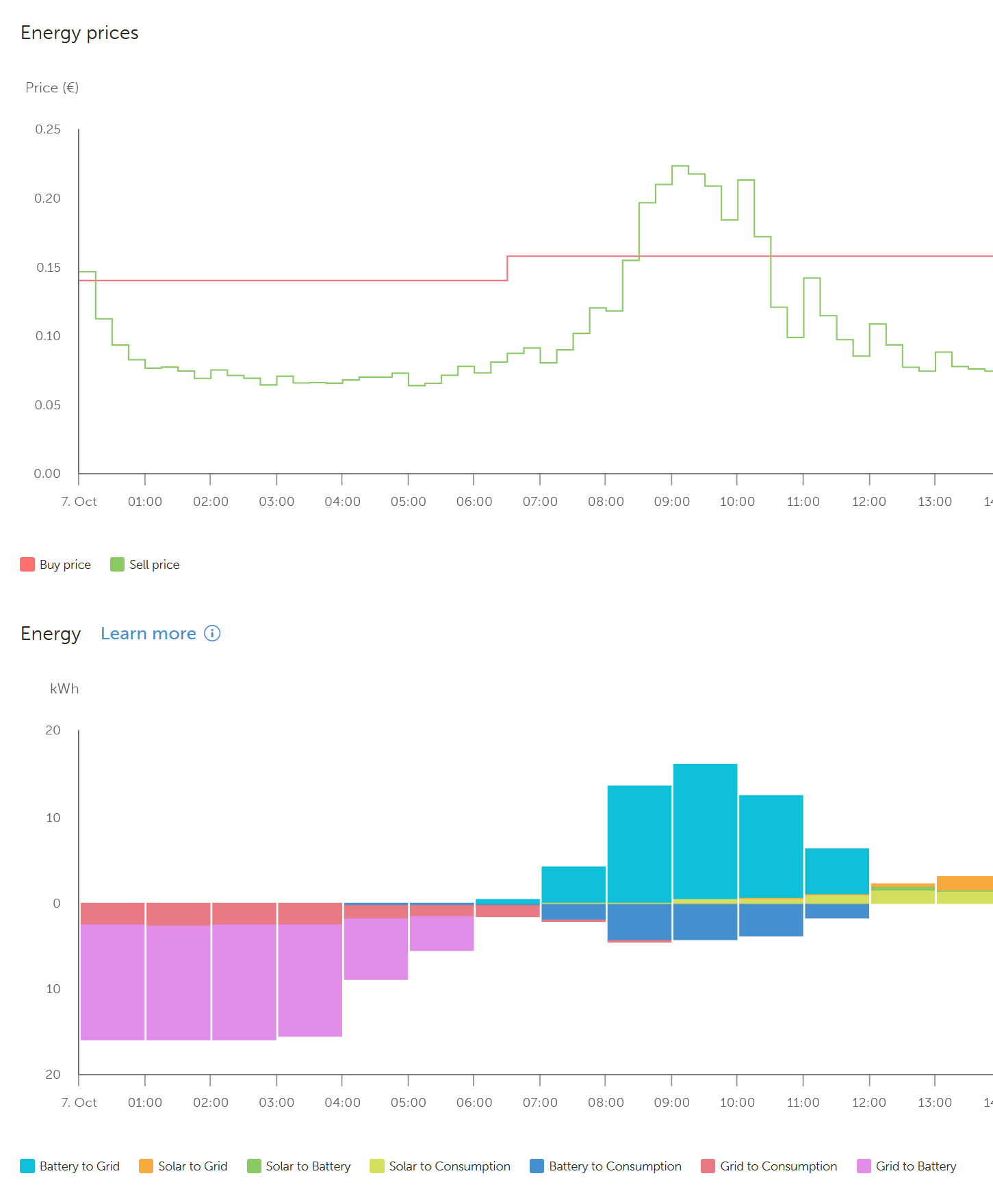

Graph from yesterday:

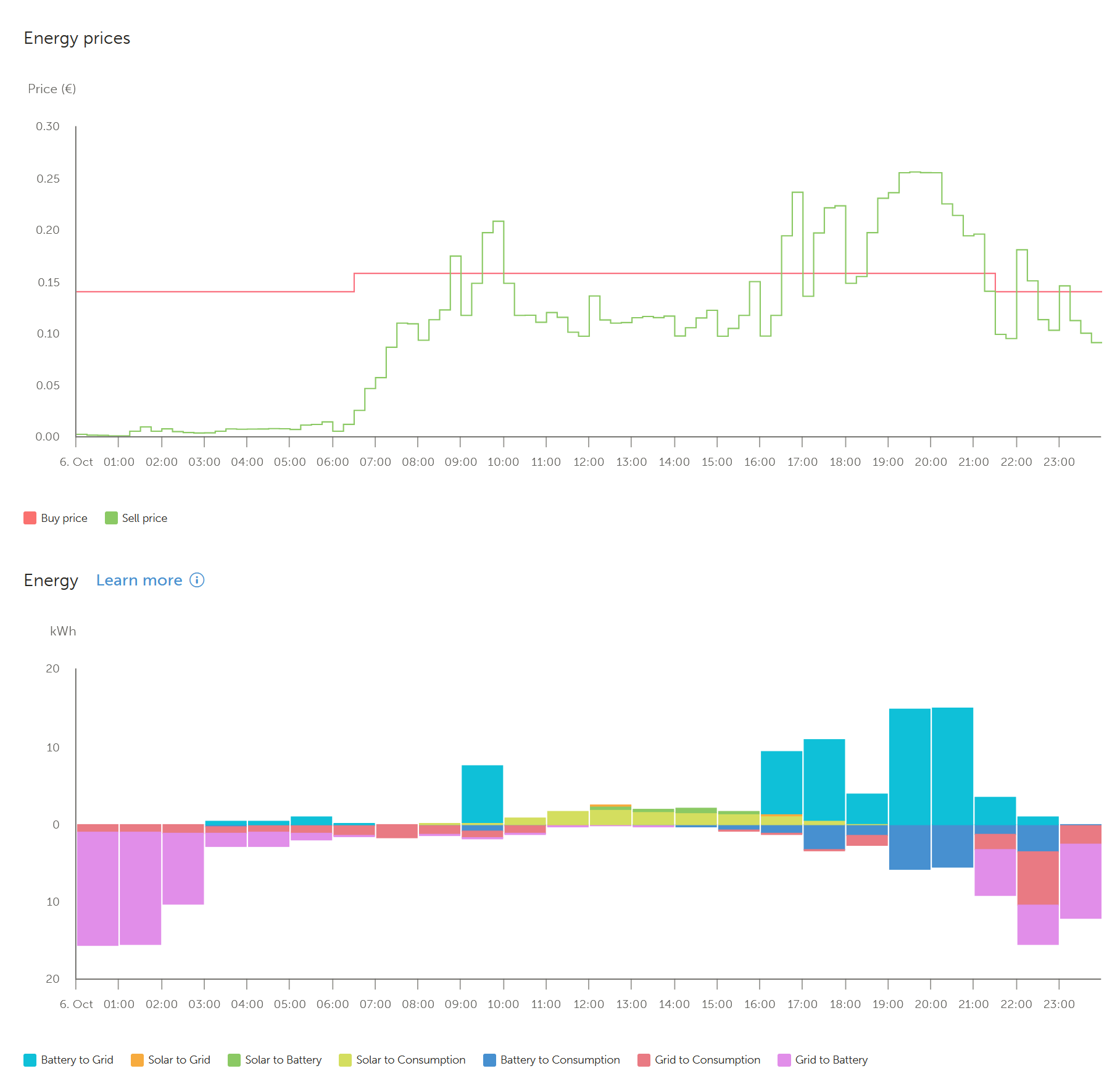

Today:
Also, it would be more than nice to have the lower graph follow 15min time steps.
Kind regards, ej
Today DESS decides to sell with a low-ish price and later on I have to buy more expensive energy.

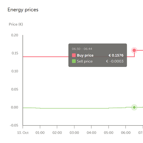

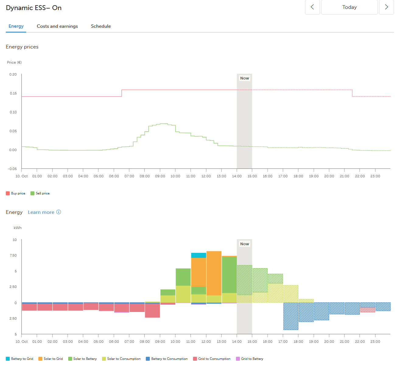

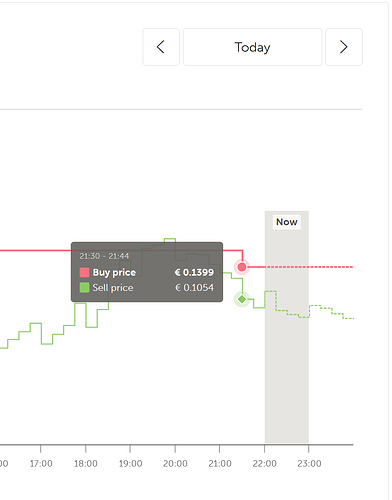

This evening I noticed that the DESS started to charge up the battery at 21:30 even though my prices get cheaper at 22:00. The settings for this should be correct.
There’s a 30min offset in both evening and morning:
@dognose , could you check this?
Thank you!
Kind regards, ej

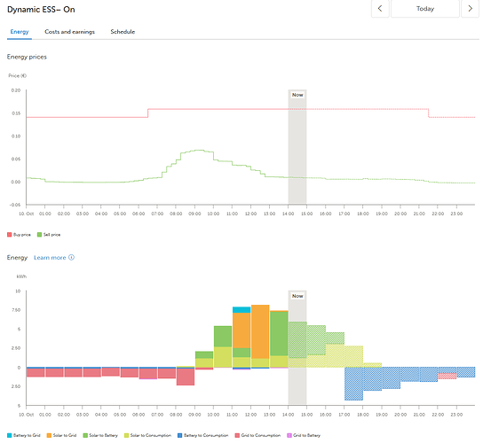

Actually, I had the same thing! A series of incorrect DESS behaviours - #12 by jkoljo
Maybe there is something wacky going on with time slots in DESS that causes such a systematic issue. I remember someone at the forum had time offset issues as well.

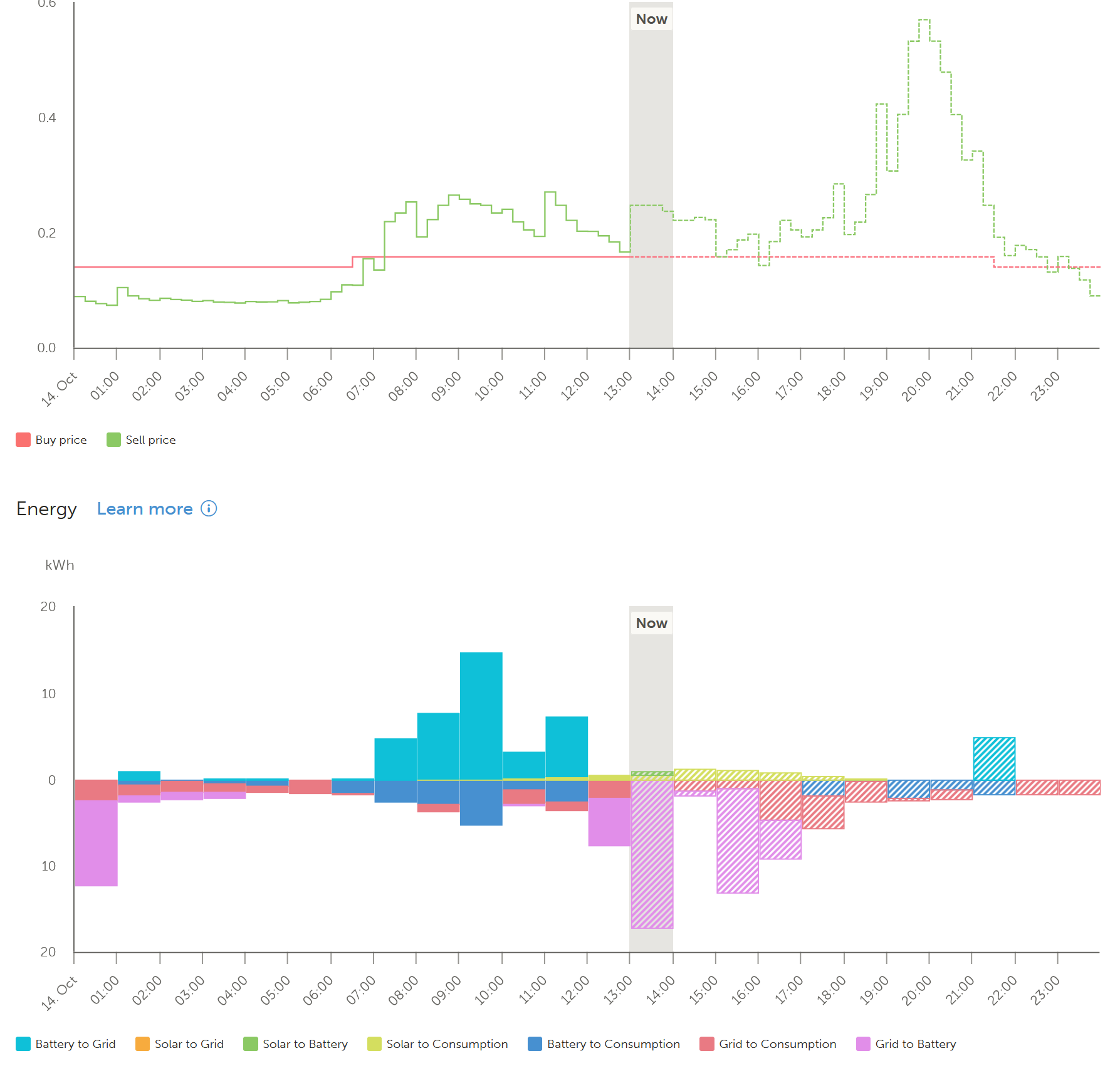

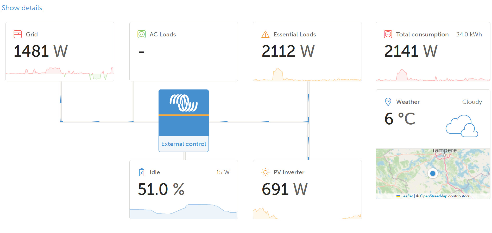

Right now the DESS has decided to get energy from grid, and the backstory goes…
Previous hour there wasn’t any planned recharging to be sold later on. I thought to manually set the min. SoC to force recharging. I missed the 13:00 time by one minute, and now DESS buys energy from grid:
..and had decied not to sell at all when the price is the highest.
I set the min SoC to 0% ofcource. I also tried to set the grid setpoint to -17250W as it’s my maximum output to grid.
Ping @dognose , is it not possible to manually force recharging to optimize profits? How should this be done?
Kind regards, ej
