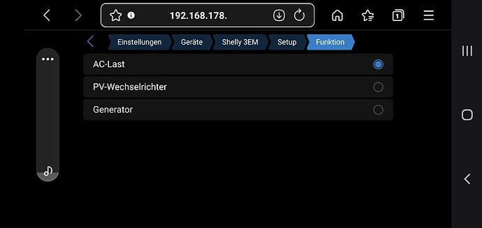

I have now seen that new firmware is available for the GX and installed it straight away. However, the problem still persists, although I noticed that Shelly devices can now simply be integrated. So I selected the 3EM.:slightly_smiling_face: The integration worked immediately, and the Pro 3EM is also recognised as an ‘energy meter’ (including in the VRM Portal!).
However, here comes the problem
 in the setup, you cannot select that it is a meter.
Consequently, nothing corresponding is displayed in the Cerbo console (under the grid icon) either (although as a device it does show all
phases, etc., as well as the import):roll_eyes:

As far as I understand it, some Shelly smart meters are now integrated directly into Venus OS and don’t require a separate script, but they can’t be used as grid meters. This is apparently due to the sampling rates, which are too slow for grid meters and the associated control functions, and are therefore not approved. So Victron won’t officially allow any meter to be used as a grid meter if it doesn’t meet the requirements. The solution using the script was never officially supported anyway.
