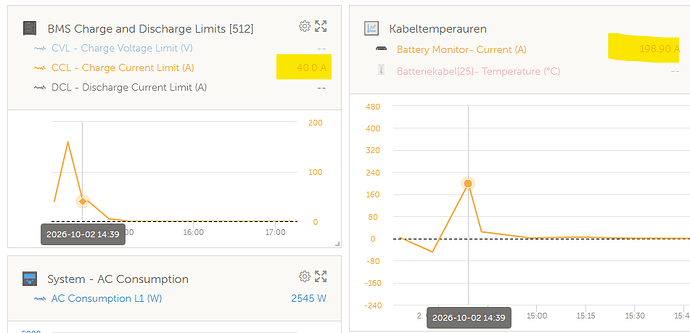

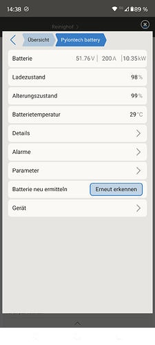

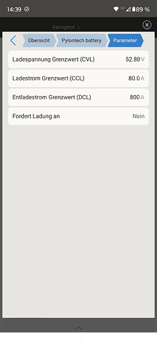

In sunny weather today, I noticed in the Remote Console that the batteries’ charging current (200 A) is significantly higher than the CCL value (80 A), which shouldn’t happen.

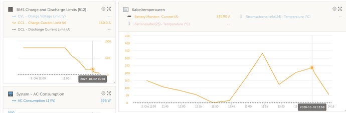

I just checked this again in VRM (15-minute log interval).
As far as I can tell from VRM, the CCL is exceeded (often by a lot) more frequently with Venus 3.80; with 3.75, everything seems to be working correctly.

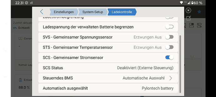

Is the battery selected as the controlling BMS in DVCC?

Hello Matthias,
I’ve checked the settings in DVCC again. I can’t find anything wrong.
I only noticed this because a charging current of 200 A was flowing at 98% SOC.
The current Pylontech firmware normally throttles down much earlier.
So I took a look at the CCL value.

I ran another test today and booted up with FW 3.80 at 98% SOC.
Immediately after booting up (remote console accessible via VRM), the CCL was once again NOT maintained (target 40A, actual 107A). I aborted the test to protect the batteries and rebooted with FW 3.75.
Immediately after restarting (remote console accessible via VRM), the CCL was maintained without any issues with FW 3.75.
