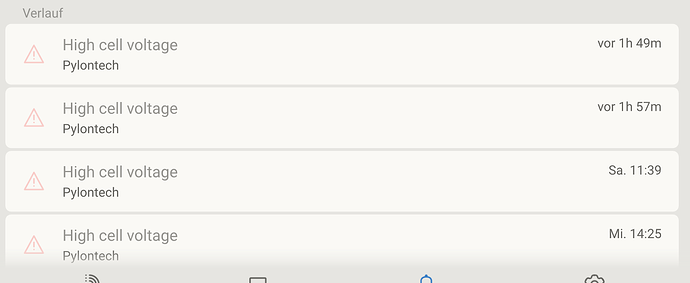

Hello everyone,
I have the following question:
My Victron system has been running smoothly and reliably for 4 years.
In spring, I added a further 2 kW of PV power via an MPPT 150/60. Since then, I keep getting the following error message:
“High cell voltage”
The MPPT then switches to the yellow area or to “Absorption”.
Why would the cells suddenly become unbalanced, or one cell reach too high a voltage, specifically after connecting the new MPPT?
Could it be that the additional MPPT is feeding too much power or current into the battery around midday, when the battery is already almost full, causing one cell’s voltage to rise too high?
Does anyone have any idea what could be causing this, or which settings I should check first?
Many thanks in advance for your help!

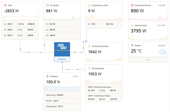

A bit more information about the system would be helpful.
Were you feeding back to grid before the additional new mppt?
As an observation that are probably charging up faster than previously and the battery has aged a bit.

Feel free to show the following values on the Advance graph:
  • Battery voltage
  • Battery current
  • CVL
  • CCL
  • Max Cell Voltage

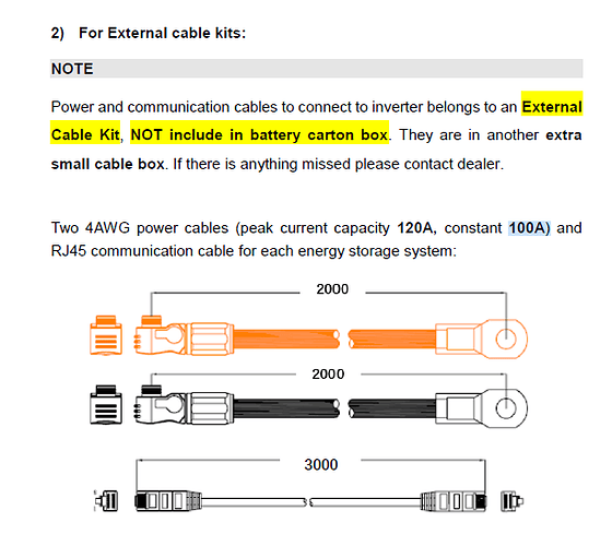

They are stacked on top of one another, with the outgoing connection on the 1st and 6th going to the busbar.
The Pylontech cables are rated for a maximum of 100 A with 125 A protection.
I would have grouped three batteries together, each with one set of battery cables.

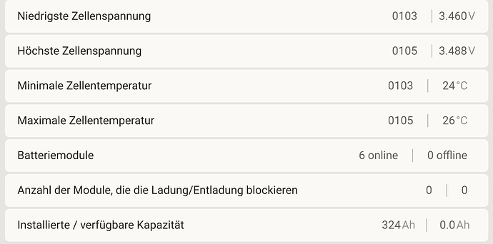

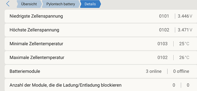

Where would you find the information showing which battery is generating the error message?
the first 01 is the first stack
the following numbers are the batteries in the stack, counting from the Master
So here, the 1st + 2nd and 3rd + 2nd batteries
Thanks, I found it.
The highest cell voltage cycles cleanly through all 6
