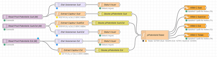

Three Solarsense750 sensors are connected to the slave, and I retrieve the data in Node-RED to send it to the master. The reason I use 2 Cerbo units is that the sensors are too far from the master. Both Cerbo units are on the same local network.
The information is retrieved and sent to VRM using these nodes: (W/m² instead of W).

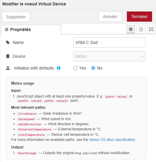

There is a problem in Node-RED with the Victron palette because the virtual “Weather” device does not allow the system’s potential power to be sent (natively "/InstallationPower’’ as an output from a Solarsense750), because this metric is not available in the Virtual Device:
I can therefore retrieve data in VRM, but with an incorrect unit:

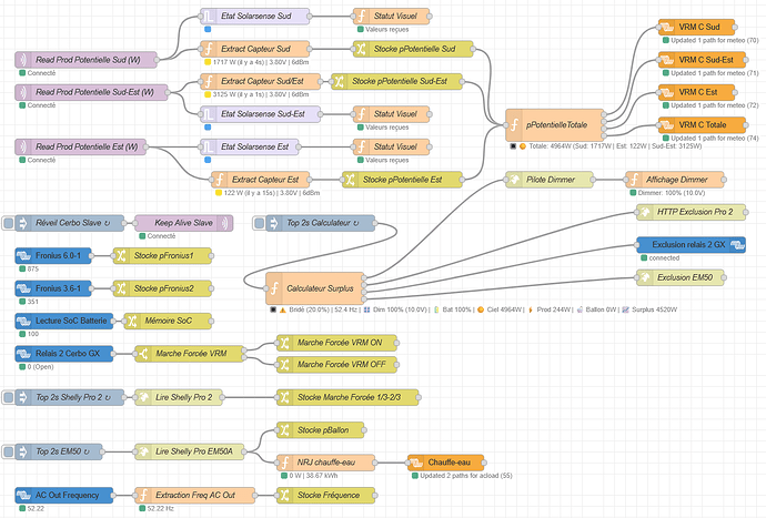

Here is the complete Node-RED diagram for reference:

  1. Can Victron modify the Virtual device capabilities for a weather sensor (which includes the Solarsense750) so that I can display the units correctly in VRM (W instead of W/m²) by adding the /InstallationPower path to the list below?
