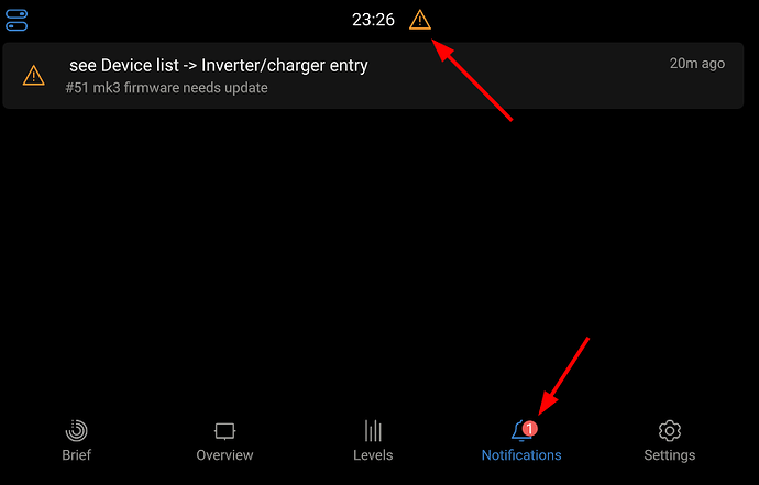

Can't clear notifications anymore after upgrade to 3.60FW
I can’t remove anymore the yellow triangle on the top.
In other words the notification is stuck in “unread” state as I have permanently the red (1) circle in the GUI, see screenshot below:
Reboot did not help.
I do not care too much personally, but maybe somebody could be annoyed by this bug.

The problem is not that the Mk3 FW notification is present, but it is stuck in the “unread” state.
To avoid any possible confusion, I will provide more details.
unread notification
A new notification that needs attention and it is not acknowledged/read yet. It generates a red circle with a number inside on top of the bell icon in the status bar.
AFAIK if there at least one unread notification also a yellow triangle is shown on the top.
read notification
User read and acknowledged notification. If all the notification are in read state, there is no need to show a yellow triangle or a red circle with number inside on top of the bell icon.
Before the 3.60 FW I was able to acknowledge the Mk3 FW notification and it was just stay in the notification list without bothering me too much: no yellow triangle or red circle on bell icon.
This is why I am confident I am reporting a FW bug here.

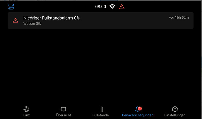

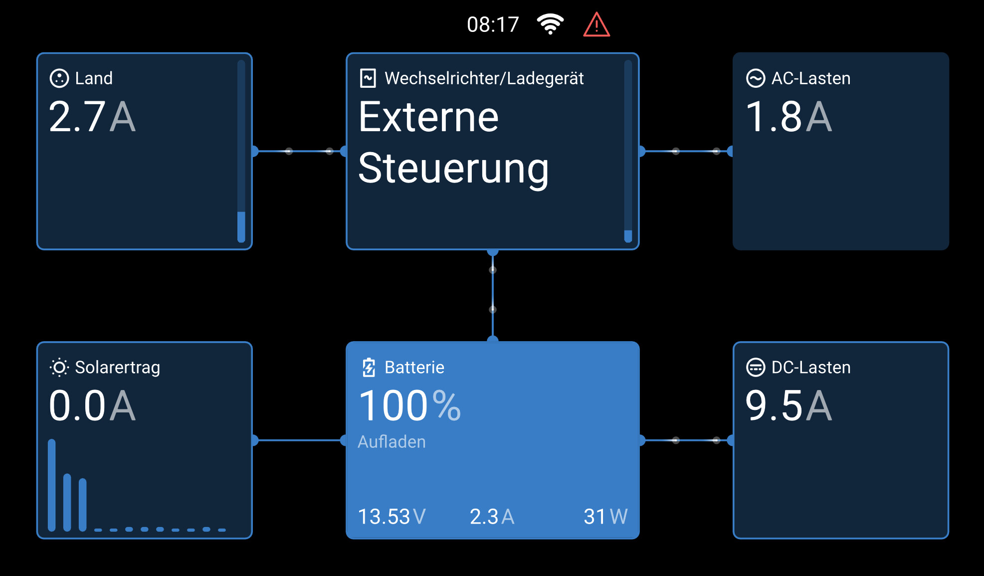

I have two water tanks at the cerbo. One is empty. The empty watertank alarm can‘t be acknowledged.
The alert apears randomly again. I only can silence the sound. The warning still persists.
The Venus team is aware and looking into it now.
Thanks for the reports.
Thank you.
This is the right photo.
We do want to show in the UI that there is an “active alarm”, even after silencing it.
What we’ll look into is how to better distinguish between active silenced alarms and new alarms
