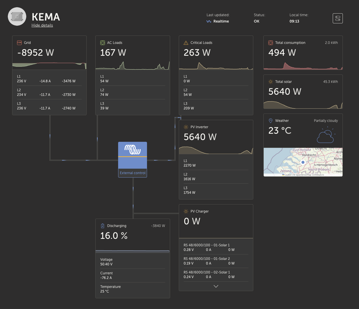

Ok, everything up to date and working atm, let’s hope for the best!
