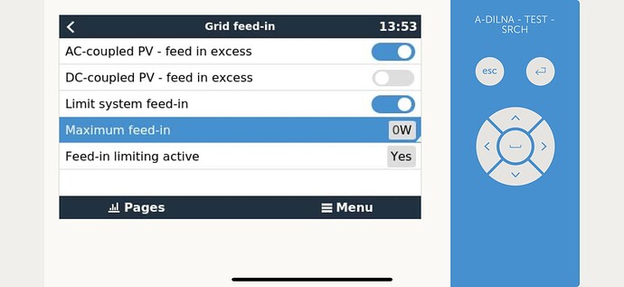

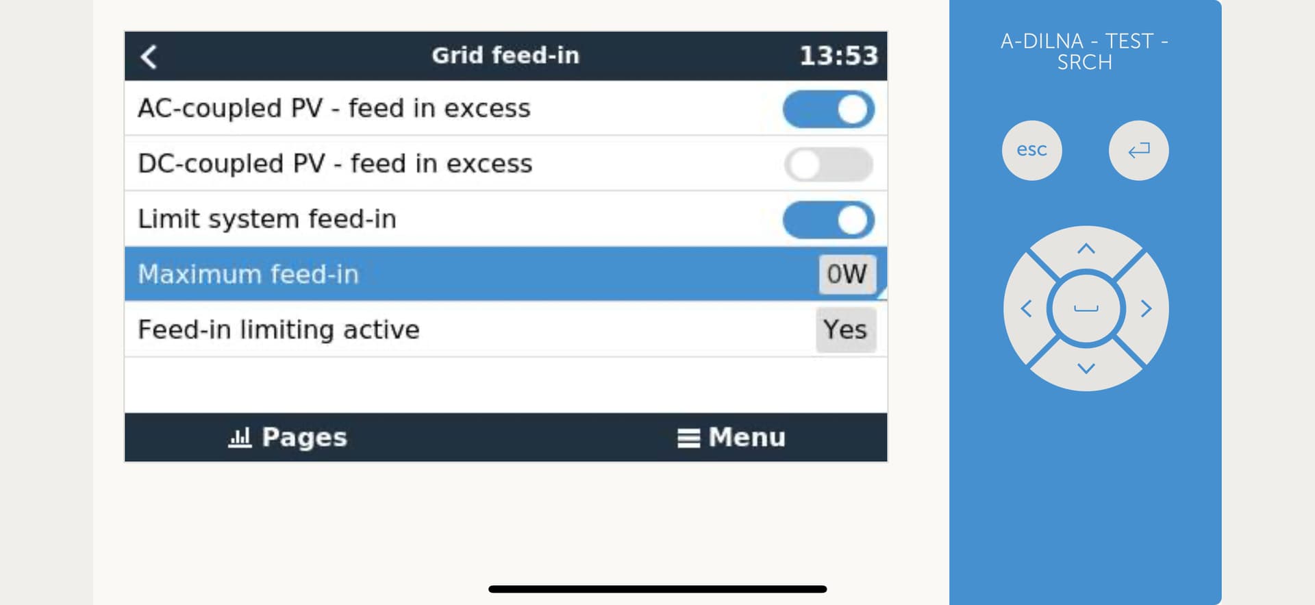

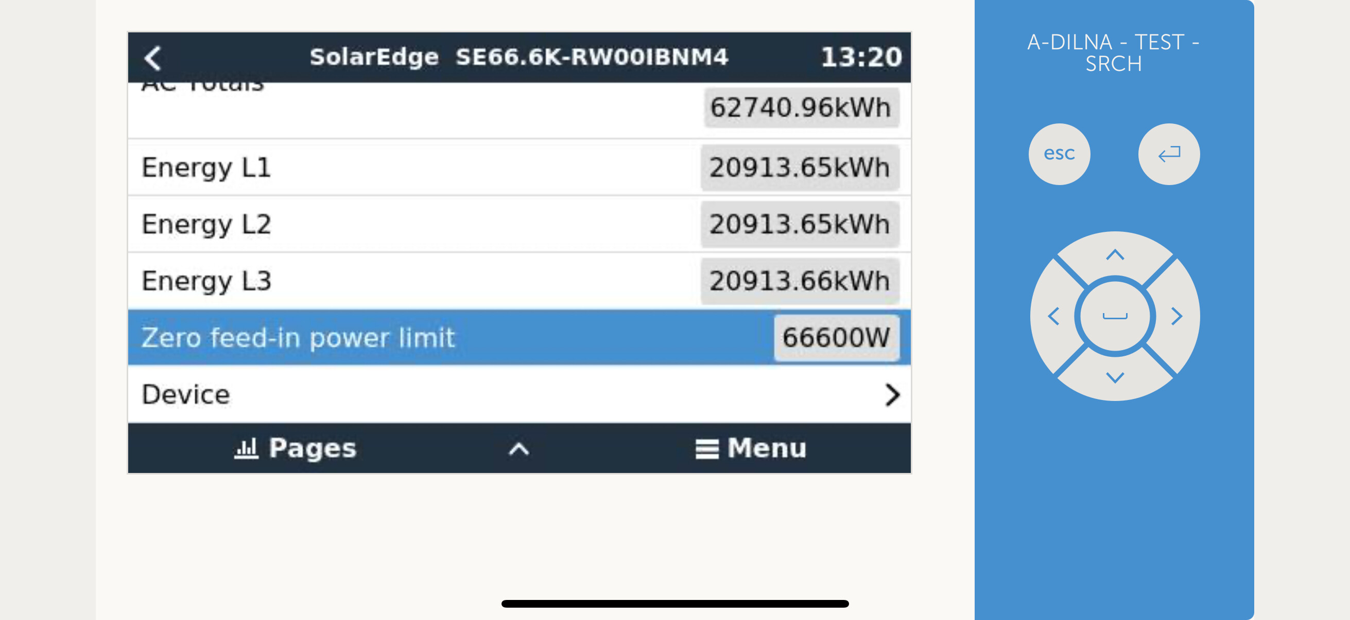

Hello, zero feed in limit is stuck and no matter what I do (ie disable ac coupled feed in or set feed in limit to 0 kW) it does not work. I think it is worth investigating.
it worked on version 3.63, but on versions 3.64 and 3.70~24 (which I have tested just out of curiosity) it does not work.

Sorry, it worked on version 3.63, but on versions 3.64 and 3.70~24 which I have tested just out of curiosity it also does not work. It is not beta specific.

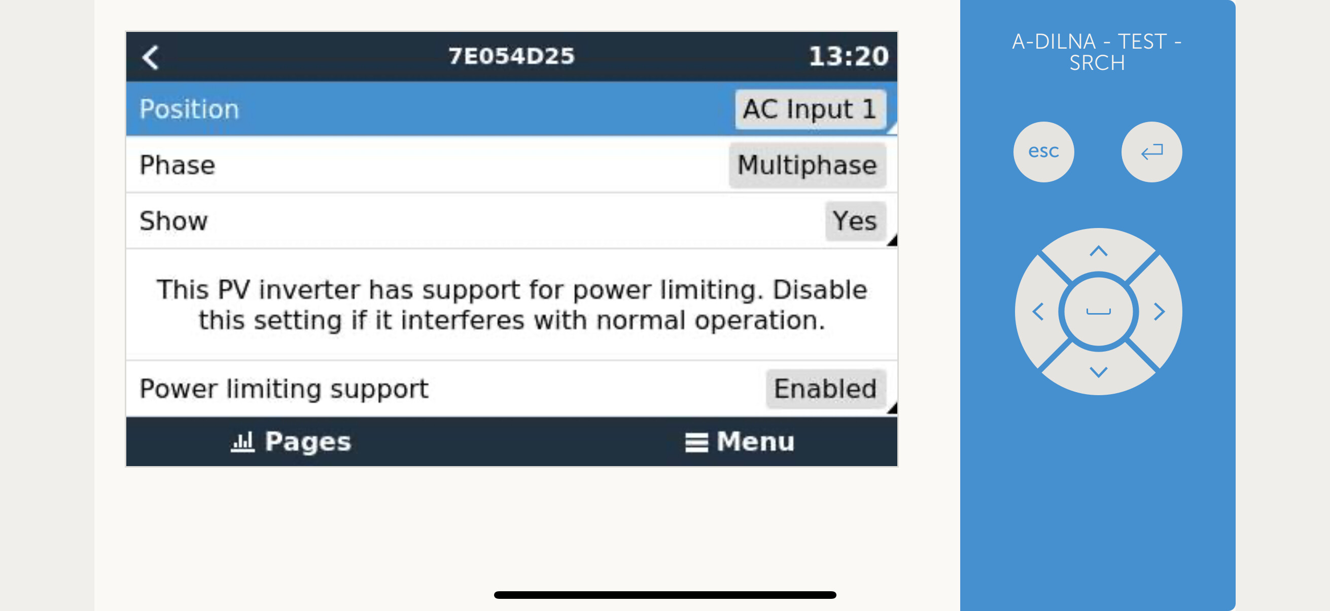

This was fixed by disabling RS485-2 channel of Solaredge which had a separate meter connected to it. Then I had to manually remove the inverter from VRM and Remote Console from Devices. Then it started working normally. Definitely an edge case thats worth investigating I think.
