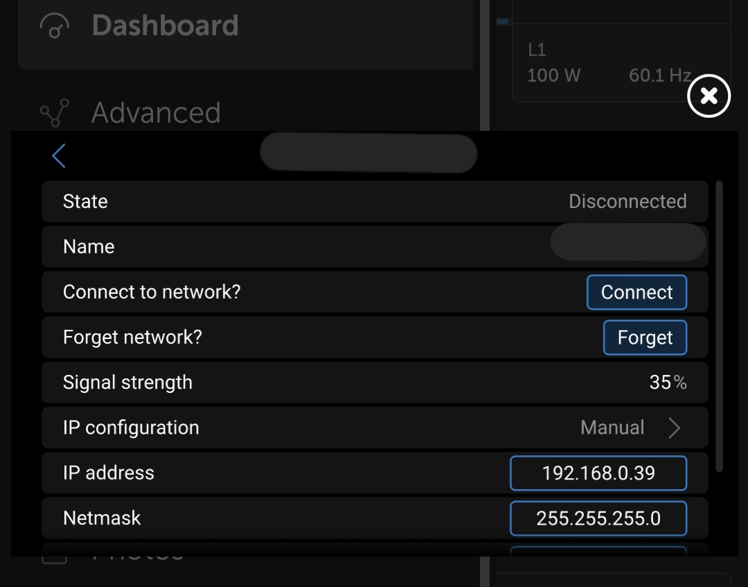

BUG: Cerbo 3.52 - Wifi network showing disconnected in remote console when connected
Good day. I’m running the latest firmware on my cerbo gx 3.52.
I’m only connected via WiFi. Most times when I go into remote console under settings>WiFi, my connected network is showing as disconnected.
This seems to be a bug as I’m obviously connected to that network to access the remote console offsite. Reboot temporarily resolves the issue. See pics below.
Thanks.
Hi @Cedar22
That 35% Signal Strength to your gateway is quite low. If you could improve on that, your ‘bug’ may become much less frequent.
Yes possibly. I just got a WiFi extender in the mail to install. But if I’m connected, the OS should show as connected. Regardless of signal.
