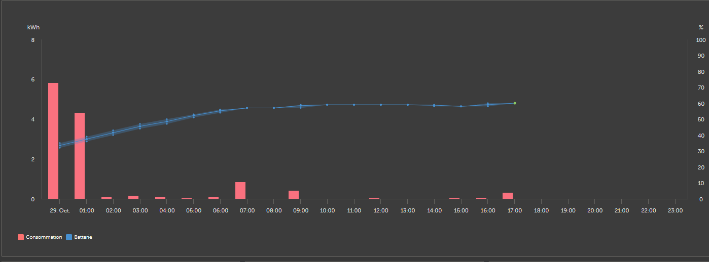

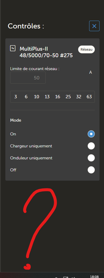

I wanted to install the latest beta version on my Multiplus 2 GX which had a cell tower (clamp).
Since then, the Multiplus has continuously charged the battery, even when there’s no sun.
I reinstalled the latest official firmware, but it still doesn’t work.
To get it working normally again, I had to reconnect my ET112 speedometer.

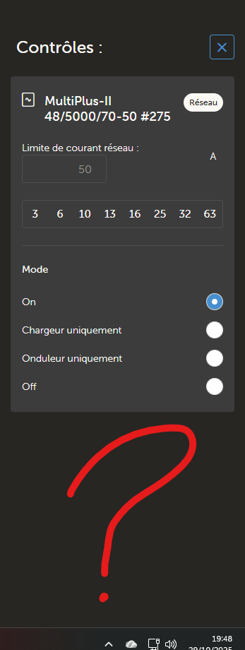

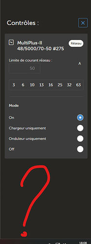

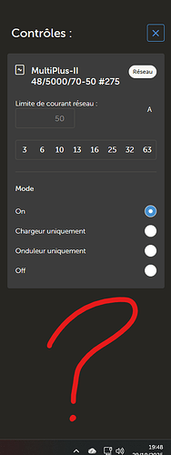

What I find surprising is that now, there are missing options here.
@Vince2 when bug reporting it is useful to mention which beta. Since future readers will not be able to tell what official os you reverted to or what beta you are testing.
Also if possible what you expect to see as your missing options. Not everyone enables the side bar controls
I went from the official version 558 to beta version 370.49, then back to the official version 558.

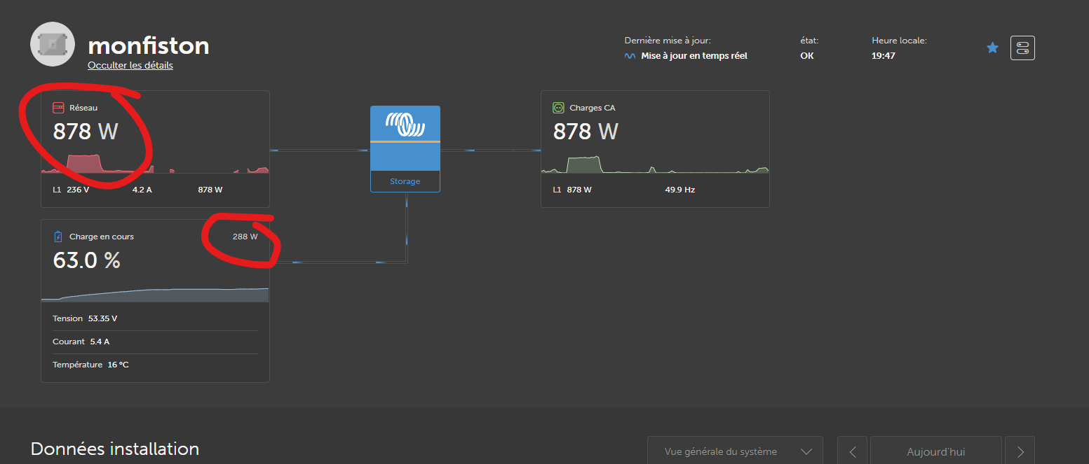

And I just noticed that the system is constantly charging the battery from the mains.
And in this section, it’s missing information about the battery, the choice of whether to optimize the battery,…
How can I return to normal operation?
