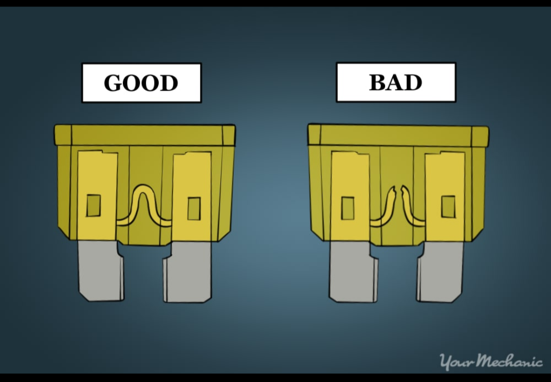

Have you checked the fuse under the cover next to the output connections?
No im on vacation and unfortunately dont have the tools to test the fuse, but is it possible that the fuse might have burned?
Flip the end cover off, pull the fuse, you can see if it’s blown or not.
