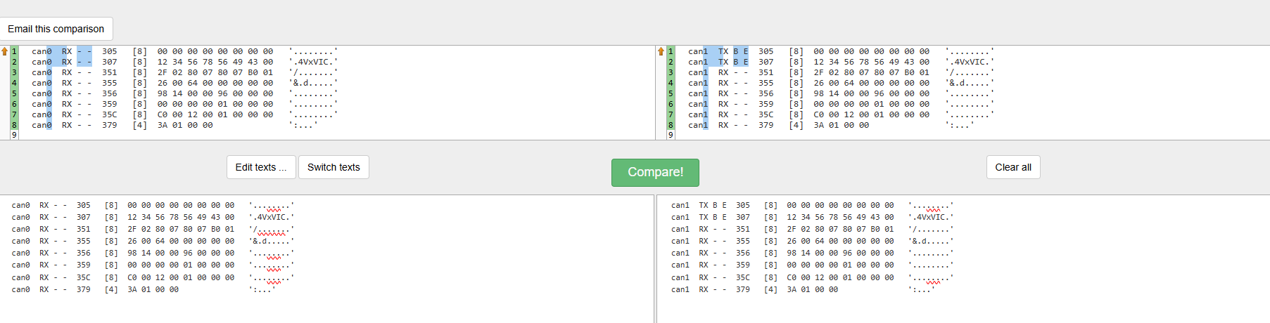

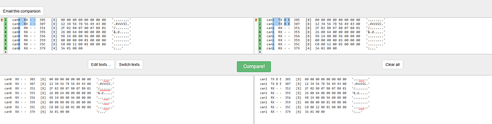

Ran the comparison, they seem to be identical. The only difference is the Can port used on the device, BMSCan on one Cerbo and the VE.Can port on the Cerbo-S
