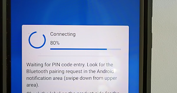

I can’t use Victron connect app (label mix-up, wrong serial number, wrong PUK, but that’s another story). So I’m using Overkill solar and it shows no charge going in.

Thanks again. Yes it has 6 terminals. Probably best if we just take it back to the dealer because they have to pull the BMS to get the right PUK off the back.

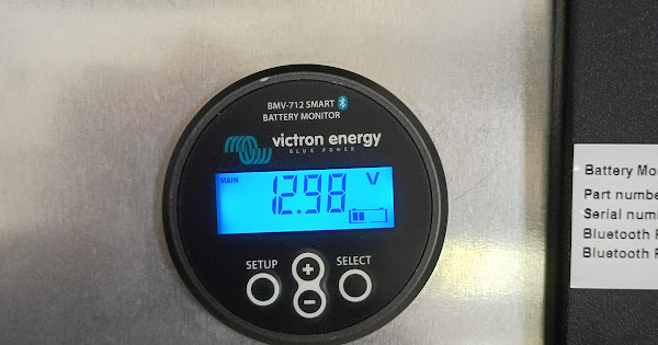

??? The MPPT has a label - this should have a pin and a PUK on it… did you confuse MPPT with BMS?
I don’t see a PUK on the MPPT . It’s the BMS that has the wrong PUK on the label that was loose in the documentation. https://photos.app.goo.gl/zUoxUZBqJLmdQD6D8
Google Photos
MPPT label is either on the top, side or back of the unit.
The BMV is NOT a BMS, the BMV is just an energy and voltage monitor, while a BMS does a whole lot more besides.
Default PIN for the MPPT is 000000 (usually).
This is what has the wrong pin and PUK:
Google Photos
I’ll look again on the MPPT.
Kudos to Thiemovanengelen for noticing my PUK problem and getting me the correct info. I now have a working app so we’re making progress.
