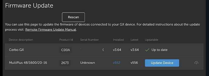

Through VRM/a GX device. Its the simplest method, remote firmware update. It will automatically select the correct firmware based on the product id. So in my example here the MP has loaded 2673552 but 2673556 would be available
You then get a remote config file through this process, open it on VEconfig, check the settings, then send it back to the unit
