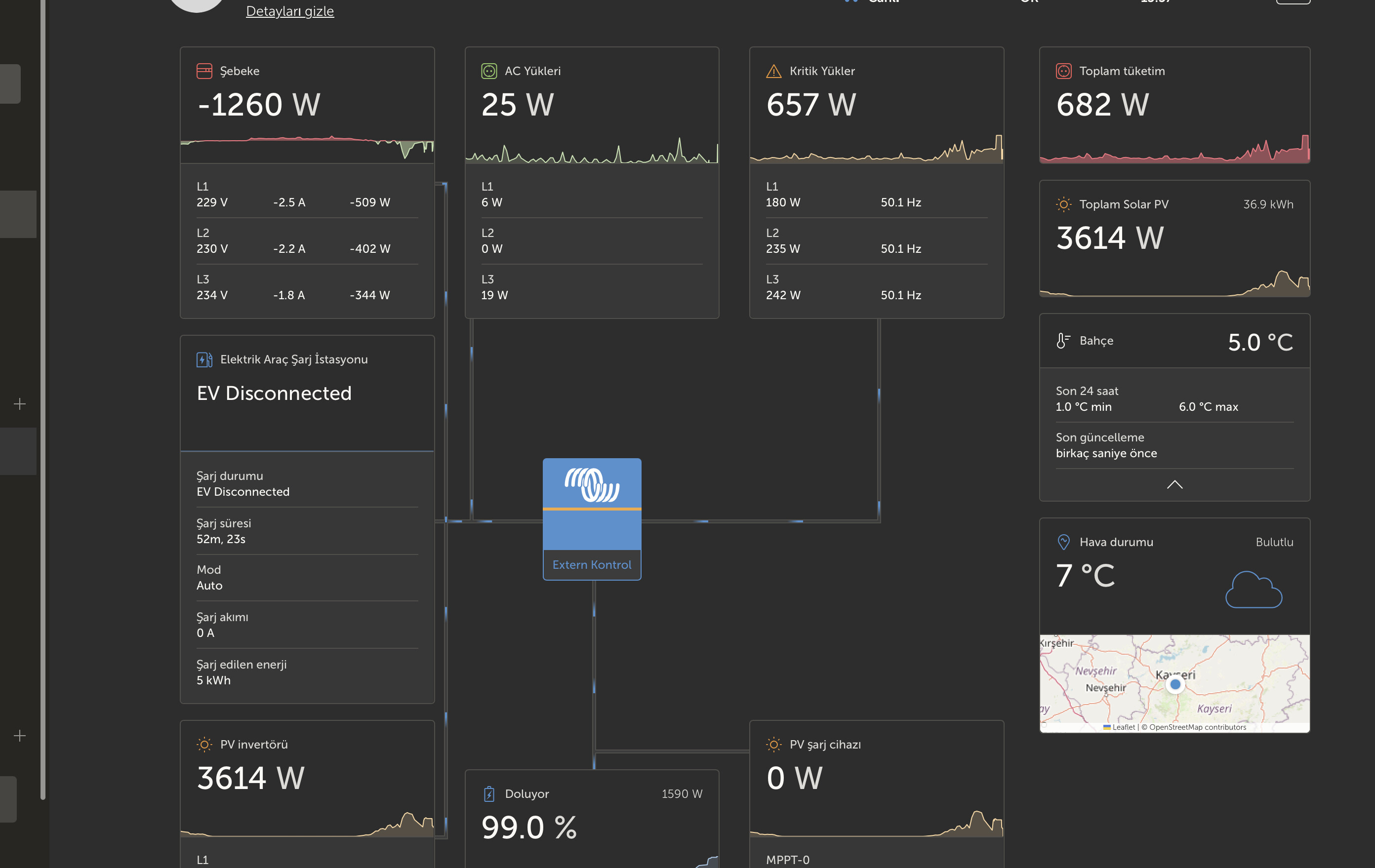

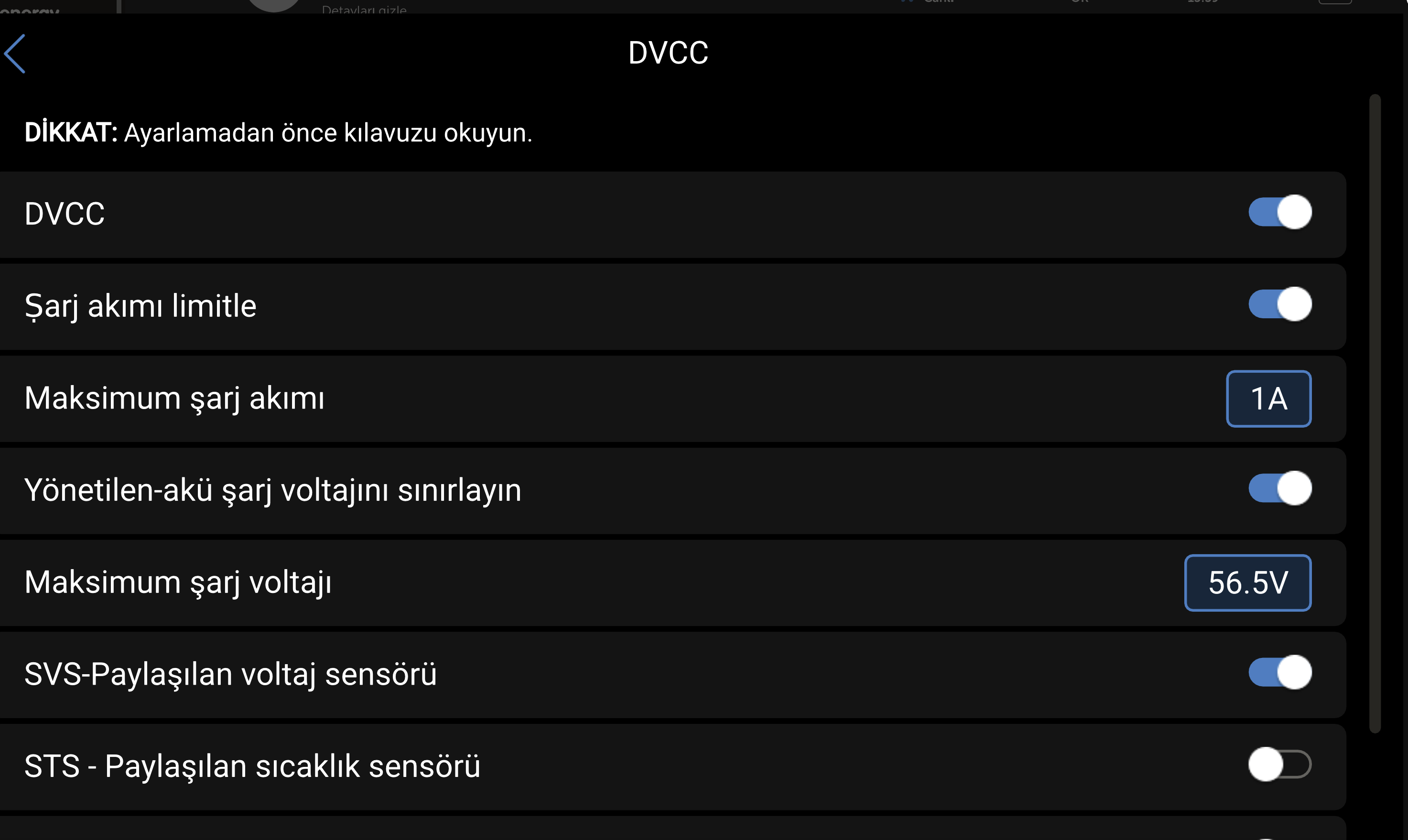

Hello, there is a bug in 3.52 and 3.53.2 or there is this bug in my system. When I open DVCC and set it to 100A, MPPTs stop producing when the battery is almost fully charged, when I set DVCC to 1a, MPPTs start producing again, both AC and DC coupling are active in ESS.
