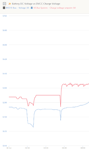

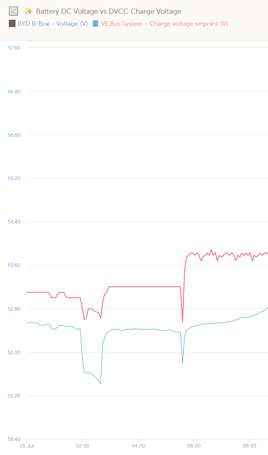

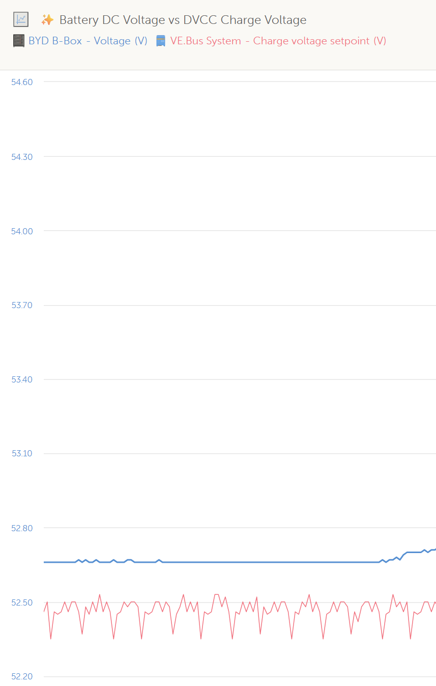

I have a funny issue appearing every now and then (1-2 times a month)
The MPPT won’t switch on in the mornings because the charge voltage is lower than the battery voltage. See a snapshot below
To get my MPPT going, I need to set the ESS mode to keep batteries charged to “trigger” the battery. once the MPPT is switched on I can go back to my previous ESS state (Optimized mode w/o BatteryLife: self consumption, SoC at or above minimum SoC)
On a normal day the charge voltage setpoint is higher than the battery voltage.

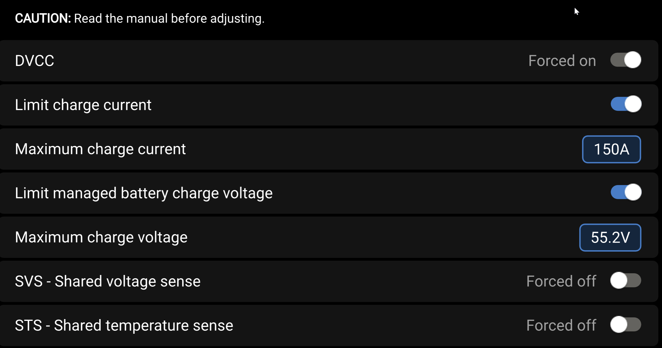

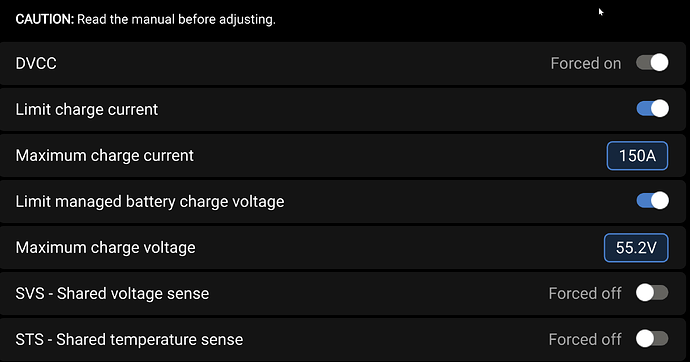

What my config looks like.

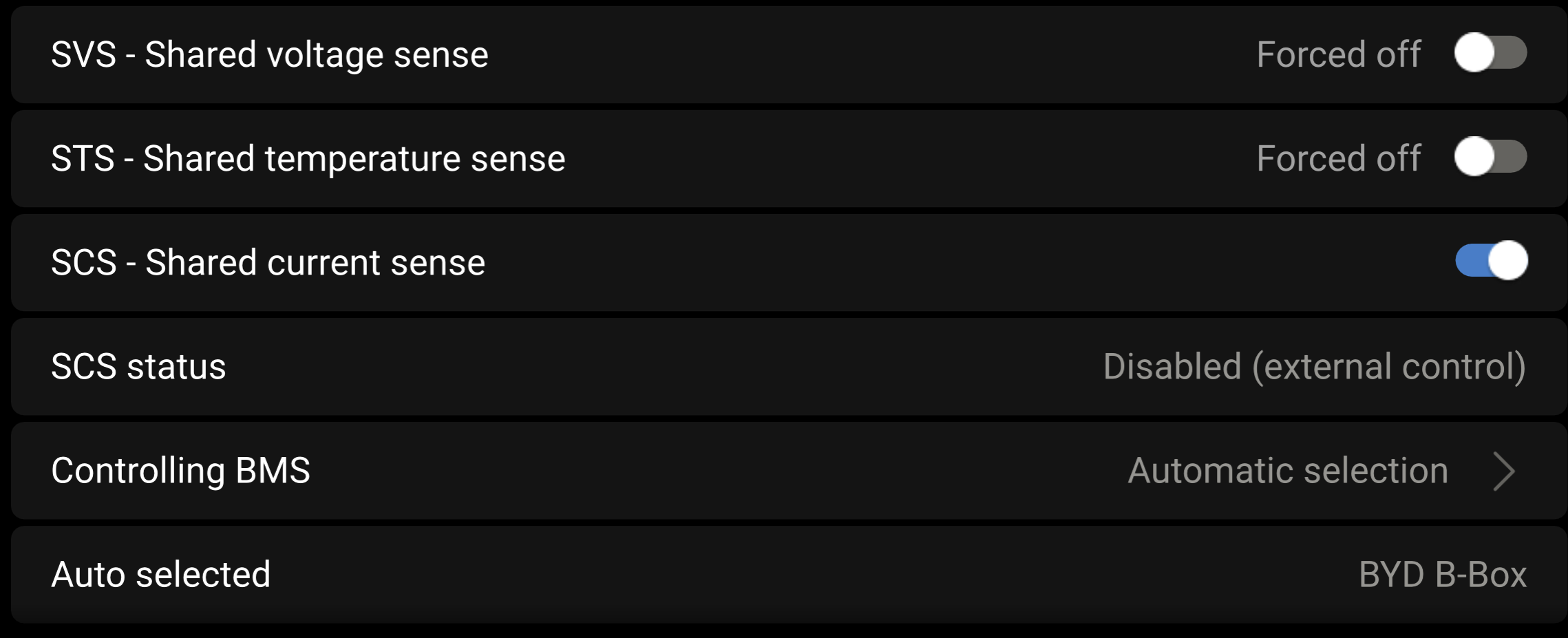

DVCC is set to the BMS on the GX and is switched on

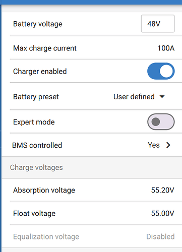

My MPPT is set to use External BMS

Disabling DVCC will most likely fix the issue, just not sure if there are major risks to doing it and if I will void my battery warranty.
in the meantime, I have a node red flow everymorning before sunrise, the ESS state is changed to plaster the issue with no real fix yet.
