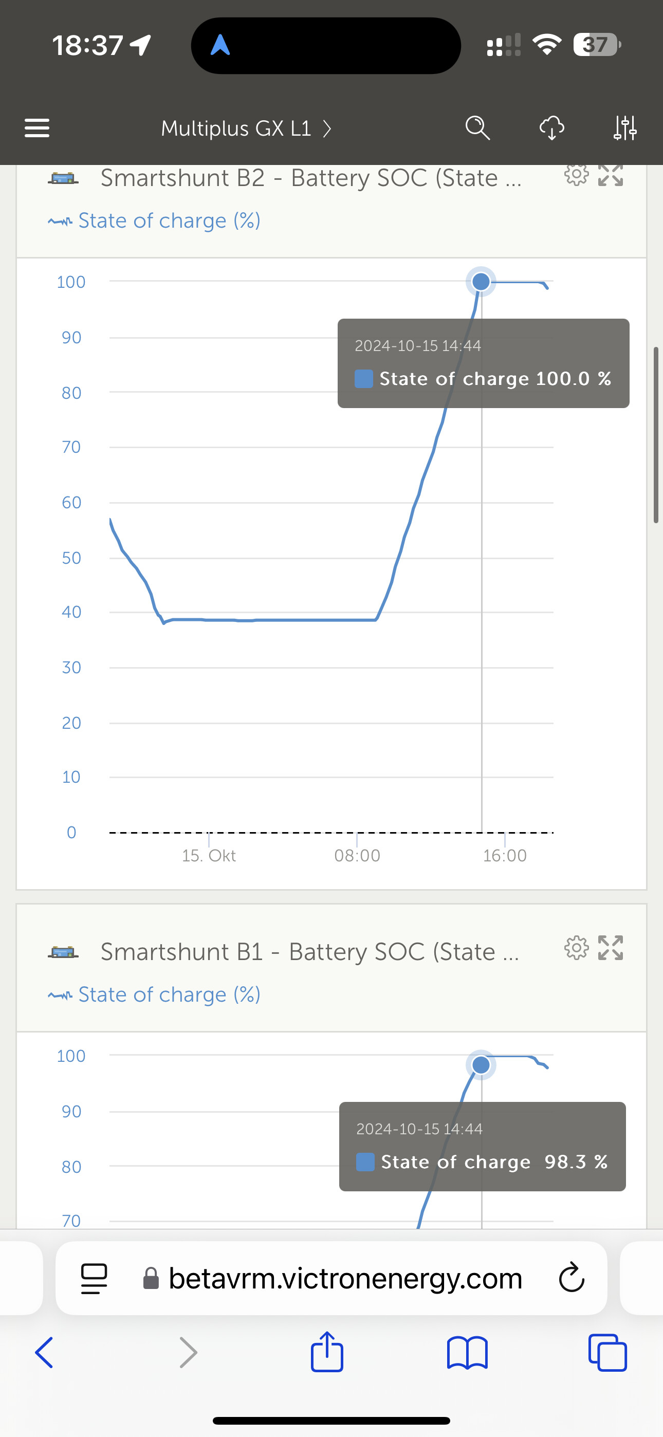

Solar is connected to the ac but there is not much solar. I added 2 more pictures because i try to figure out when it happens. It seems that on the moment the B2 accu reaches 100% it drops to 0 (fuse blows) also the connector on the fuse feels hot around 98%.
On the same moment the B1 is close to a 100% and that cable is cool.
Seems to me that there is a peek voltage or something on the moment the B2 reaches 100% in combination with the heat around the fuse (wrong or damaged cableconnector?!)
