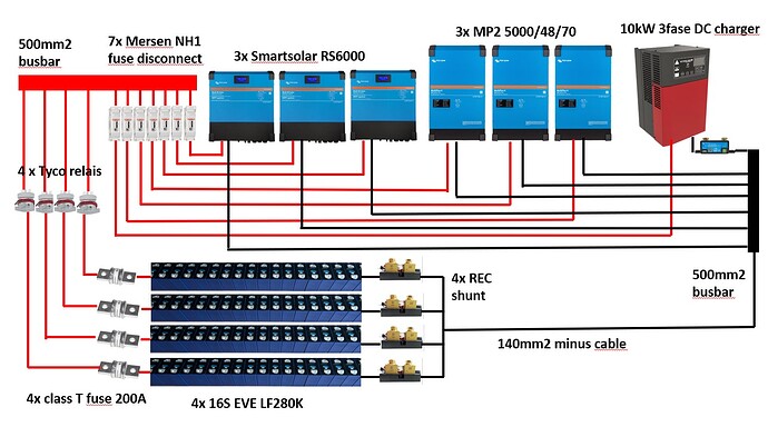

I see an interesting discussion here about fuses and so on. Could you let me know what you think of the setup below? The battery enclosure is 3 metres wide, and the positive and negative busbars are located at opposite ends of the enclosure, on the left and right.
This way, each device gets exactly 3 metres of cable, which works better than a Lynx distributor, where the positive and negative connections are combined in a single connection, resulting in different cable lengths to each device that is further away than its neighbour.
