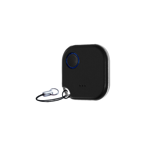

i dont know if you have given the shelly button a look already but it could maybe fit what you search. With blu to mqtt conversion from shelly it should be able to integrate it via MQTT to Victron. I dont know if the button can use the bluetooth from the cerbo as a gateway but i suspect not. So combining it with another (or multiple) shelly bluetooth products as a gateway could give you better coverage where to use the button.

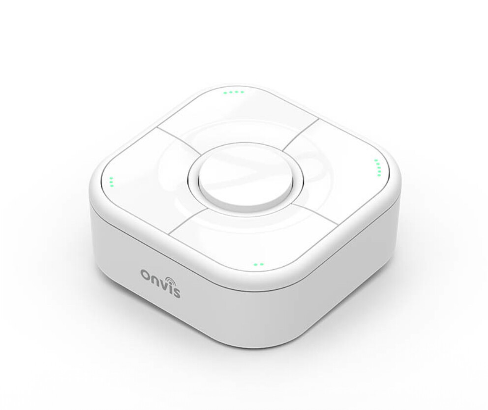

Here is a button I found:
Note that I don’t know yet how reliable all that is, but its definitively the first avenue that I recommend to look into.

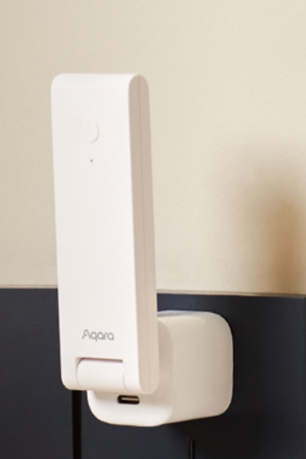

And be aware that you need one additonal hardware product that is a so called “thread border router”. I did a quick search, and this one looks nice. Just needs power, conveniently provided from USB-A instead of typical AC plug, so its easy to install in a DC oriented install like a camper van:
