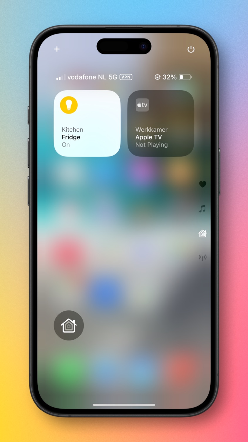

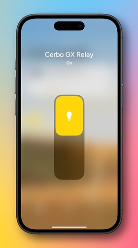

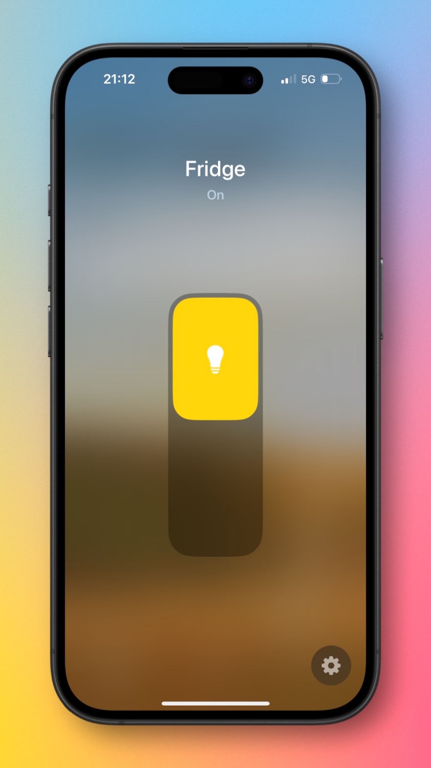

And success! I can now control the relay of my GX straight from my iPhone home screen.
No specific apps needed, nothing technical. Rest of the family can use it as well. And no need for them to get into understanding Remote Console or anything like that.

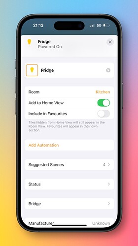

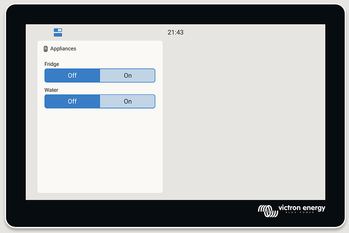

Here are various iPhone screenshots:

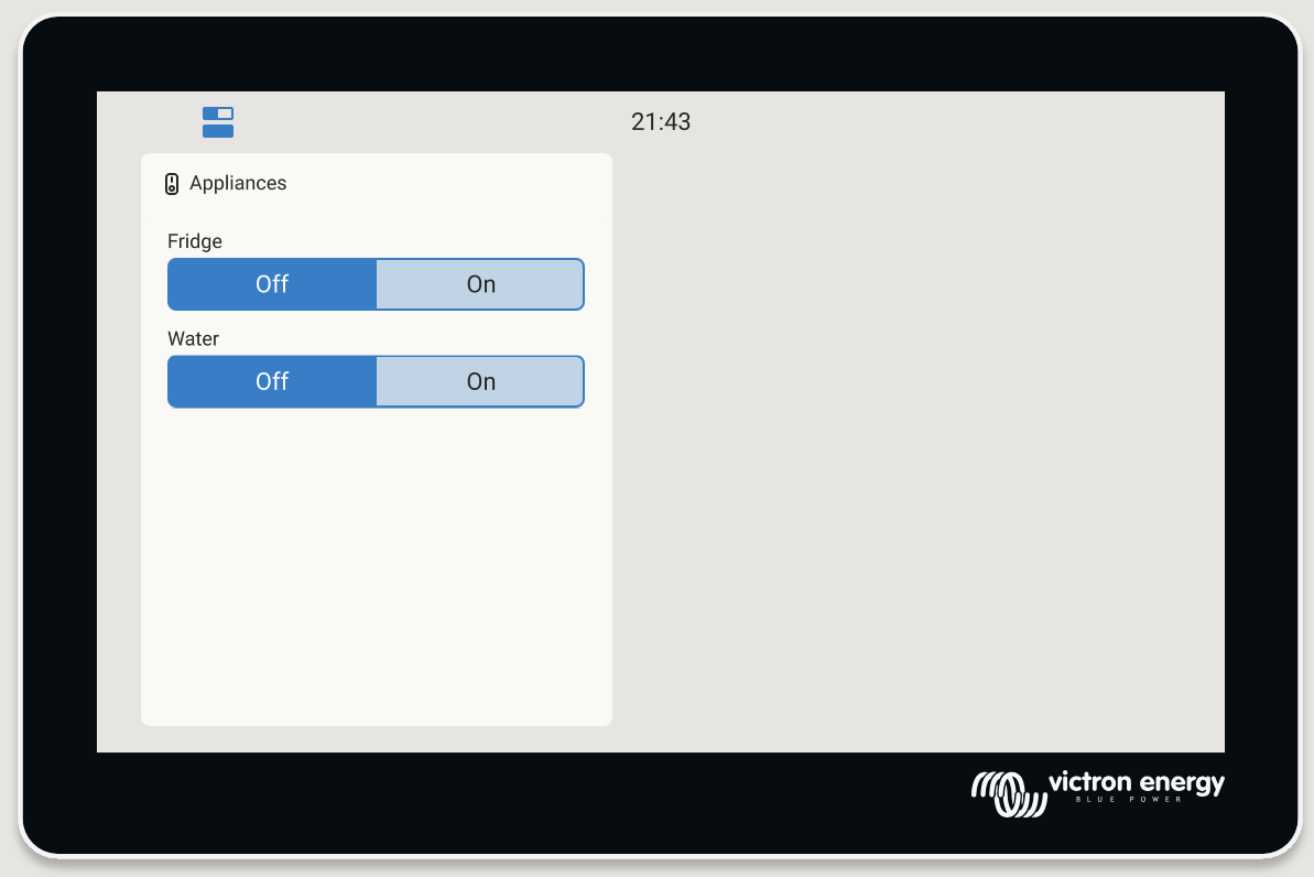

Same control, but now shown on the GX Switch Pane:

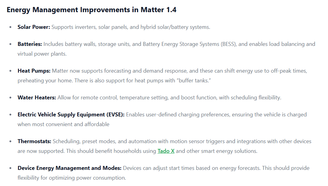

Finally I’ve looked into the question whether Matter supports anything related to Victron type products, and the Matter standard does.
Here is what has been added to the standard at the end of 2024:
(source: Matter 1.4 Is Here, But What Does It Add to Your Smart Home? | Matter Alpha)
It typically takes between 6-12 months for the primary App creators to implement the new version of Matter into their apps, which means these features are not available right away.
