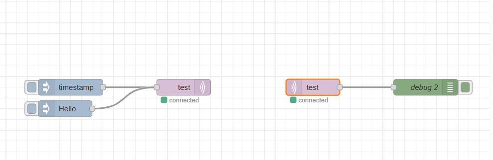

Hi folks,
Trying to use Node-Red (complete beginner) I can connect to MQTT Explorer & it shows all my system via the online server - mqtt13.victronenergy.com - All connections go green.
Issue is I have done a basic flow to inject say a timestamp but I cannot get it to receive into the debug. It says “successfully injected: timestamp” but I never see anything in debug.
Is this actually something that should work this way?
OK, thought I would try a free broker, used HiveMQ & data passes just fine, I can talk back through MQTTX so what the heck am I doing wrong or am I still expecting it to work when it actually isn’t designed to do what I think it can do, is the Victron MQTT locked in any way?

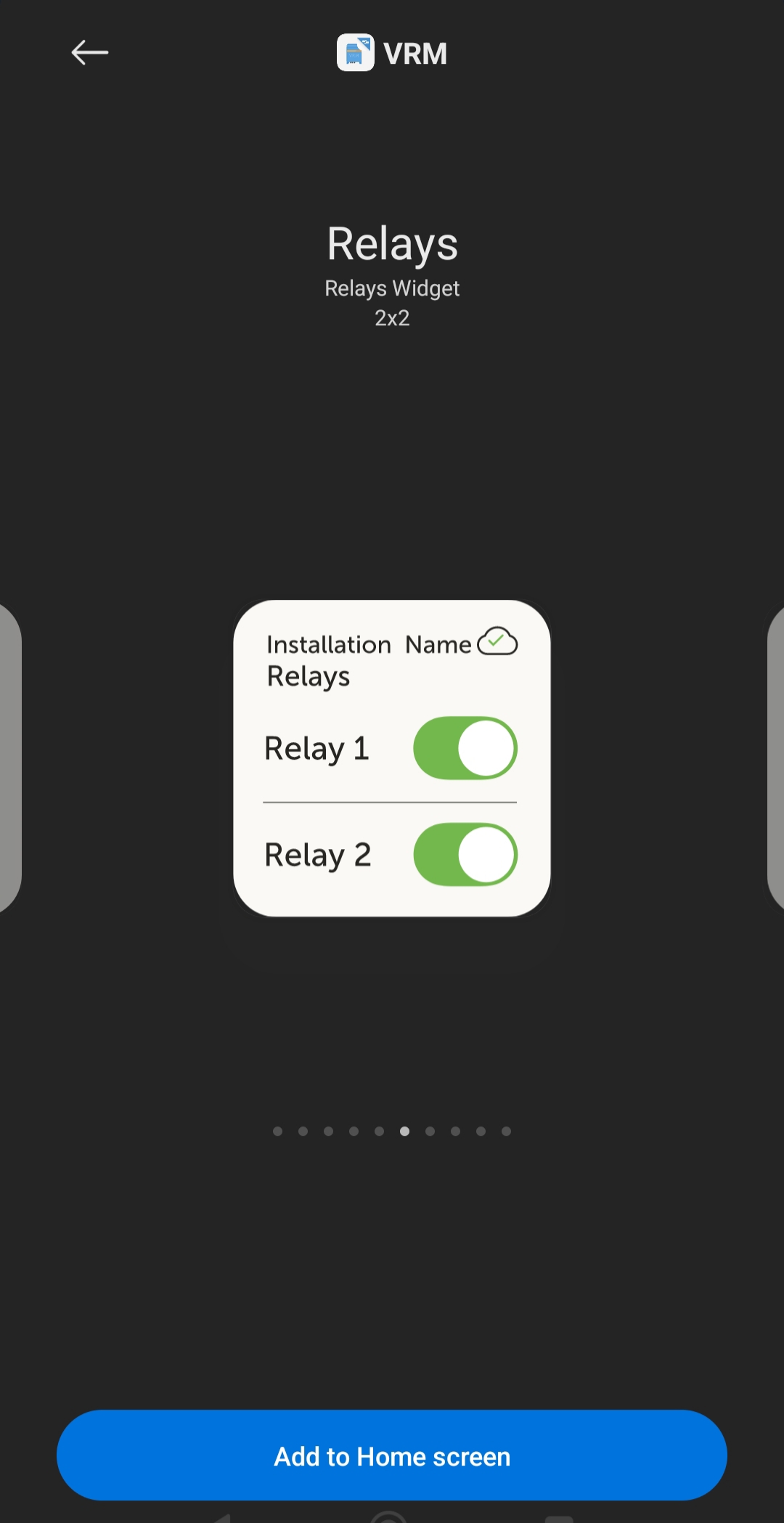

For something like that an idea for now.
Use node red to (on the cerbo) trigger a sequence of events based on relay states. Then it can be switched on through the vrm or the widget for the app.
This widget
As an afterthought i have a sequence set up for camera motion detection, it does auto switch on a set of lights without intervention from me. I just need to check and switch lights off if it’s nothing serious.
It might be possible with yours.
