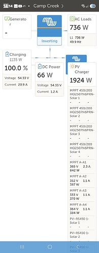

Wierd display of VRM devices
Update - this has been rectified now.
The online version of VRM had the previously name MPPT 450/200 still there….
I deleted them all except for the current named MPPT 450/2200 and my VRM app now only displays the 4 trackers as it should.
My VRM is displaying the PV charger wierdly in the following way as shown in the screenshot
It displays the 4 trackers in triplicate with prior names that each tracker had previously before renaming them.
How is this rectified?
