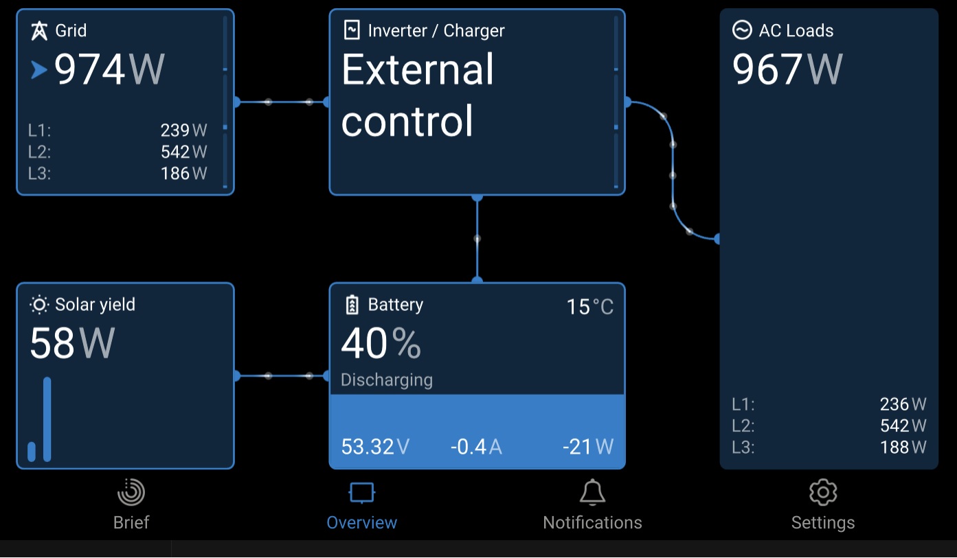

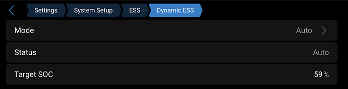

The DESS is requesting 59% SOC, batteries are 40% but there is NO charging going on.
DESS keeps forecasting “X KWH grid to battery”, for example 5KWH but it does not happen..
If I move minimum SOC higher than current SOC, charging starts mediately.
If I choose “Keep batteries charged”, charging starts mediately.
There should be no limits in DESS keeping if from charging.
